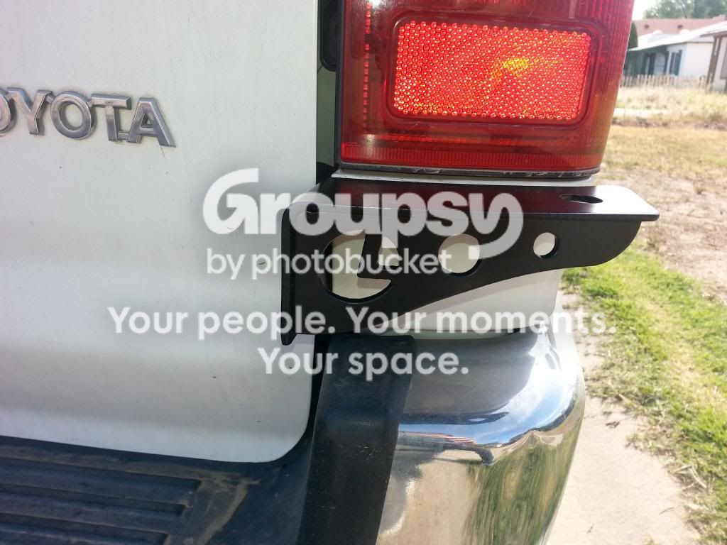

I picked up some CB components. What more do I need?
- antenna spring
- 90 degree adapter to come off the back of the radio
- SWR meter
- add a fuse or some other way to tap into a power source
- wire to run power and ground to radio
Hard to tell if that connector is bad or not. If you have a high SWR reading, a multimeter will help you determine if the connector is causing the problem.
