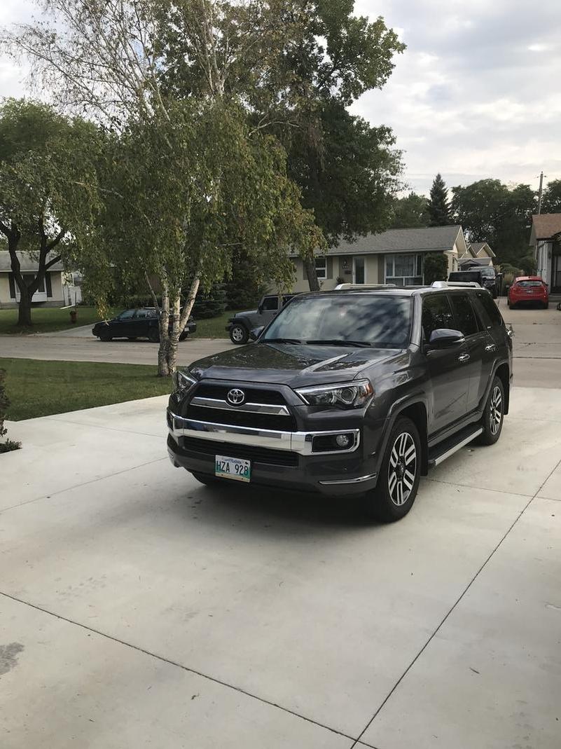

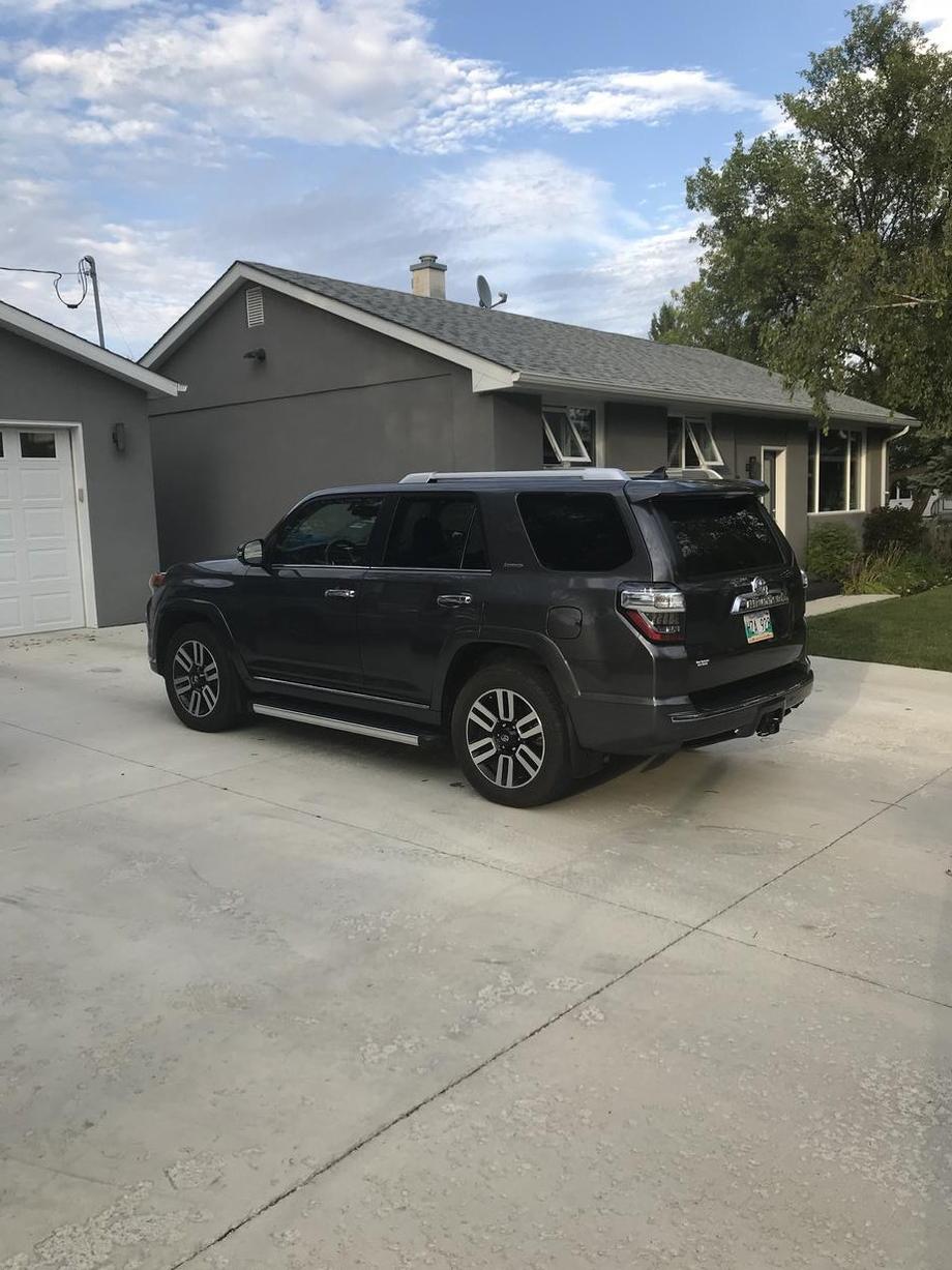

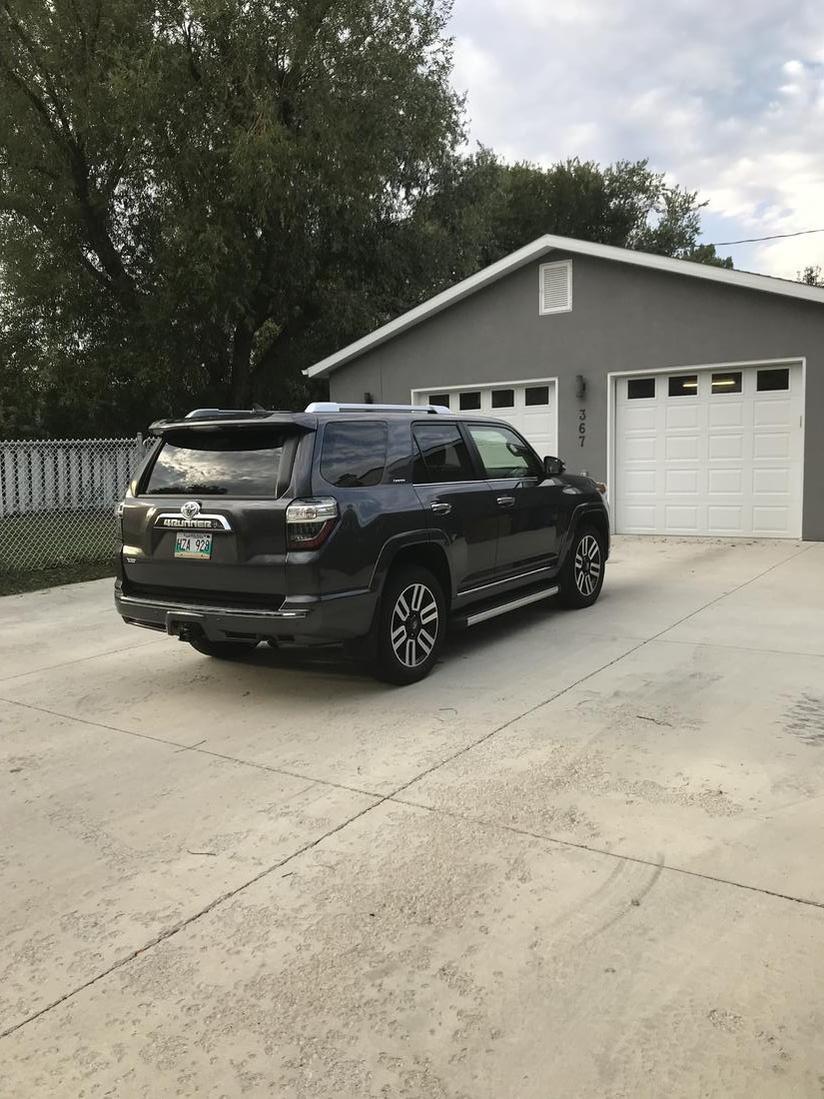

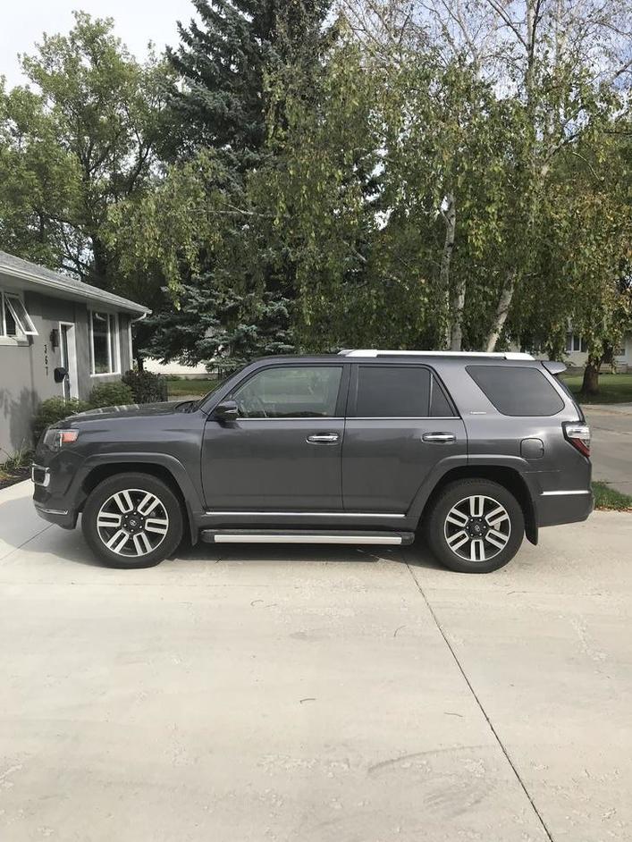

I used to be pretty active on here when I had my '96 Hilux Surf SSR-G, but since then I've had a couple of HDJ81 Land Cruisers and a GX470, so while still checking in from time to time I had no real reason to be on here much.
Last weekend we picked up a '15 4Runner Ltd. in Magnetic Gray and we're loving it so far! I've spent HOURS reading and researching on the forum over the past week, it's so nice to have a good technical forum available, FB Groups SUCK for searching for info!
This will be the wife's DD, no offroading duty, I have my Land Cruiser for that kind of stuff, so mods will be with improved city/hwy use in mind.
I'll be adding a 1" cornfed front leveling kit, 255/75/17 Duratracs on FJ Cruiser 8-hole wheels, and a Xenon Depot low beam HID kit to start. Some sort of rear cargo protection to keep my dog's fur out of the carpet, leaning towards the Canvasback setup so far, but looking for recommendations on other options I should check out in the meantime.
It's good to be back, this was always one of my favorite forums back in the day, hoping the 5th gen guys are a great group like the 3rd genners were back in the day! Long live the roll down rear window!

Those running boards may look funny once the wheels are on?
Congrats on your Ltd!
Not the most fun idea but I won't drive anymore without a 2-CH dash cam.
Ya, those running boards are something else! I'll keep my eyes open for other trim side steps and may swap them out for something less...clearance limiting down the road.

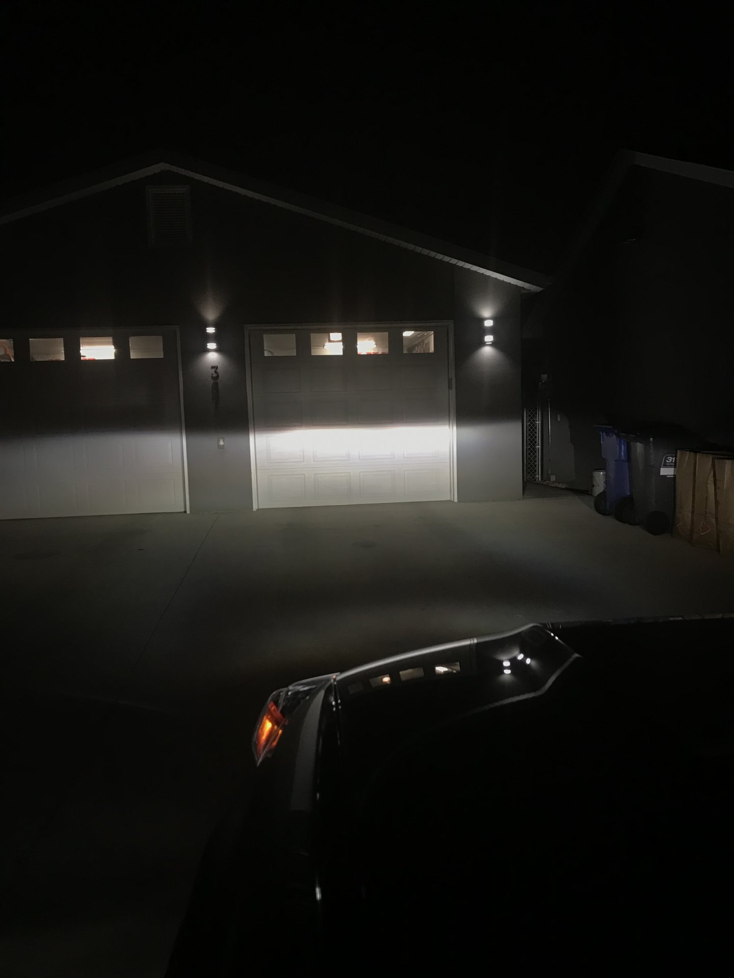

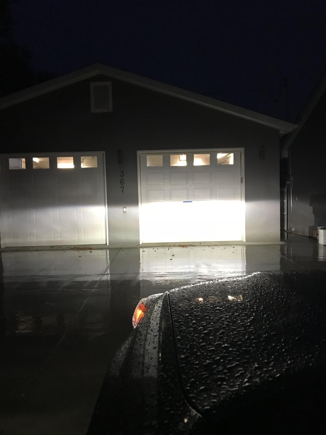

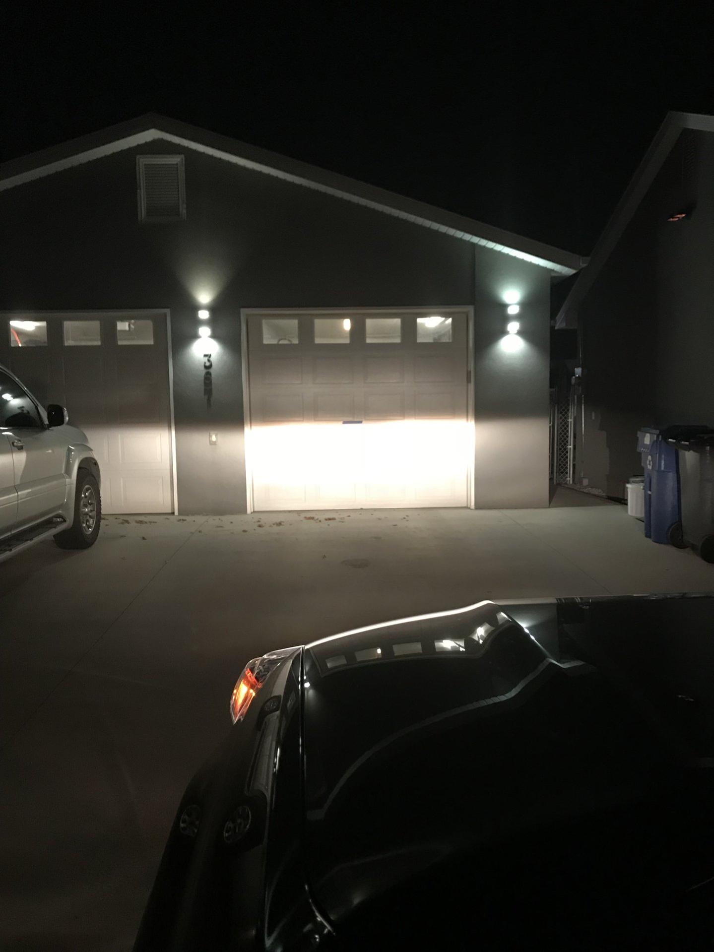

1st mod! Installed a Xenon Depot Xtreme HID low beam kit w/ Phillips 4300K bulbs last night. Found a couple good videos beforehand which allowed things to progress pretty smoothly, and the results are a huge improvement over the sad stock lighting.
Here's a couple before/after pics shining against my garage, the after is in the rain and I noticed later the exterior lights were off, I don't feel the pic tells the whole story, the light output is much brighter, whiter, but the biggest change is the side fill outside of the hotspot, makes for much better useable light when driving. I had expected to have to aim them down from other reviews, but mine were at the same height on the door after the install.
I had this same kit in my GX470 low beams, and it didn't disappoint this time around either.

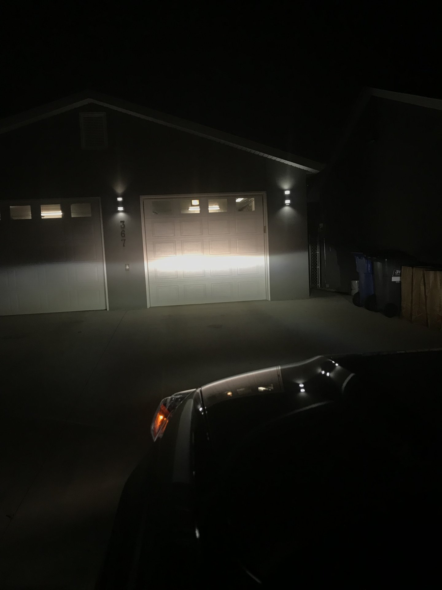

Got some Wagner 9011 HIR1 bulbs for the highbeams. I've used the 9011 bulbs years ago in a Subaru Legacy high beams and was very impressed with the results. They performed well in this application as well.
Here's a shot of just the HID low beams, and another with the 9011 in the driver's side, and stock high beam on the passenger. Out on the road they light up anything reflective for 3X further than the stock high beams, and the fill is much improved.
I hit a deer this weekend in my GX470, which also has excellent headlights (same HID kit in the low beams, low/high factory projectors), and it really drove home how important good lighting is when you're driving in rural areas at night. I had time to slow, but there was nothing I could do to prevent hitting it, just a matter of where it hit me kind of thing, came out of the ditch at a full run and would have hit the side of me if I hadn't slowed, and ended up taking it in the driver's corner of the front bumper, wrecked a lot of sheetmetal. Needs a bumper, bumper support, grille, hood, at least one headlight, foglight, fender, fender flare, likely some fender skirting, and driver's mirror, airbags didn't deploy, and it's potentially going to be a total loss when I take it in for an estimate. My 1st deer in 23 years of driving.

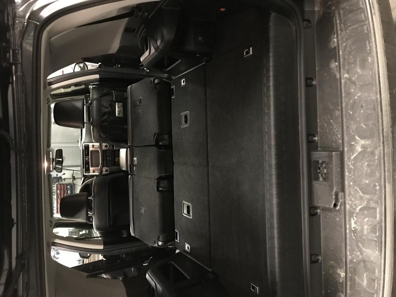

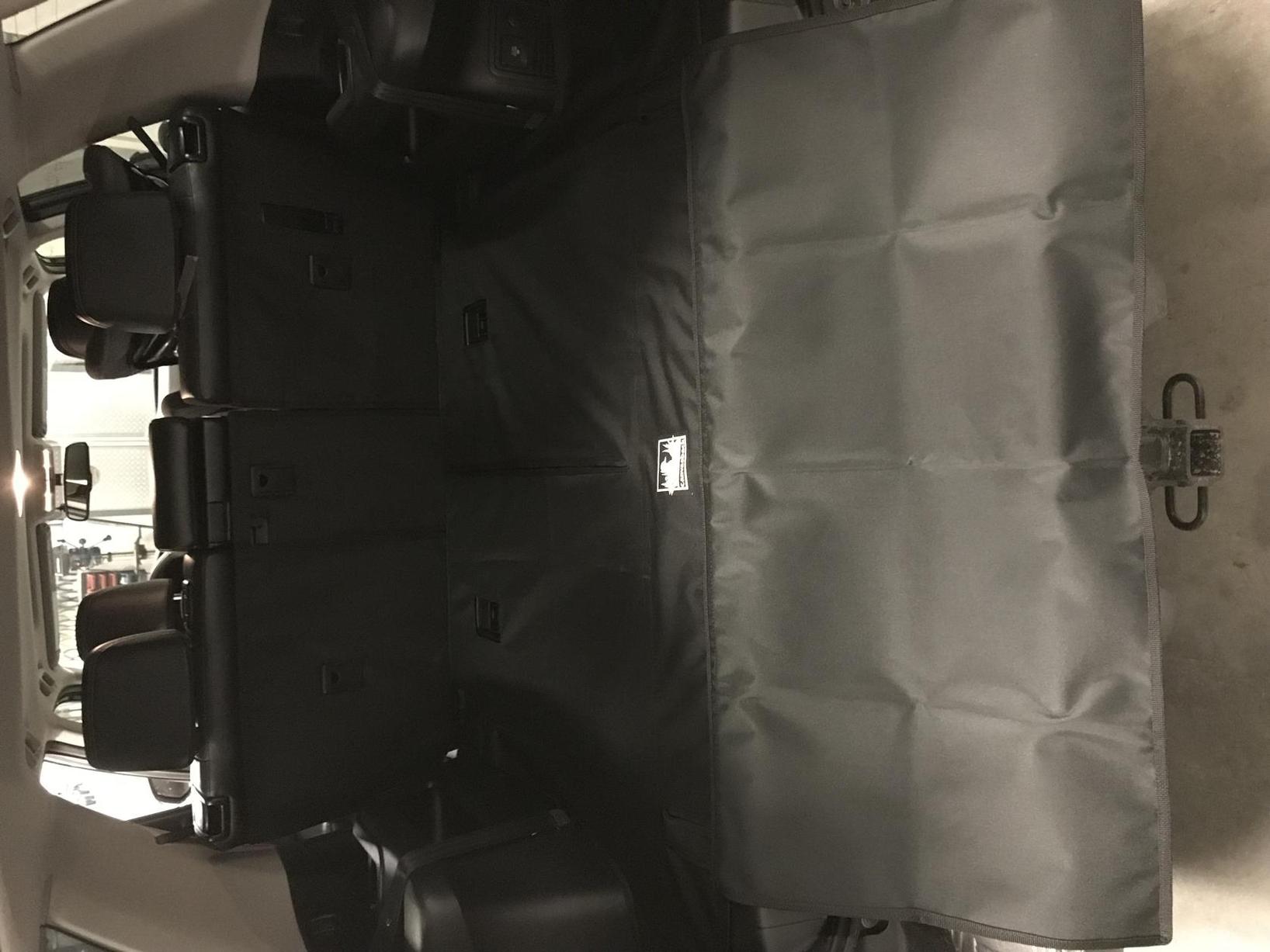

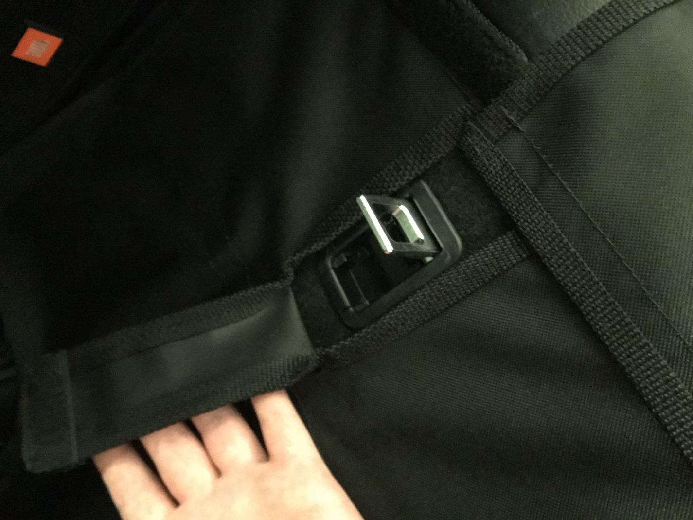

Installed the Canvasback cargo liner tonight. I've always had Weathertech cargo liners in other vehicles, but the 3rd row seats would require it be removed to use them, and the wife didn't like that. Looked around at all the options, and settled on this solution as it velcro's down tight to the carpet so it shouldn't allow dog hair to get underneath, and my dog sheds like it's going out of style. Also allows the 3rd row seats to be used without messing with anything else.
This isn't the vehicle that will see anything real messy in the back for the foreseeable future, my only concern is that the canvas will be slippery and the dog's bed will be sliding around back there. I ordered it with the 20" tailgate flap to cover the bumper and protect it from dog nails, and custom flaps so the tie down points are still accessible. Install went smoothly, and I think it's going to work well.

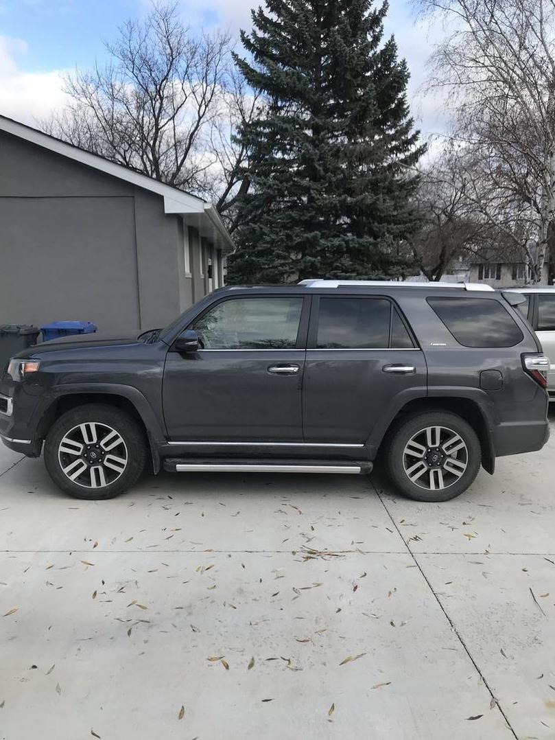

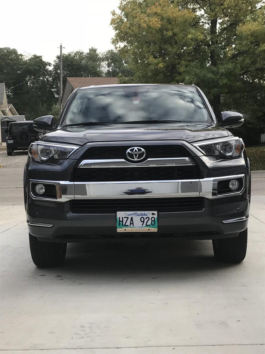

Well, it wasn't easy with a broken rib, but I managed to get the Cornfed 1" spacer installed on the front yesterday. Laying on the creeper really sucks, as well as all the up and down off the floor to grab tools and such. Enough complaining, on to the pics.
It goes in for new tires, some 255/75/17SL Duratracs, and an alignment on Tuesday of this week, so I wanted to get the spacer installed to save another trip back for the alignment. I would have loved to do the tires 1st and see if there was any rubbing, but it just didn't work out.
Measured before and after, and gained a full inch in front after things settled, maybe 1.25" even. Install went pretty smoothly, XREAS lines could have been another inch longer though.

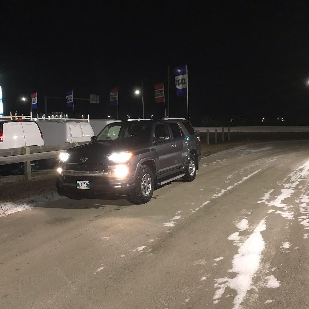

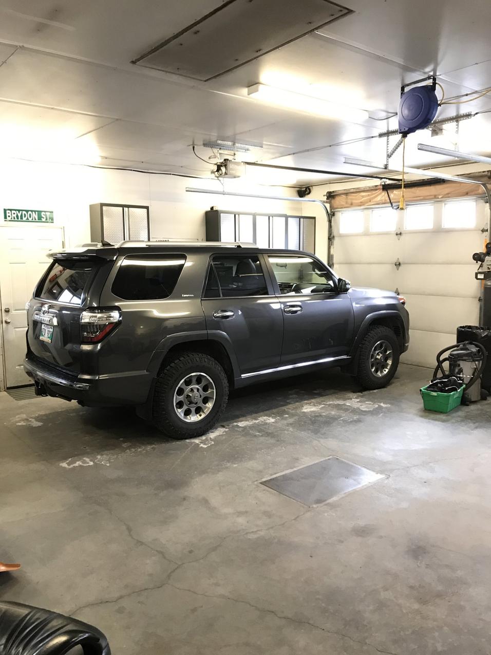

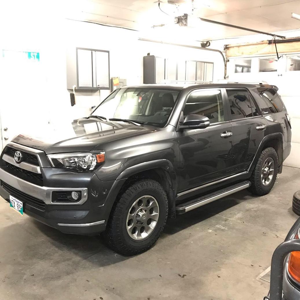

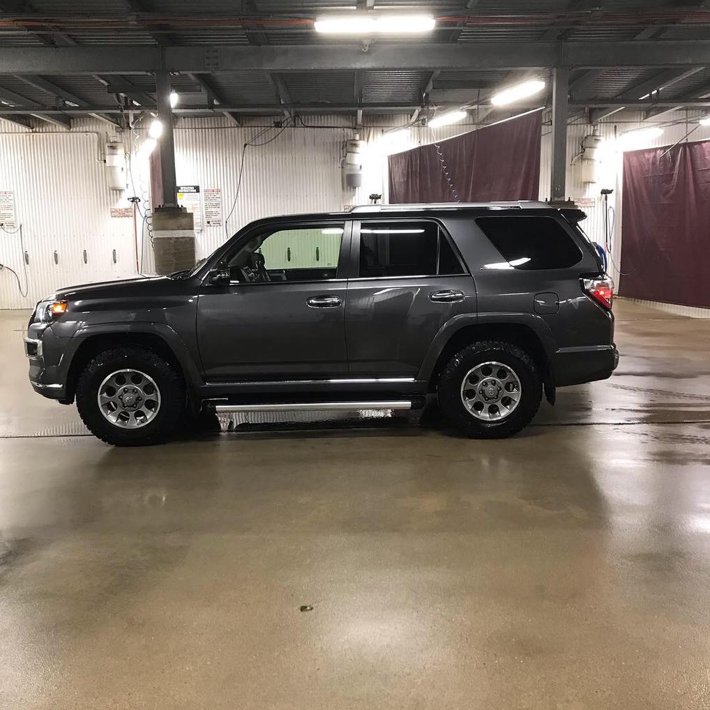

New shoes day! Ditched the ugly 20's, mounted 255/75/17 Duratracs on FJ Cruiser 8-holes that I'd been running on my GX470, MUCH better!
I'd have loved to get these on before the 1" front spacer lift to see if there was any rubbing, but it just didn't make sense logistically.
I've put a few miles on them, the ride is less firm with the extra sidewall, should be more comfortable. It feels more like a truck with the front levelled and the taller tires, maybe a bit slower off the line due to taller gearing, but once rolling these should be lighter than the 20's and it moves just fine.
These 5th gen fenders really swallow wheels worse than the GX470, I'm going to take some measurements tonight and will likely track down some 1.25" or 1.5" wheel spacers to push them out to the edges better.
