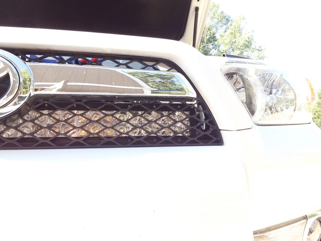

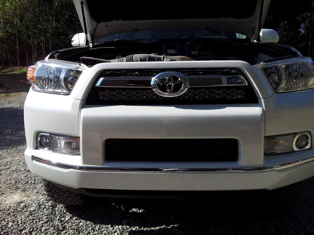

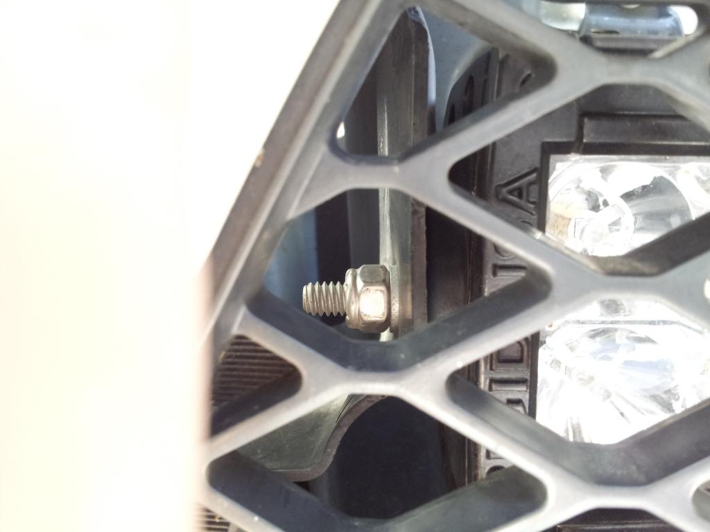

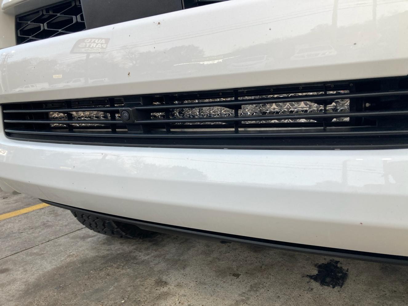

i miss my 20 inch light bar in my upper grill, they were great FU lights lol...
In my 2012 i put a dual row Rigid in behind the grille hooked to high beams.
I uninstalled it and just put it in the new one behind the lower bumper insert also on high beams.
It is absolutely so awesome.
The 30" Rigid is so easy to mount in the older 5th gen, pull the grille and you'll see the plastic piece to direct air from the grille into the radiator is the exact same width as the 30" light bar. All i had to do was drill two holes for the bolts in the light bar and tighten down the nuts.
The new 5th gen i mounted it to the aluminum crash bar with standard light bar tabs. It makes high beams reach out farther than your eyes can see, its so nice. We live way out in the country and its nice to be able to see a half mile of road lit up.
