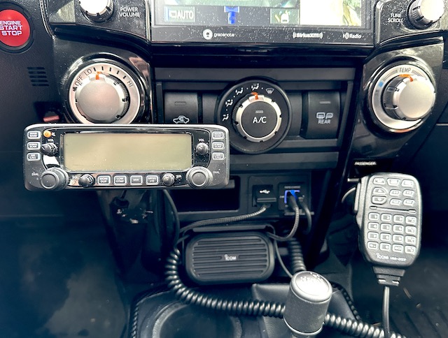

The project this past weekend was to do some radio swaps. The Midland GMRS MTX575 came out of the 4Runner and went into my son’s Jeep JKU.
I installed the Icom 2730a into the 4Runner and it works excellent. I used the mount I installed for the Midland mic, but with the Icom magnetic bracket to mount the radio display. It’s an ideal position, does not interfere with any vehicle controls, and falls to hand nicely.
The mic is plugged into the main radio unit under the drivers seat, using an Ethernet extension cord.
The Icom external speaker is well positioned in the lower dash cubby, with the bracket attached via strong Velcro.
I need to clean up the interior, but here’s a shot.

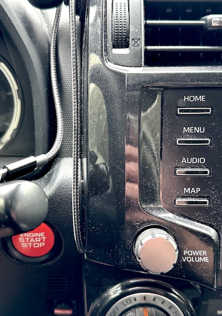

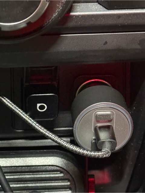

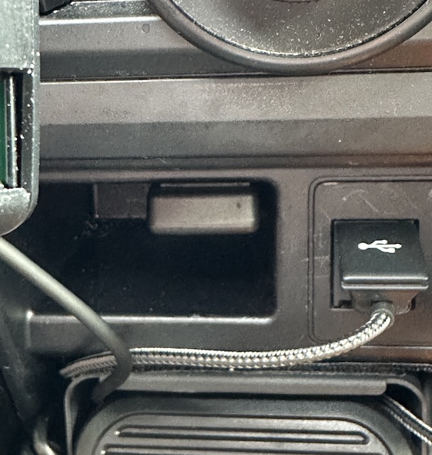

I cleaned up the radio & phone cords a bit. Drilled holes behind the upper & lower cubby holes in the lower console. Ran the Icom & Apple CarPlay cords through the lower cubby to behind the dash. Routed the CarPlay cord to come out to the left and just below the radio, to eliminate the cord being draped in front of the dash. I used a braided Anker cord for durability.
I decided to the Mob Armor mount for the Icom mic, which makes it even more convenient.
Also remounted the Wilson WeBoost cell booster interior antenna to the upper cubby area, attached with 3M tape. (last photo).
This all helps clean up the appearance of the dash.

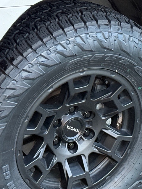

With virtually all my driving being on highways and dirt/grave, and no plans for serious off-roading, I decided to swap the tires. While the BFG K02 is undeniably a strong, durable tire, I’ve also found it hard riding and lacking wet weather grip.
I went with the new Nitto Terra Grappler G3 and this has been an outstanding choice so far. I’ve experienced less noise, more compliant ride & handling, and significantly better wet weather traction. They still look aggressive too. We did the same swap on my son’s Jeep JK and experienced the same results.
When making the swap I also removed the TRD center caps and installed some that originally came on the Tundra special edition. The silver TOYOTA part nicely matches the silver letters on the TRD Pro heritage grille.

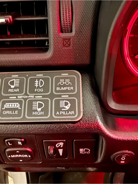

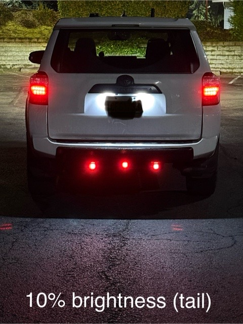

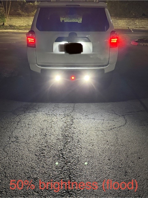

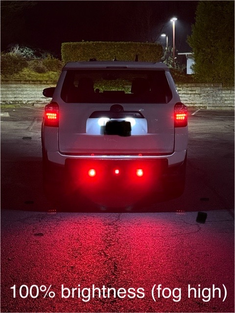

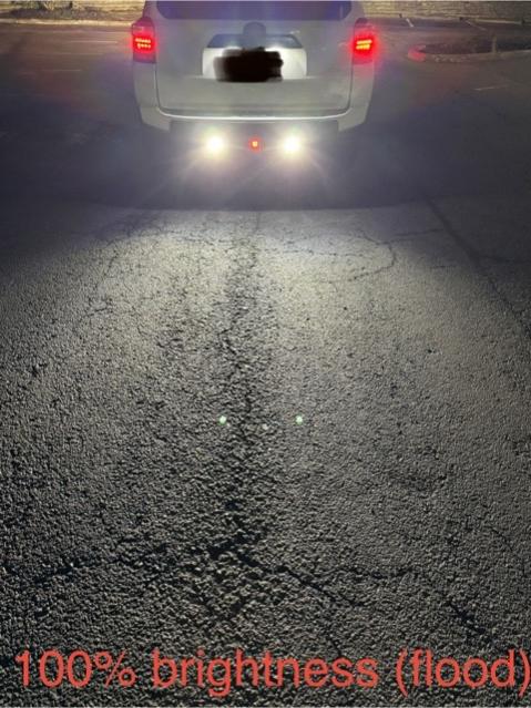

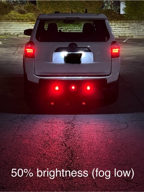

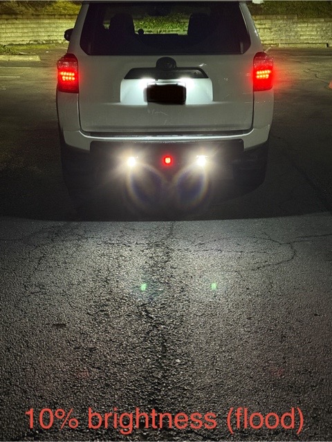

I never used the Dr. KDSS module, so I removed it and this opened up a spot on my SwitchPros controller. I decided rear fog lamps would be useful in the mixed weather we get in the PNW.
I’ve been running the Diode Dynamics hitch mounted tail/brake/reverse pod light for a couple years now and love it. With that said, I contacted Diode Dynamics and discussed options. I decided on using the same C1R modules because they are compact and would provide the desired output, while remaining compact and unobtrusive. These pods have tail/brake and reverse capability, but I didn’t want the extra tail lights. Since I’ve already significantly upgraded reverse lighting, that wasn’t needed either. Diode Dynamics assured me these pods could be run in the brighter brake light mode continuously to function as a rear red fog lamp. With that in mind…..
I wanted to keep things simple, I went with a basic wiring harness from DD (Light Duty Dual Output 4-pin Wiring Harness) that we ran up through the opening between rear bumper and tail light, then forward to the driver’s side dash, under the carpet.
While the C1R pods are supposed to be bold on to existing holes, I found the were a little too close to the spare tire, so we drilled holes in the frame equally spaced apart. This was easy and also gave a little more distance between the lamps.
The main power wire is connected to the SwitchPros module (position 3). We drilled a very small hole to the area just to the right of the auto high beam switch, then fitted a two position toggle to the dash.
With the toggle switch set to position 1, a press of the SwitchPros switch activates the red rear fog lamp at 100% and it’s perfect fo that use. A flip of the toggle switch to position 2 and I have bright white flood lights, ideal for roadside repairs, setting up camp, or any other needs that may arise.
The SwitchPros controller also has a few nice features in their app, giving even more versatility, including the ability to dim the pods to 50% or 10% as desired. Additionally, the app offers both flash and strobe modes, which could be helpful if additional hazard warning lights are helpful.
I’m extremely pleased with the results and thankful for my buddy Mike’s help with my build. Photos will be posted when I’m able.

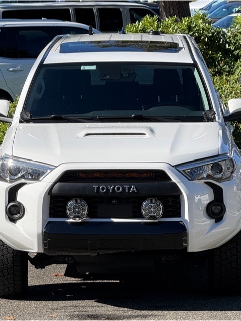

I also removed the stock roof rails and used the Toyota roof rail delete kit. I prefer the slick top look, which more closely resembles the original TLC.

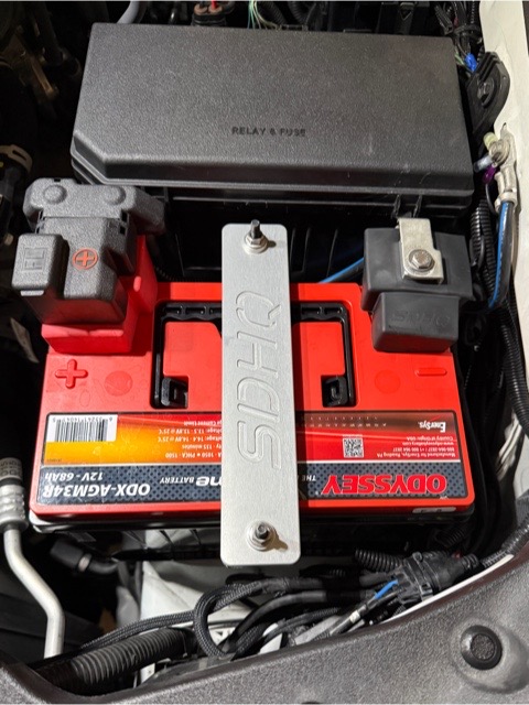

Another recent addition was the Odyssey AGM battery, SDHQ billet terminals, and SDHQ billet hold down kit. I also used the VoltageBooster Pro to let the AGM receive the voltage it prefers. Simple swap and all plug & play.

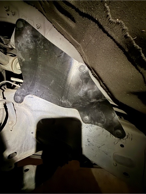

After hearing a tapping type sound at the left front corner while driving, I was concerned about possible light engine ping. Some research led me to posts about the inner fender liner pieces and potential loose clips that can allow movement, causing similar sounds at speed.
I ordered the thick replacement pieces from Rad Rubber Designs and installed them in about 15-20 minutes. Noise is gone. Great upgrade.

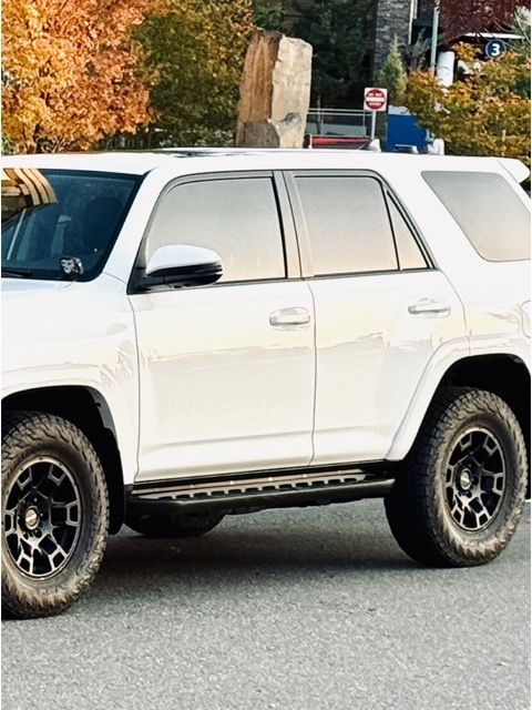

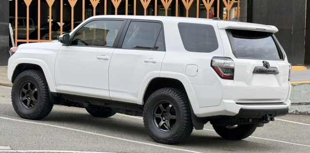

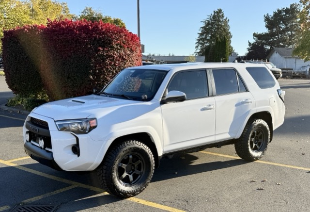

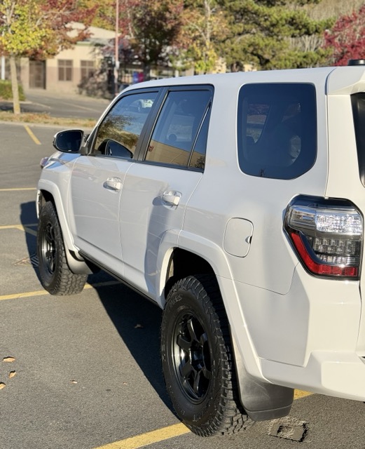

Hey folks, here is the latest…..
FN / Konig Six Shooters in grey metallic, 17x8 0 offset. Dustin was fantastic to deal with, as you’ve already heard….and it’s all true.
Nokia Outpost nAT in 265/80-17 Load Range E.
I think they look spectacular. I’d read that these tires rode great, even in load range E…. and I can confirm, it’s true. I’ve run 275/70 K02’s in E and 265/70 in C - this rides and drives better than both. My last tire adventure was the very comfortable 265/70 Nitto Terra Grappler G3 in standard load. Those were super comfortable and pretty quiet. The new Nokian’s are just as quiet to my ears. They ride a little more firmly @ 42 psi cold, but it’s like the difference between nylon hiking boots (Nitto) compared to leather ones (Nokian). The Nokian feels a bit more firm, but acceleration, ride, handling, braking are all excellent.
A nice bonus; for an “E” it’s somewhat light weight. The current setup comes in at the same 71 lbs total per corner as the stock TRD Off Road wheels and tires that come on this model. No damage done.
The only negative is minor, requiring a slight bumper trim at the front bottom corner (like the stock Pro trim that happens at port).
Overall I’m really happy.
Pics to follow when I downsize them.
