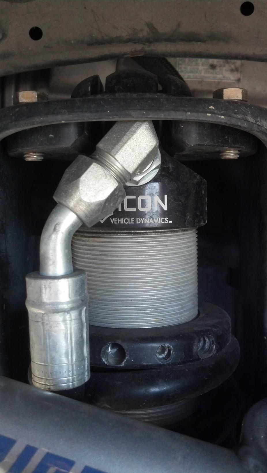

whats your tire size, fender height from the ground and the amount of threads showing via pic of the coilover.
Also, whats your overall opinion on how they support the weight.

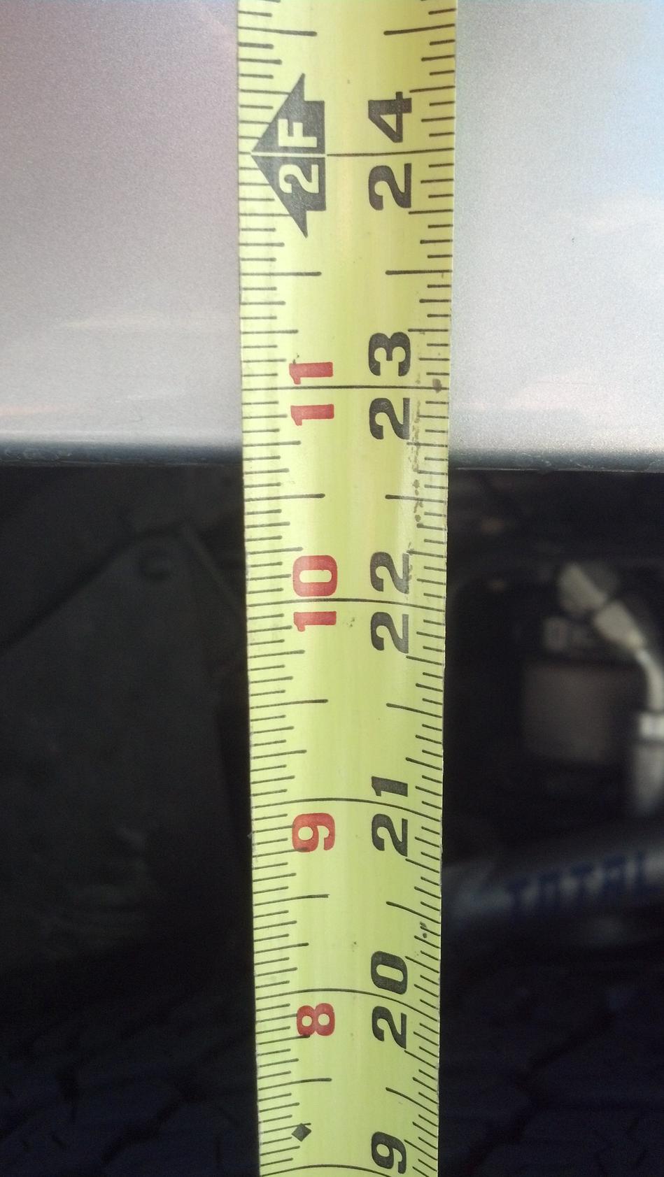

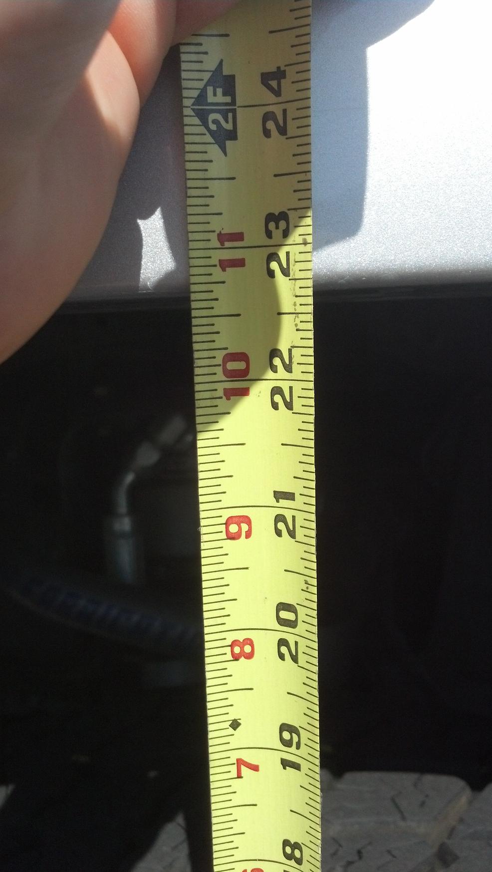

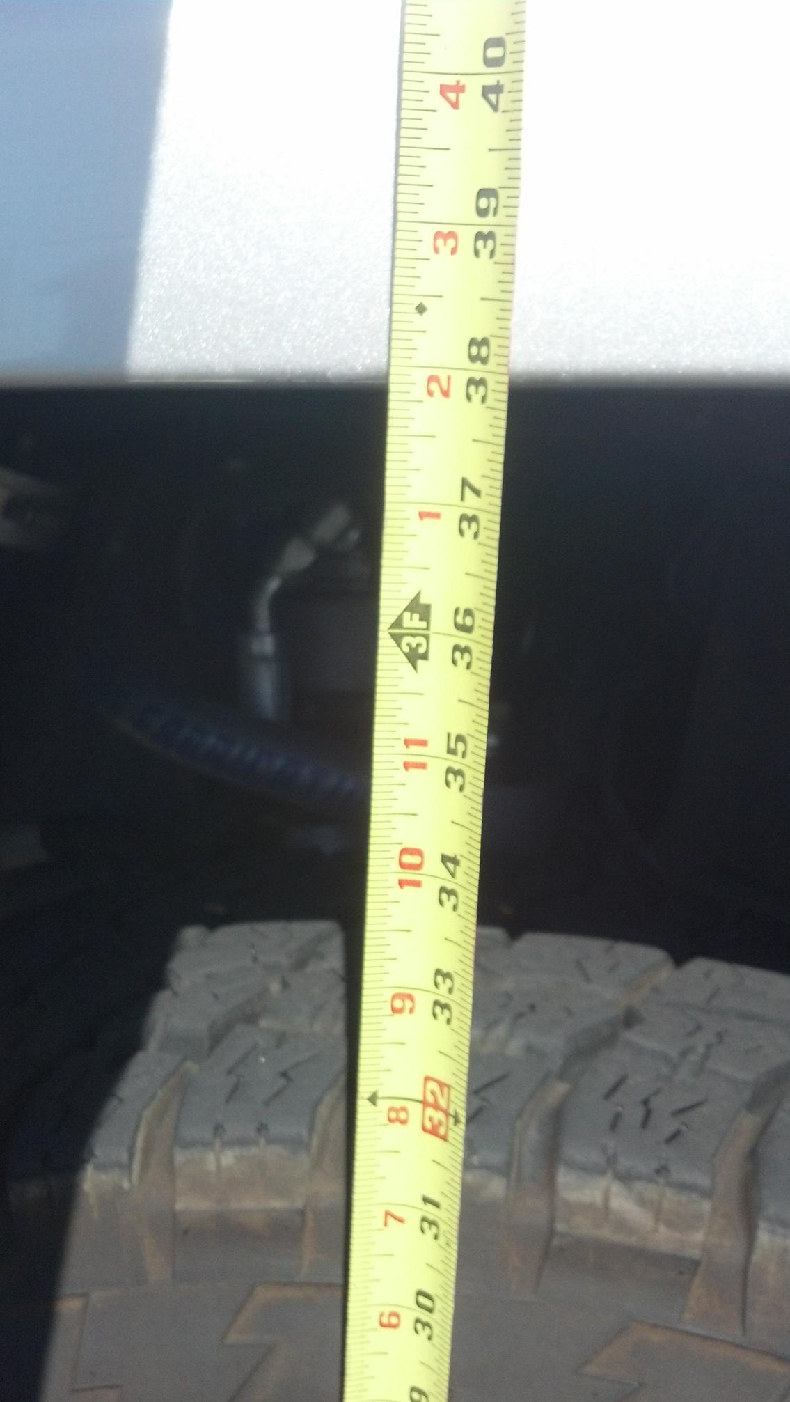

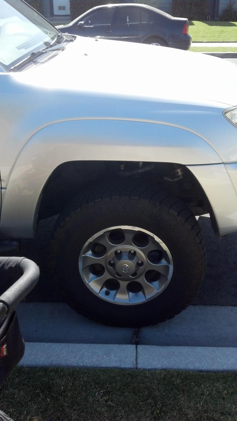

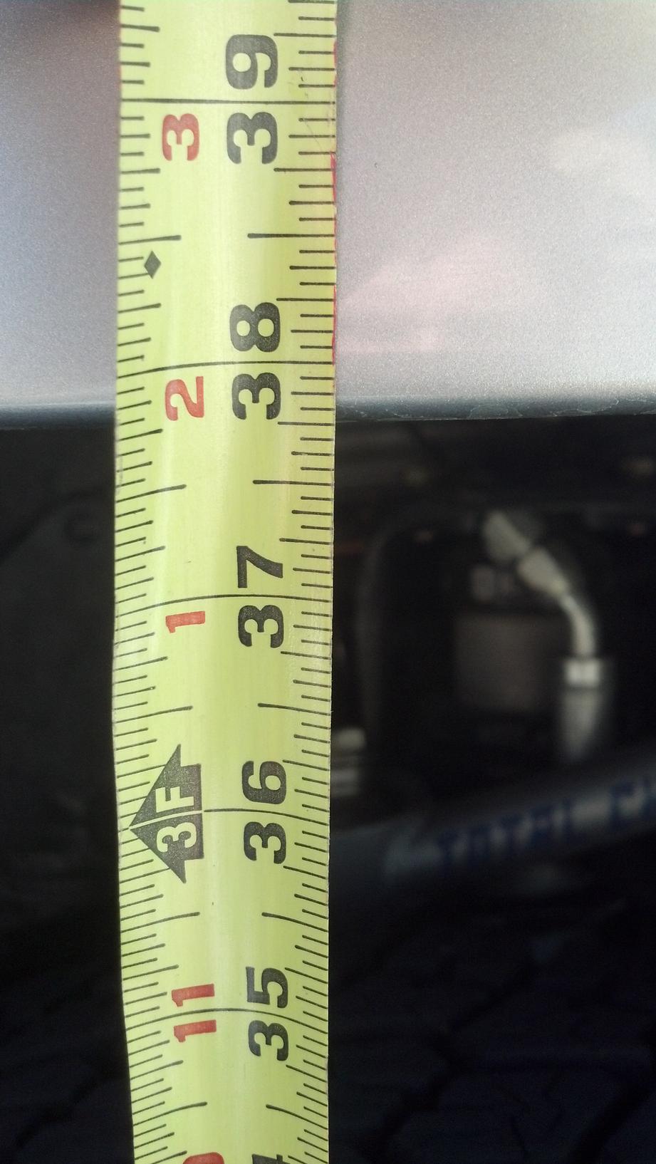

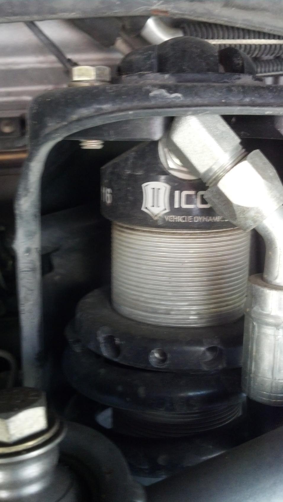

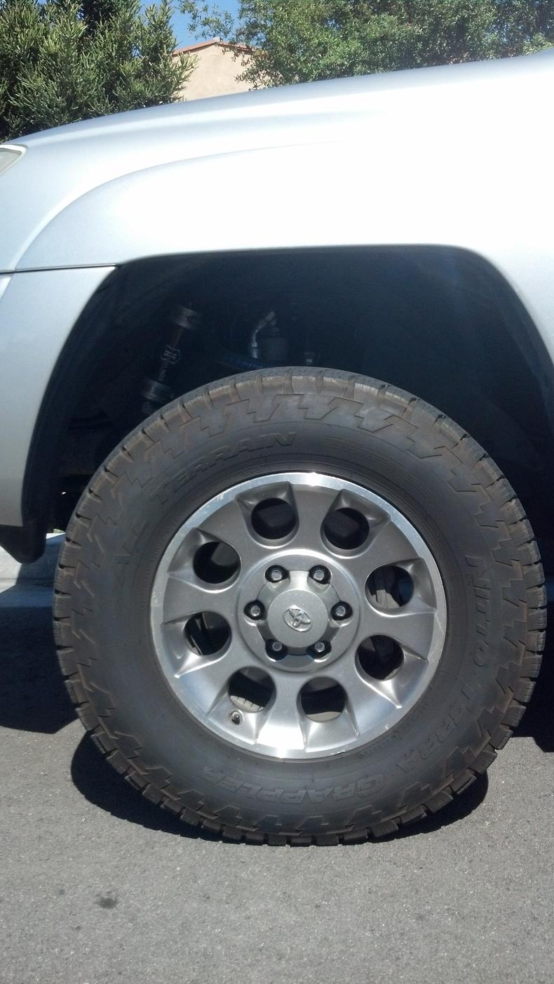

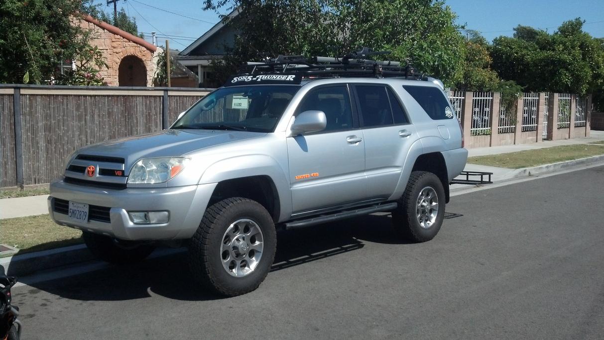

So I just ran out and tried to get the photos you asked for. I'm running 265/70r17 nitro terras on 7.5" wide rims at about 75% tread. It seems as though both sides ground to fender are about 37 3/4" +/- 1/8", and both sides hub center to fender are about 22 5/8". The first of each photo is the driver's side and the second is the passenger's side.
I love the ride of the fronts on the road. They seem to soak up everything really easily, and rode super nice at pismo with a little bit of speed. The rear is what I'm having trouble dialing in to my liking.
Let me know if you need more!
