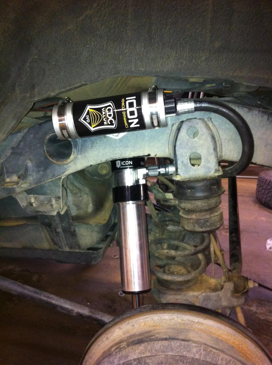

this is why I ordered mine with remote reservoirs. I tried tell the design guys at ICON about this problem when I ordered my remotes reses. I took off my swaybar anyways. The bummer is even even if you take off the swaybar they can spin around and still get smashed by the control arm. If you ever do get remote reses instead you still have to remove the sway bar, get rear wheel spacers and grind down the mount for the rear bumpstop. On that long note I still wouldn't trade my ICON setup for anything. Here is a pic of my setup.
