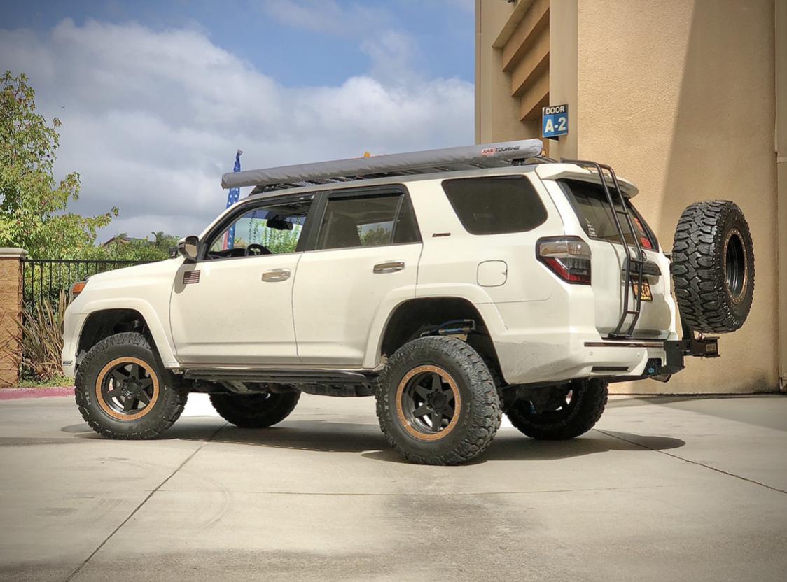

I can tell you mines did not yield a 3" lift. My fronts are 2.5, it did settle after week and when fully loaded it seems to dip down in the back. It makes me wish I went with the 3" lift. The ride is perfect and smooth in the back but my 6112's up front are maxed at 2.5 and seems to ride a little stiff. I am happy with the lift.

Are you on the 5th notch for the 6112s to be max at 2.5"? Most, myself included avg a 2.5" lift on the 4th notch. I'm planning to raised to the 5th notch to match my Icon overland. If you are indeed max out, you most likely don't want the 3" icon. There's a lot of variables with the 2" lift. From having the base vs limited or non 3rd row vs 3rd row. I was afraid the 2" icon was going to sag with my 3rd row and extra weight so I decided on the 3".

Yikes, yeah I am on the 5th notch and I was debating on the 2 and 3 inch ICON's because like you said the 3rd row. I talked to the shop that was selling them I think downhillsports from California and they said the 3 inch would've been too much. The 2 Inches were stiffer than stock and would be enough but I think the 3 inch would've been the right height. It did even out the lift and happy with it but when I pack it that is the concern. Thanks.

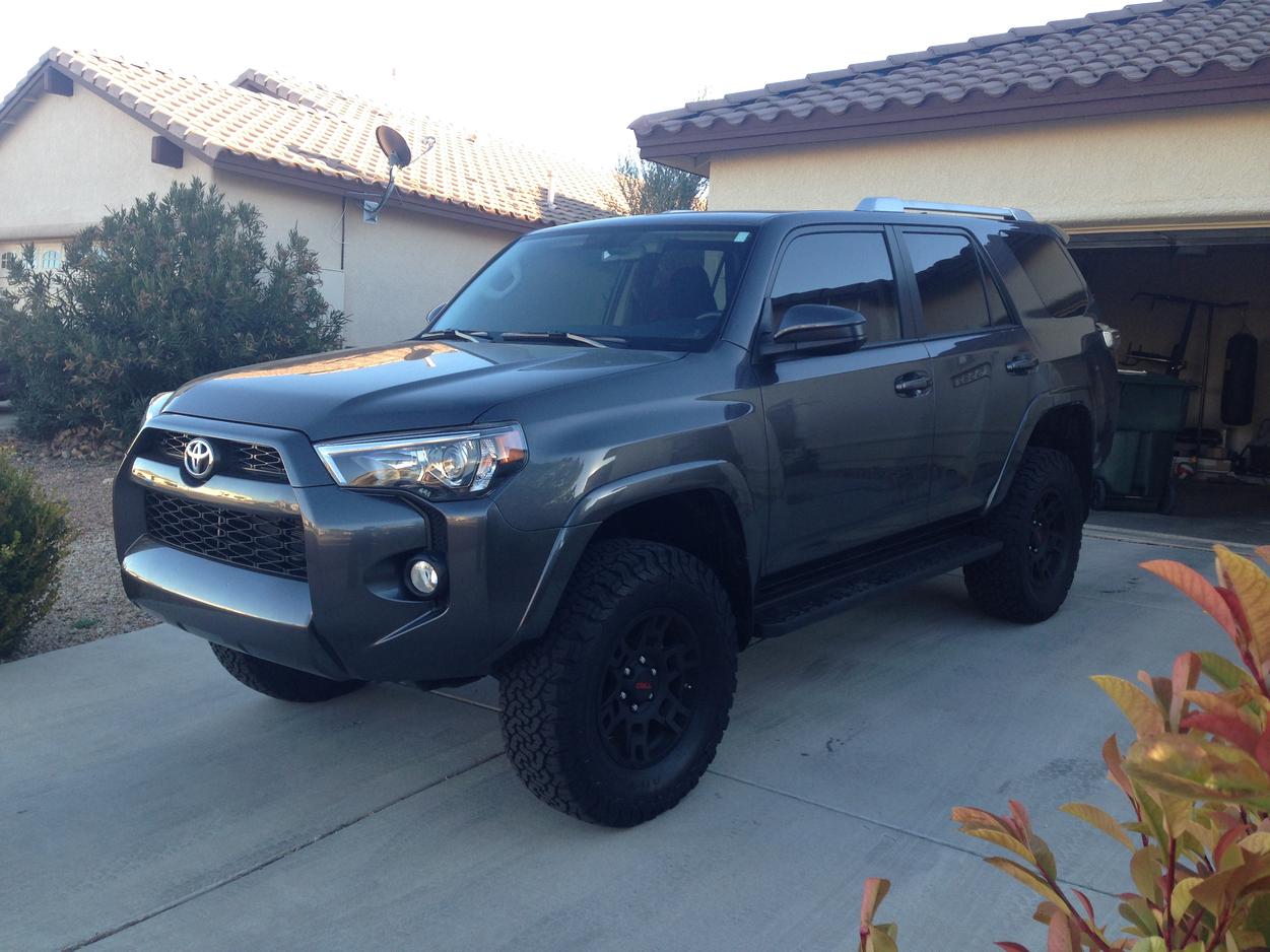

Before and After
First pic is 500 miles into the lift.
Second pic is 2000 miles post lift and final alignment/adjustments + rack.
The second pic is a little more leveled out.
Put about 2-3K miles on the truck maybe more if it's all pavement driving then do your final adjustments.

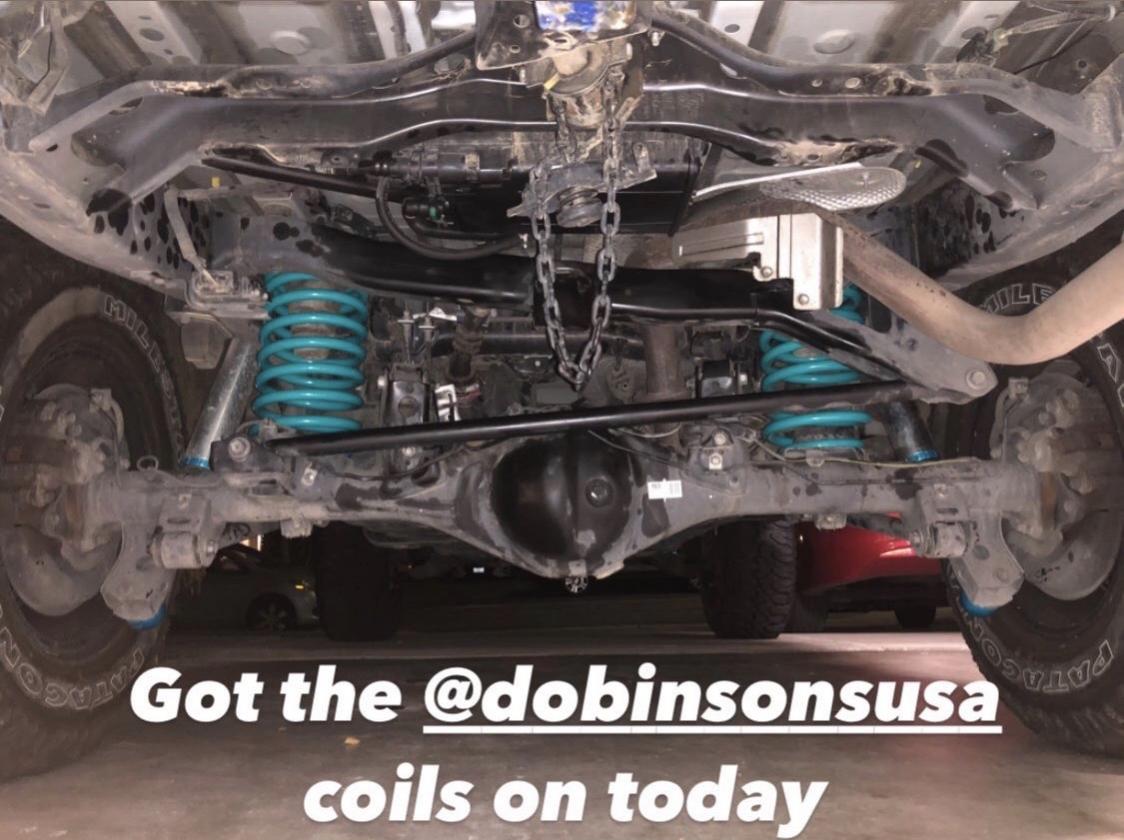

When I installed my Kings and ICON coils i preloaded about 2" to level out my rig. I already had my GOBI (65lbs), ARB awning (35lbs) and my BudBuilt Sliders (about 155lbs). I recently got my Wilco tire carrier so w/ my BR6 and 285 pats, I added an extra 141 lbs of tongue weight. Also add the 100lbs for the 3rd row and my weight I was carrying daily about 640lbs. I was sagging in the back (Cali lean).
So i recently upgraded to Dobinsons 701V. I got the height and got a little rake to account for my daily weight, my family's weight and accommodate additional weight for overlanding.
Moral of the story, depending on what you're planning to do with your rig in the near future (add sliders, roof rack, tire carrier, RTT, batwing awning, armor, steel bumpers, etc.) you may want to get a coil rated for a heavier load. I bought and installed my ICON 52700s in March 2020 and I recently removed/upgraded them in Sep 2020.
I don't have a picture of the before, but here is my after pic with the Dobinsons 701v.
**also, if you raise the rear keep in mind you may need to upgrade your panhard (prevents lateral movement for the axel)bar or get a Panhard Correction Kit (PCK).
