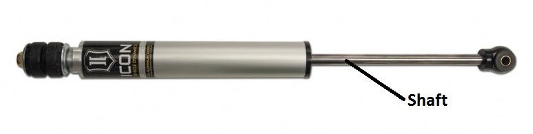

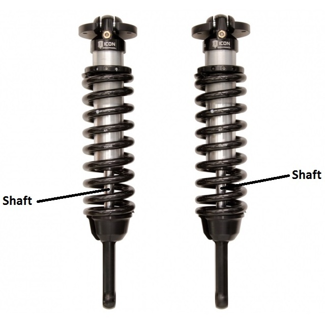

Installed ICONs COs about a week ago. Ride nice...
Washed truck today and noticed they started squeaking. Not real loud, but could be heard at low speeds with windows down.. I hit the lower shaft with a little lube and it pretty much went away. Anyone else experience the squeaky shaft on ICONs. For this kind of money they should sing a song LOL
The shafts shouldn't make noise, it is usually the spherical bearings at the top and especially the bottom of the shock. When they wear out they get really, really noisy. I buy them in bulk from Summit Racing COM10T. Well, what do you know, they are on sale now for $7, usually $12, think I'll order a dozen.
Lubing the shaft definitely eliminated about 90% of the noise.
These are brand new, Maybe 30 miles on them. They may just need to break in and the first wash took away some factory lube.
You could only hear this noise if you were listening for it while driving, but if I stood on my sliders and rocked the truck back and forth, you could hear lots of squeaking.

Hitting the spherical bearings and the shaft with T9 every month helps but you'll still get noise!

Exactly. They can make some noise but not an irritating nor extremely loud noise. I only notice when all the windows are down and I'm trying to listen for noises. Otherwise, nothing. My recommendation for lube was simply to keep them clean and well lasting. Any time you have moving parts, a little lube saves a lot of maint. Also, it will depend on normal driving conditions. In CA, I am not subject to harsh road conditions daily like those in other states.
I have fr/Rr Icons on 2 vehicles for 5 years now. Neither make any noise. Dry silicone lube the shafts and bushings every once in a while for good measure.
I will recommend, from personal experience, that you run a shock boot on the rear shock shafts so that you don't end up pitting the shaft from gravel/tire spray while running in the dirt. I had to replace the shafts on my Tundra rears from hammering them too hard with road spray.
