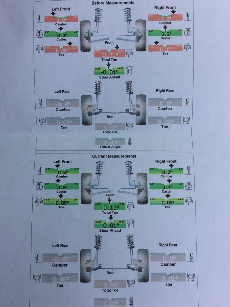

Went to firestone and got their lifetime alignment today for $120. This is the printout:

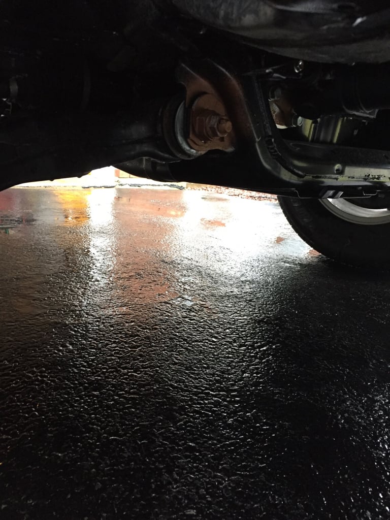

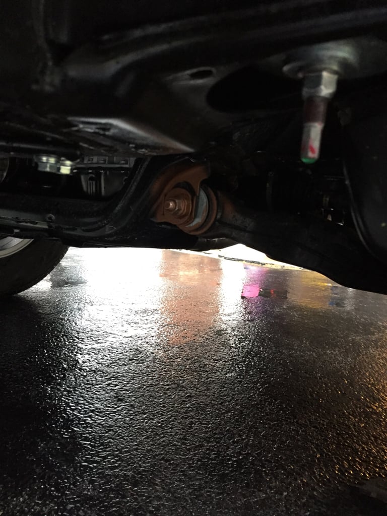

The numbers seem to look pretty good. However, the back cam bolts don't mirror each other. Aren't they supposed to? I will upload a picture in the morning because I forgot to take a picture while it was still bright out.
Ok here is the driver side back cam bolt:
And here is the passenger side back cam bolt:
They don't mirror each other. Just wondering if that is ok or is it bad?
