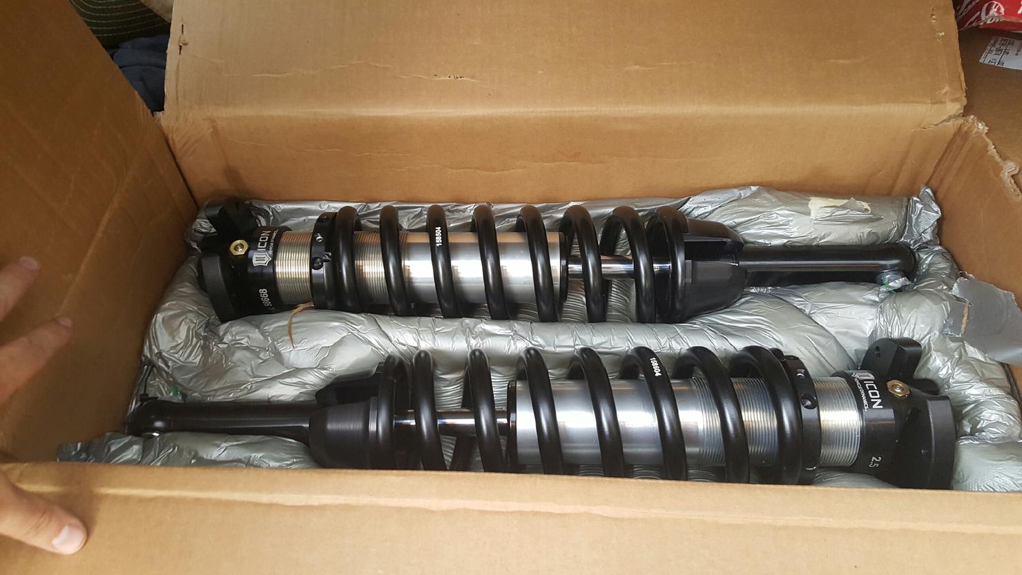

Today I received, via the magic brown delivery truck, the Metal Tech ICON Stage 2 lift with LR UCA's. WHOOHOO!

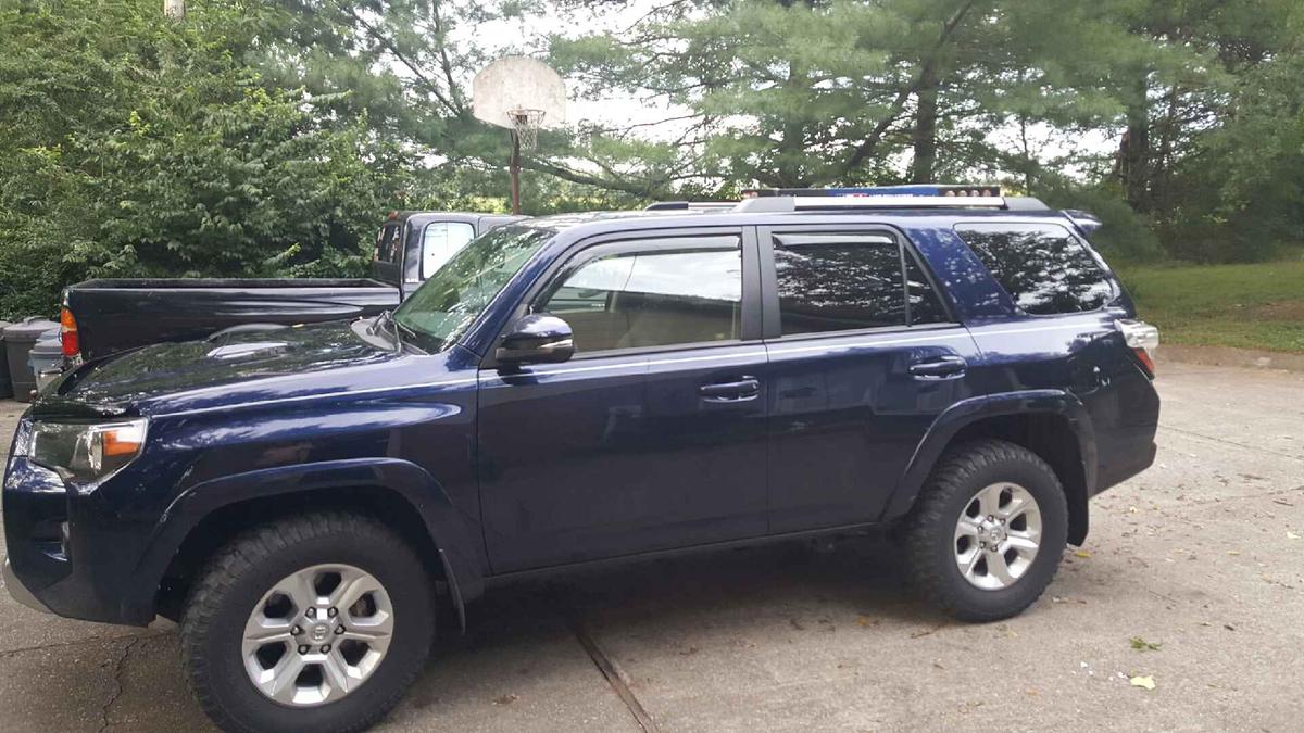

Here's a before picture of how the rig sits today. Hopefully I'll do a better job of documenting the install than I've done on past installs. I've never had much help which makes taking pictures very difficult for me. I'm usually in a big hurry too, I'm assuming because I really don't know what I'm doing and it makes me nervous.

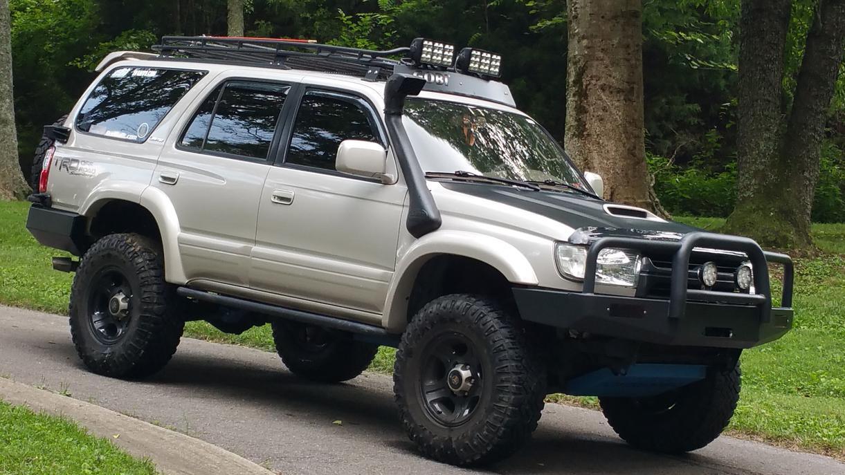

When I got my first 3rd gen, I had to fix the rear coil sag which led me to this site and ended up with the rig pictured. Picked up a new hobby, made lots of new friends and saw a lot of new cool places that I'd probably have never seen otherwise...the Toyota obsession began with sagging rear coils.
Now, this 2015 has a nose dive when you hit the brake pedal and it must be fixed...I wonder where this will end up! Hopefully many more new friends, new adventures, new and exciting places, and good memories. Thanks guys and gals for the pointers. I'll do my best to let you know how this turns out!
