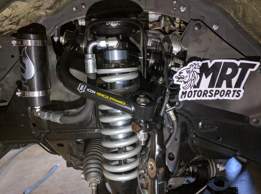

My remote reservoirs mount completely different on my 4Runner. Do yours mount where the stock sway bar mounts attach to the frame?
Looks like they didn't even move the shocks which = 1" with 0 turns (stock). 5 turns = 2" lift. Pretty sure that's right...
