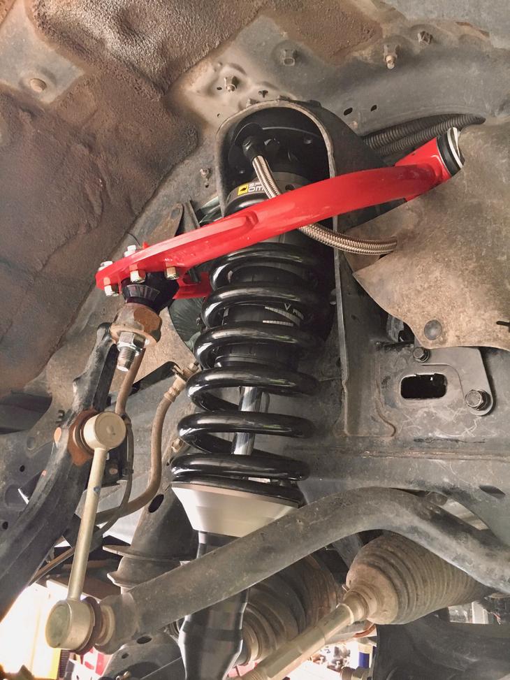

You should a least look at the JBA UCA's. They have as good or better articulation than a uniball, easy to lube via zerks, easy and inexpensive to replace ball if needed and come in two styles with an HD version if you rock crawl your rig. Oh, and did I mention they are only $450. I have had mine now for 10,000 miles and not a sound, shake or shimmy. Just a happy customer and not affiliated with JBA.
