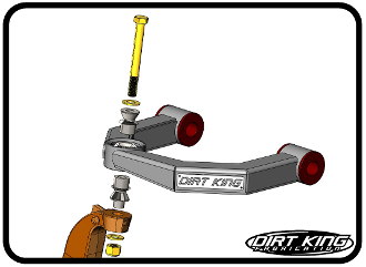

I might pick up a set of delta joints and put them in my DK uppers.....
I'll see what dirtking thinks of the application. The misalignment spacers DK uses for the uniballs stick up very high above the uniball, but I see the delta joint includes the taper.

[MENTION=122813]nb rob[/MENTION] I'd be very interested to hear if DK can put the ICON Delta Joint into their UCA.

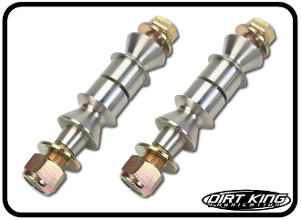

The Dirt King comes with an FK 1" stainless steel uniball (link to FK in a post above). Are they causing anyone problems?
Pardon my ignorance, but where are the misalignment spacers in the DK. Not sure which part they are.
For $100 more than the uniball joint you can get the ICON tubular UCA with a Delta Joint, for $839.
Sorry, my mistake, they're just called spacers.
I wore through a pair of stainless wssx16t uniballs after one winter, and that was my best effort to keep them clean as often as possible. They weren't causing problems, but everything was making noise, and I replaced them right after I did other spherical bearings. Things tightened up noticeably when the uniballs were replaced though.
