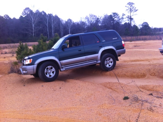

I have a 2001 4runner limited and am looking for advice on good mods. It has 140k miles 265/75 16 firestone a/t's and a magnaflow muffler. Tomorrow im taking the running boards off and next week i want to paint the wheels either gunmetal grey or black (haven't decided yet). I'm a freshman in college so i dont have a ton of money but i can make things work. also im looking at coil spacers.

Nice truck man! I love the 2 tone color scheme!
I'd say paint the wheels gun metal...black rims are too common....or leave them silver...I would actually love to have your wheels!

Also, could I convince you NOT to buy the coil spacers? I did the same thing for my front setup when I first lifted it...and hated it. The ride was horrible, and just killed my springs even faster. You could get a set of used TRD 4X4 Tundra front strut assemblies and pair them with some Land Cruiser coils for your rear, and that would cost you about the same as a spacer lift! The difference being, the Tundra/Landcruiser stuff rides a whole lot better. (If you haven't already, check out this thread: http://www.toyota-4runner.org/3rd-gen-t4rs/66976-3rd-gen-4runner-lift-information-faqs.html )
