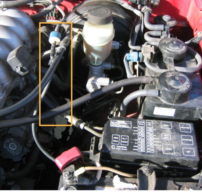

Identify this vacuum line!

Since it has a check valve, I assume it is the line that serves the ADD system. On the fender it connects to a 4-way mini manifold that has lines to the two VSV's and a reservoir inside the fender. The truck is not nearby, and my memory is vague on this, so I can't tell you where it picks up vacuum from the plenum.
Thanks much, guys, that helps. The photos are great but just need a bit more angle to see the back side of the Manifold.
Figured it out. It goes from the wheel well up and over the supercharger to the the vacuum port on the back of the mounting area for the throttle body.
