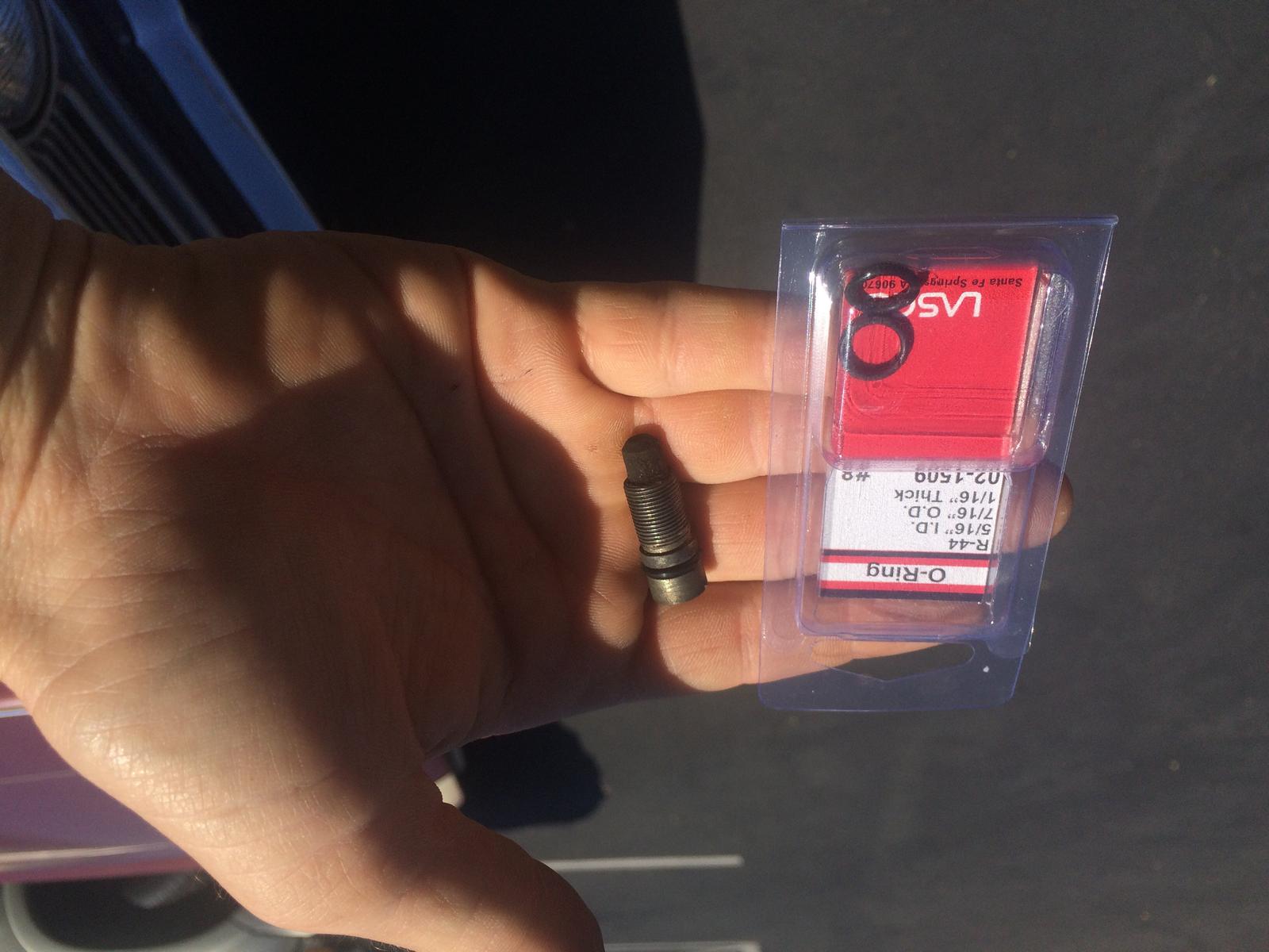

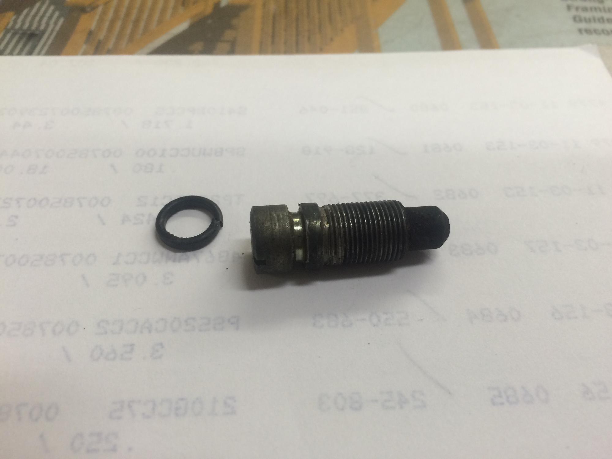

Replaced 27 year old O ring. Definitely the problem. Thankyou. Here are some pics for those who are interested.
