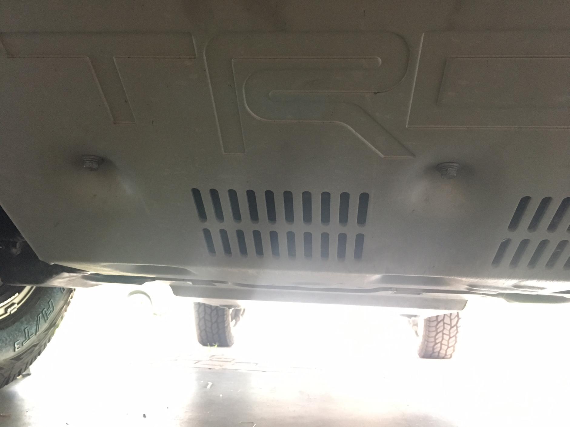

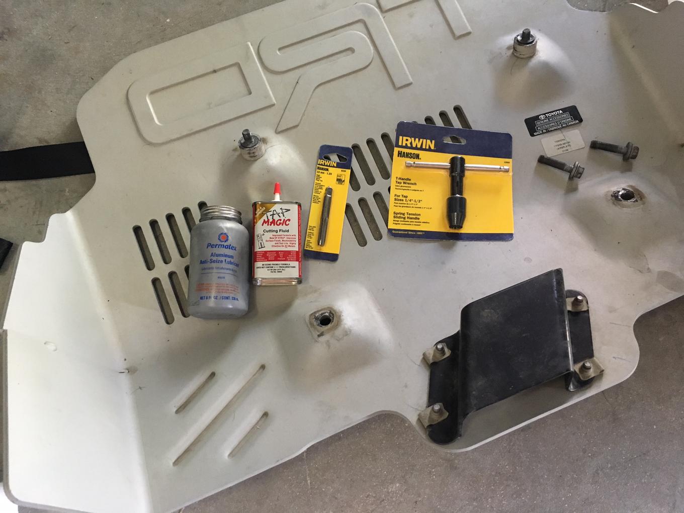

Last weekend I took my 4runner in for its 30K service a little early because we are leaving Friday for our biannual trip up to Maryland for 3 weeks to visit family. So in preparation I removed my skid plates (because I didn't want the dealership messing them up with their power tools)…except the back passenger driver side bolt on the TRD Skid was stuck. My reaction was pretty much “Oh Shit I know where this is going!” as I’ve read all of the threads on the issues with this. I also read but did not heed the advice of Saker (hence when the “I told you so” potential thread name) when initially installing the skid plate as the bolts seemed to go in just fine, maybe a little snug on the last few turns. Luckily the dealership was able to remove the bolt without any damage to the radiator support or destroying the threading of the hole (edit: I told them not to re-install the skid once they got it off as I'd didn't trust them to not lock the bolt on place permanently). As I said, I was lucky! As soon as I got back from the dealership I ordered a M10 x 1.25 Chaser Tap, some Tap Lubricant and a Die (same materials as in Saker’s post above) from Amazon.
https://www.amazon.com/CHANNELLOCK-8339-10mm-1-25-Metric/dp/B0002JT0Y6/ref=pd_lpo_vtph_469_bs_lp_t_2?_encoding=UTF8&psc=1&refRID=C4HF5HA7VKD963DYP57N
(I just bought the "Frequently Bought Together Trio of Parts)
I have never done a drill tap before in my life. Thank god for YouTube! Watched a couple videos on it and it seemed very straightforward. For those of you that haven’t done this, here is the quick and dirty of it.
1. Line up the chaser tap with some lubricant on it with the bolt hole.
2. Initiate the tap with a couple of turns; you will feel it catch the previous threads.
3. Complete a couple of hand turns then back it out about a half turn and repeat for the length/depth you need.
4. Back the tap out turning slowly.

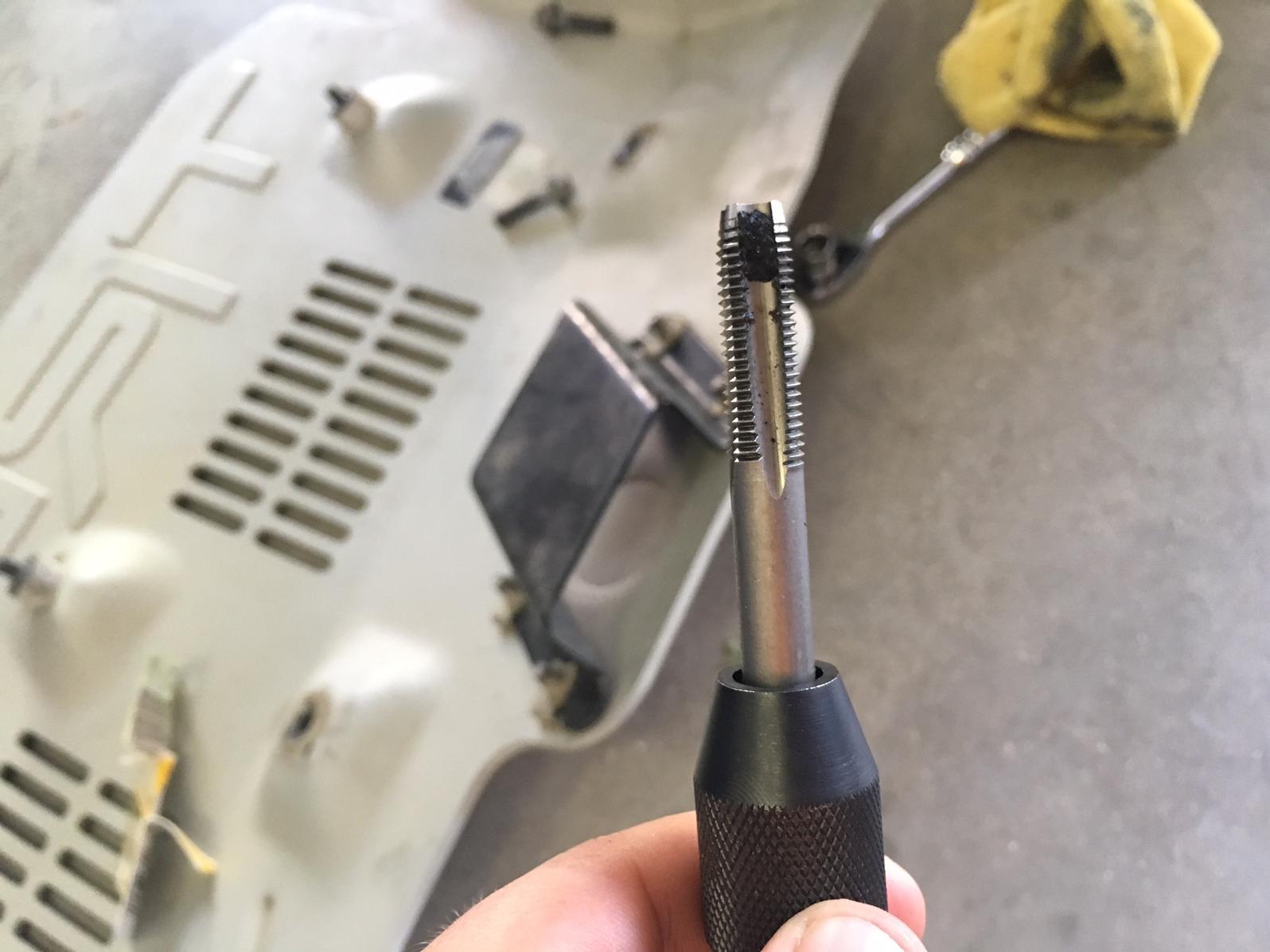

You can see in the pics below how dirty and how much material the tap removed from the bolt hole. This is why there have been so many issues. After completing this procedure on all 4 bolt holes I could literally hand screw the bolts in and then tighten easily using the M14 Socket Wrench.
If you have a TRD Skid Plate, this is worth the $20 in materials. It could save you hundreds of $ in the long run. Oh and I used some anti-seize just for good measure.

[MENTION=120701]Cymon[/MENTION], how do your get you truck to float in the air like that with no jack stands?
-tap & die- set is a must. Already drilled and tapped one of my transfer skid bolts cause the Shrockworks stick nut broke.
The Force...Duh! :vader:

Does the chaser tap just re thread the hole for the bolt? I had trouble with one bolt refusing to tighten all the way the last time I went to put my skid plate back on.
It works both as re-threading and cleaning up the threads already in the hole. This was similar to the issue I had and fixed it. The tap can create new threads as well higher in the radiator support bracket to better accept the longer TRD skid bolts.

They are normally called plug taps or starter taps because the lead angle never heard of a chaser tap lol. But the angle self-centers the tap and keeps you from cross threading while hand tapping and chasing.
There's also flat bottom taps where if the hole is blind it will thread all the way to the bottom. There's also Roll taps, sti taps but those are irrelevant to this.
Make sure your tap is gh2 or gh3. The bigger the number the looser the fit last thing you want is to chase it with a gh5 or larger and end up with a over-sized thread and have a loose fitting bolt.
And buy a quality tap like OSG I've had to extract out sooo many cheap Chinese taps for people, or broken drills and easy outs from them trying to remove the broken tap its not even funny. Last thing you want is to pack up a cheap tap and snap it off under your rig. They never snap cleanly and its impossible to drill it out with a hand drill and carbide drill bit without destroying the threads and having to install a helicoil or worse snap that drill off in the process.
Sorry for the long winded post 10 years of machining and a slow day in the shop. :ranger:
