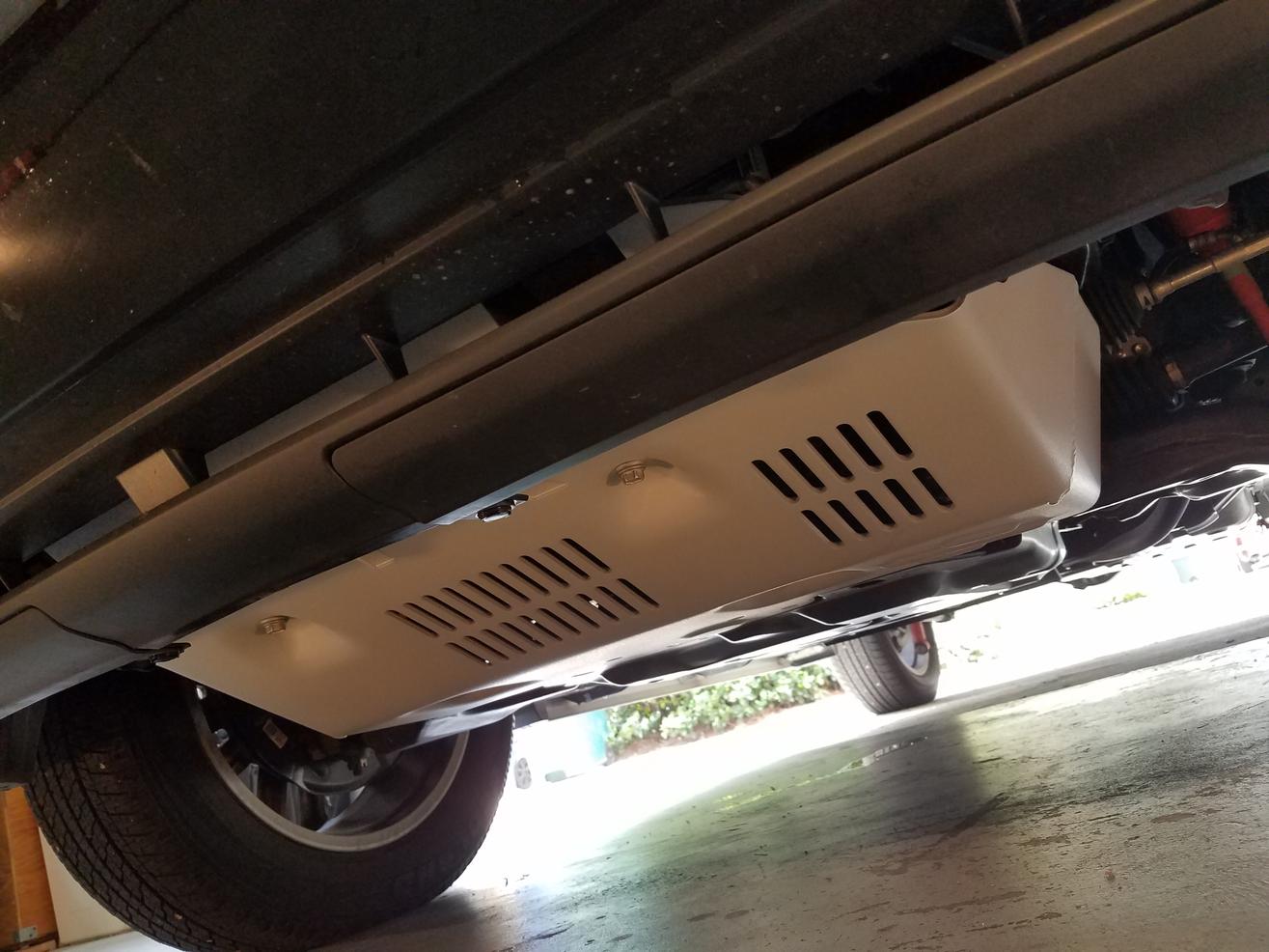

TRD skid plate installed!

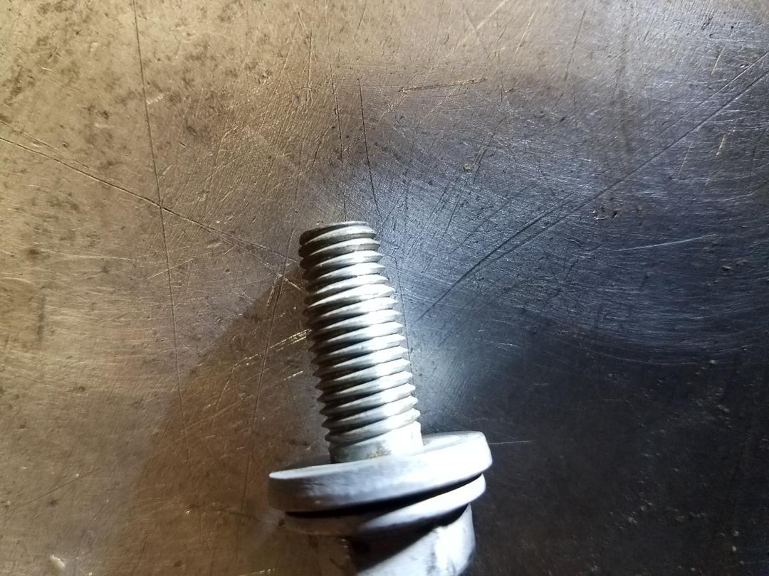

I just wanted to thank everyone who has posted to this forum. It made my install go flawlessly! When I took the old guard off I noticed the old bolts had some sort of loctite compound on the threads. Also the old bolts had a narrow tip to them (See photo). I found the thread tap at NAPA and reamed the 4 bolt holes to clean the loctite out and fully thread the hole at the proper size. I would not use the old bolts! The new bolts for the back two holes look like they need to be used to reach all the way through the mounting brackets. I applied some anti-seize compound to all the bolts although I'm not sure it is necessary if you ream the holes with the tap. Thanks to all for the help... much appreciated!

For those who are thinking of installing the TRD skid, I am almost certain you can reuse the rear bolts from the existing skid. I believe this is what I did and I have had no issues with stuck bolts.
YES! That's what i did. I was sitting there looking at both bolts, and I'm like "nah" I'm using the old bolts. No problems since.
I did my install tonight. Ordered my parts off Amazon, exactly what the OP got. Put oil on the tap thread before the starting the fronts. The back two bolts I put oil on the tap then after starting I came in from the top and poured some oil in. One pass took care of all the hunk and The second pass both came out clean. I used the supplied longer rear bolts. The hardest part I found was holding up and threading the front bolts.
