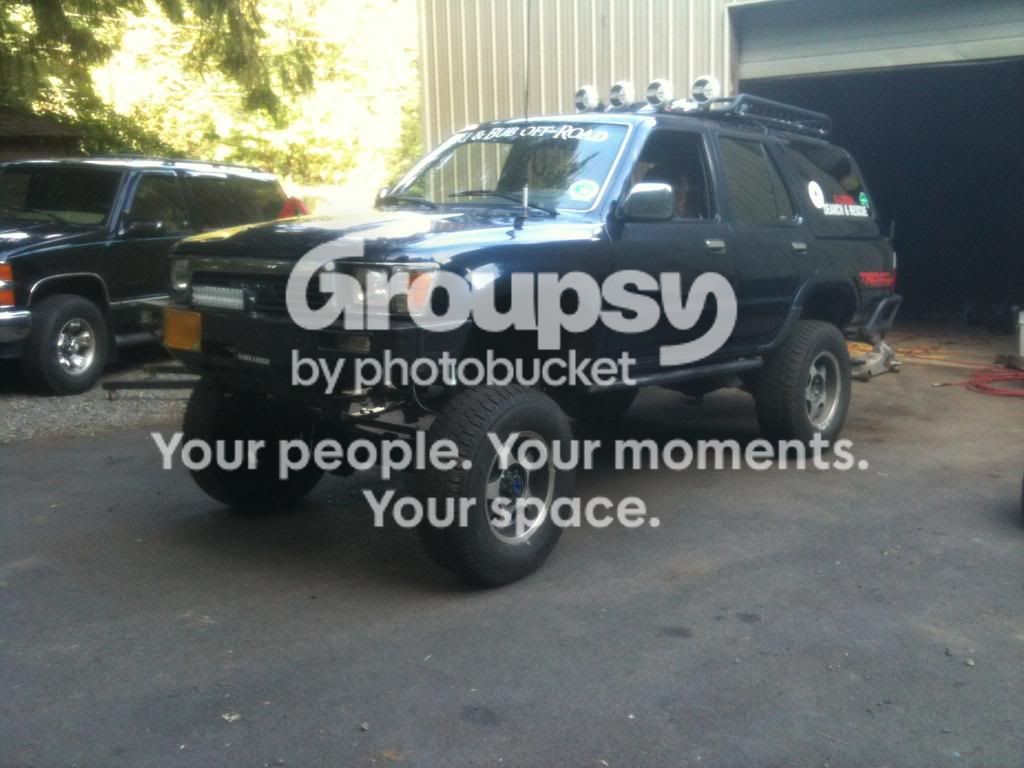

I swapped my rig a couple years ago now. I love it, it actually rides just as good as my ifs did. SAS isn't the best option for everybody though. I love the reliability of a solid axle. I tend to beat on mine pretty hard.
Although when I was IFS, I was locked front and rear. I could keep up with my buddies on 38s with solid axles, although I was dragging myself across the rocks.

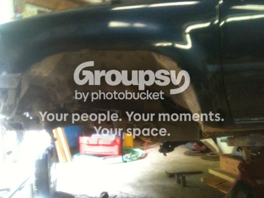

Here's a few pics of the progression of my runner.

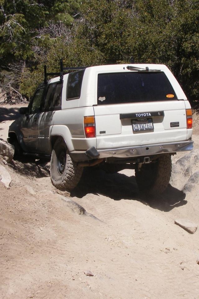

Here's what achievable (no blazeland kit) with IFS, but blazeland will achieve better just by bolt on.
