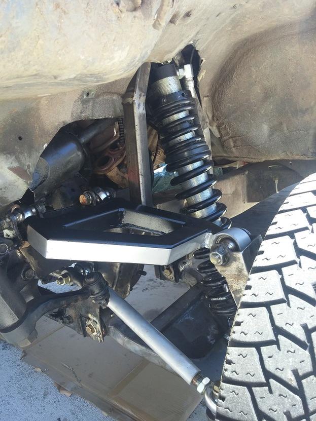

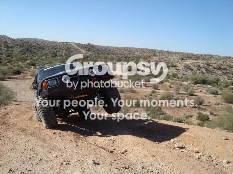

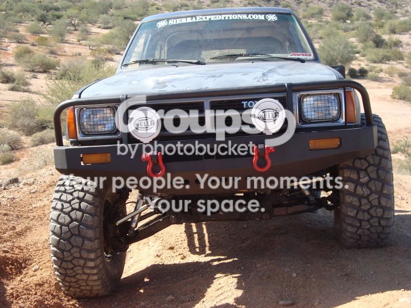

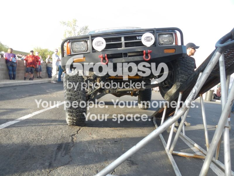

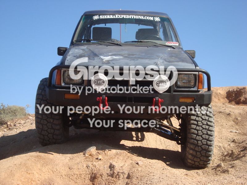

I have a Blazeland Long Travel on my 89 4Runner and I love it! Its a manual with 33's, 4:88's, 4.7 T-Case, Detroit locker in the rear - I have only ever broke a CV once and that was like 8-9 years go when the truck was stock and I was inexperienced. I go wheelin with a group of heavily modified Jeeps and I can keep up with them pretty much anywhere they go -
[MENTION=120467]santanvalleydirt[/MENTION] - here are some pics and a video of my LT 1st Gen:
santanvalleydirt - I see you're in AZ also - I live in Chandler, if you ever want to check out my setup or even go wheelin with us so you can see it work in person let me know! I'm always down to get some dirt on the tires :)

What are you doing for tie rod ends there, Jeff, is that heims and stainless I see?

Most of the parts are stock. The Blazeland kit uses factory control arms that are lengthened, the stainless you see is just some extra long, extra beefy tie rod sleeves for the wider stance. I forgot to mention I'm running Old Man Emu t-bars too.
Tie rods, ball joints, & steering rod are all from Autozone and I do a full tear down and rebuild once a year and put on brand new parts - take advantage of the lifetime warranty, then I get it aligned at Firestone - lifetime alignment too :)

I got Blazeland kit used from a good friend who only had it on his truck about 500 miles and I don't think it ever went off pavement. He had some engine, trans & T-case issues and kinda gave up on the who truck and parted it out. He wanted my stock parts so I gave him $1200 and all my factory parts plus helped him do all the work. I got all 4 control arms, Bilstein shocks, T-100 CV's, extended brake lines - I already had the OME t-bars.

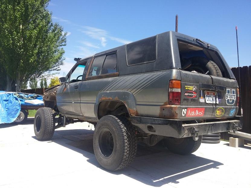

I have no complaints with the 1st gen IFS. It took a lot of hard hits and never left me stranded once. Now I'm into my own LT build that is going to take a lot more abuse :)
