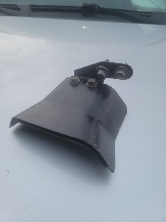

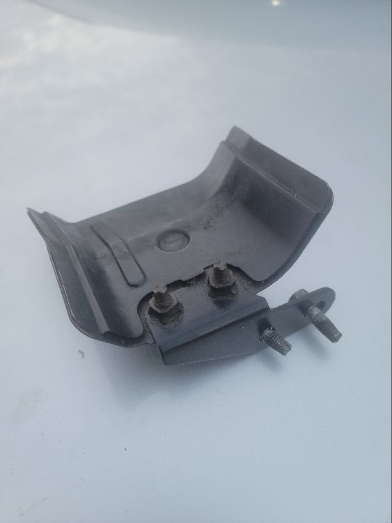

Just finished replacing the rear main seal on my 2016 4WD Limited. Next time one goes out, I'm blowing up my runner instead of trying to fix it.
With that said, I can't for the life of me figure out where this plate goes. Have the FSM for the RMS, but it isn't listed and I'm assuming I removed it to get to something more easily, but my dumbass can't figure out where the hell it goes.
Please rip me apart for not taking a picture or whatever else you might find wrong with the post, but only if you can tell me where the heck this goes. Already wasted an hour literally trying to find 2 holes that line up with the plate.

It's not the mounting or heat insulator for the transmission and it isn't the transfer case lower protector. It isn't part of the exhaust assembly either.

That looks a lot like the plate I had to remove to get to the grease fitting on one of the u-joints last week. Possibly the one on the t-case end of the front drive shaft.

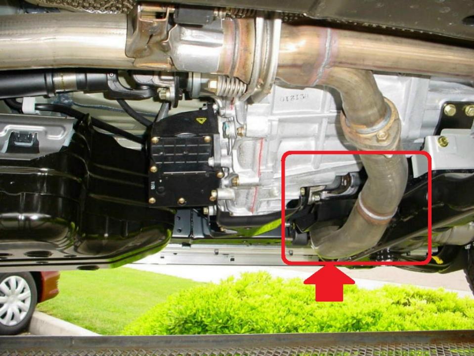

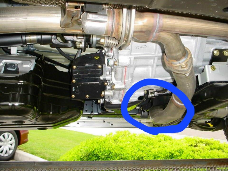

This picture is of a 4th gen underside, but it's in the same location on 5th gens as not much really changed in that regard. It's the heat shield for the cross over pipe under the transfer case that insulates the front driveshaft area. It mounts to the transmission cross brace.

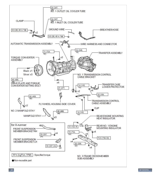

I'll have to check in the morning, but Google image search makes me think it's a heat shield that mounts to the No. 3 frame crossmember sub-assembly that supports the transmission...
Lol I just found the same pic and I think you're right! Thank you so much!!!
