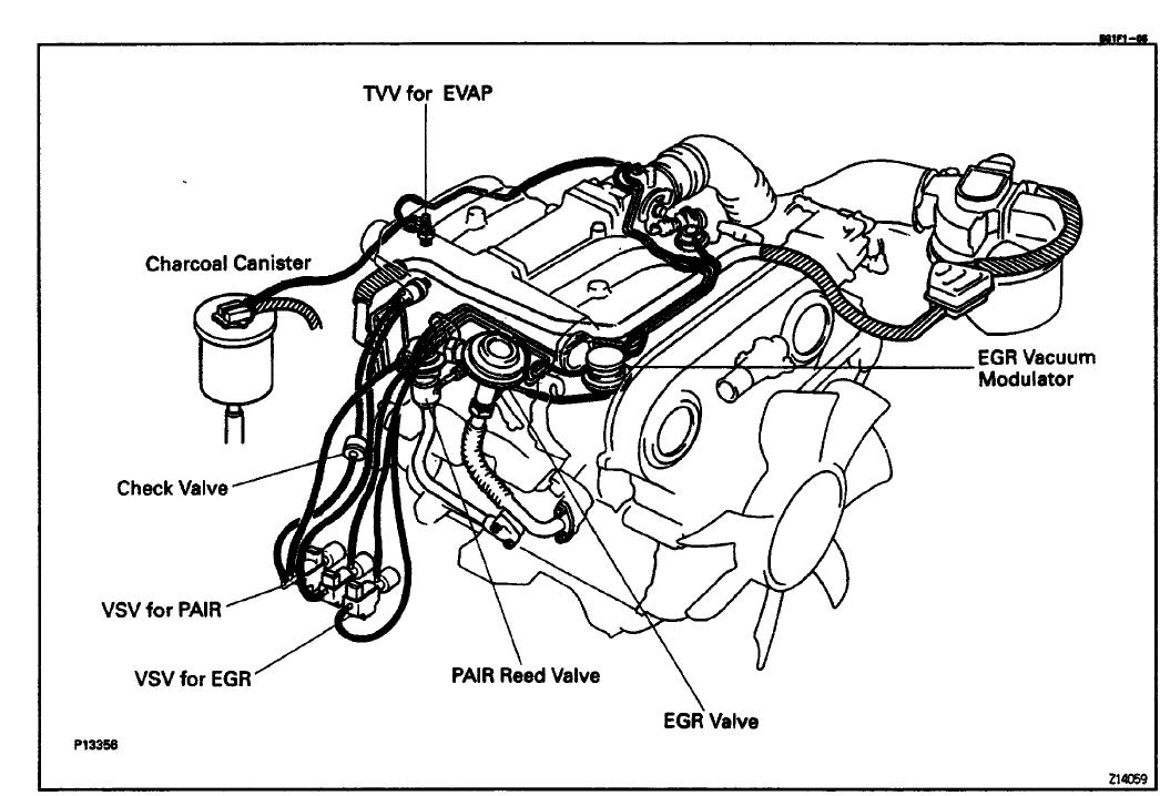

I would be inclined to think of them not changing the parts that i said but unfortunately I'm the mechanic in this one that's probly why I'm getting frustrated. I've always suspected it to be vacume related does anyone know what the vsv thing is and if that could be causing a restriction or something info on the vsv is hard to find or I'm not looking in the rite places.

Again, if you really want us to help you, more info (some pics) are needed so we know what part you are talking about. We don't know if you are looking in the right places if we don't know where you are looking.

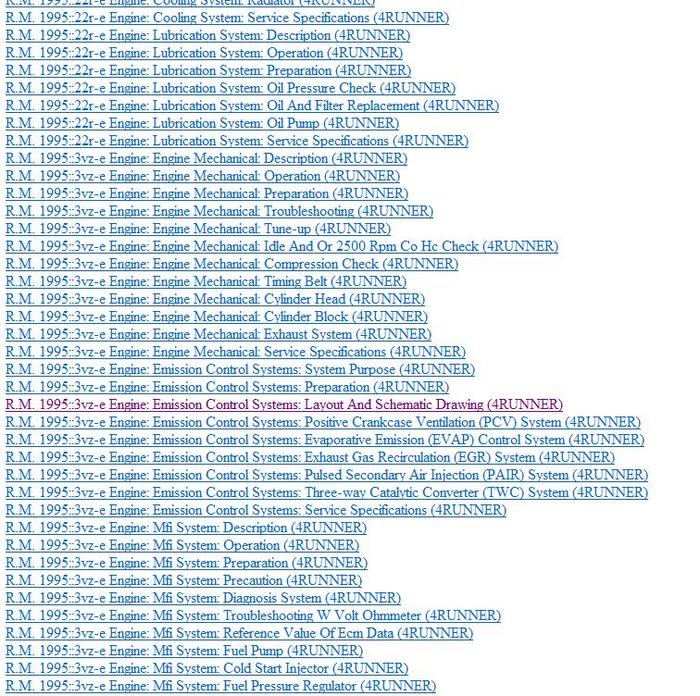

You don't say what engine you have but the 3.0 is mentioned above so I am assuming this is correct. I can't tell you whether a bad VSV would cause this but here is the picture from the FSM on it's location. You can get the FSM from the sticky at the top of the Classic Page or from here Toyota Tacoma/ 4Runner/ Tundra/ FJ Cruiser Factory Service Manual Page
