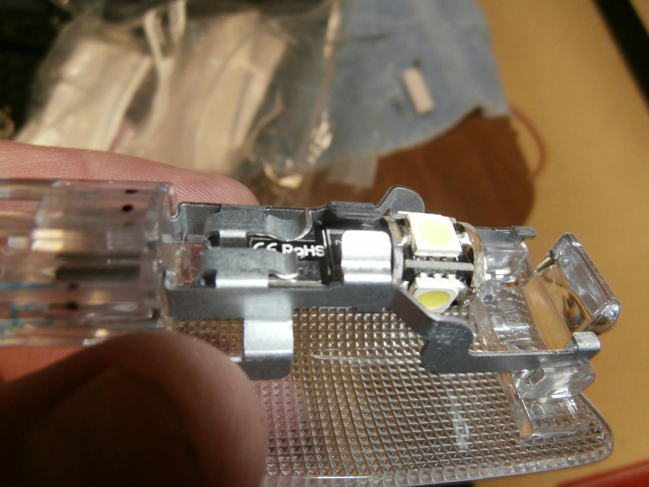

While you are in there, change light to LED.
https://www.superbrightleds.com/mor...bus-led-bulb-5-smd-led-wedge-base-tower/1127/
Door Lights (35 lumen)

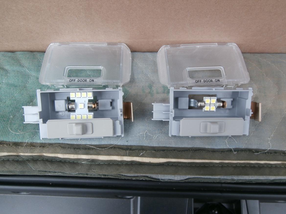

While you are in there, disconnect the tailgate cargo lights and install led panels.
Cargo Area Lights
The one on the left...(140 lumen?)
https://store.ijdmtoy.com/ProductDetails.asp?ProductCode=LED_9SMD_D31_SKU24
The one on the right...(70 lumen)
https://www.superbrightleds.com/mor...-bulbs/de3175-led-bulb-4-smd-led-festoon/238/
