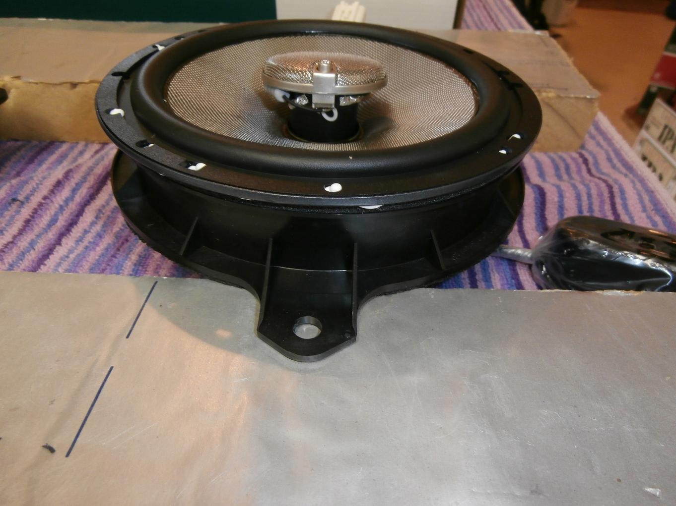

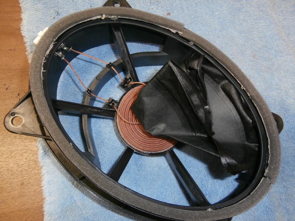

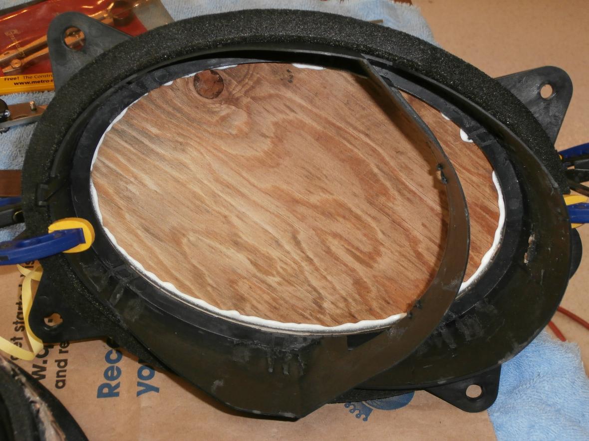

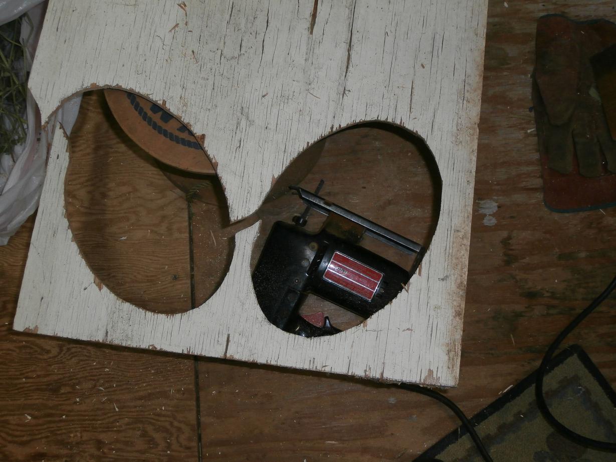

First off, here is a list of the speakers and material I installed:
Infinity Kappa 32.9cf (Dash)
Infinity Kappa 32.9cf 3-1/2" 2-way Speakers - Sonic Electronix
Infinity Kappa 652.9i (Doors & Tailgate)
Infinity Kappa 652.9i (6529I) 6-1/2" / 6-3/4" 2-way Kappa Speakers
NVX SDVK4 (6 Pieces)
NVX SDVK4 Versa Kit, 4 Sq Ft of Sound Dampening (1 18"x32" Piece)
Metra 72-8104 (Toyota Speaker Harness f/ Doors & Tailgate)
Metra 72-8104 (met-728104) Speaker Connector for Select Toyota
PAC BB-1PR (Bass Blockers f/ Dash Speakers)
PAC BB-1PR (BB1PR) Pair of 6x9 Bass Blockers / Passive Crossover

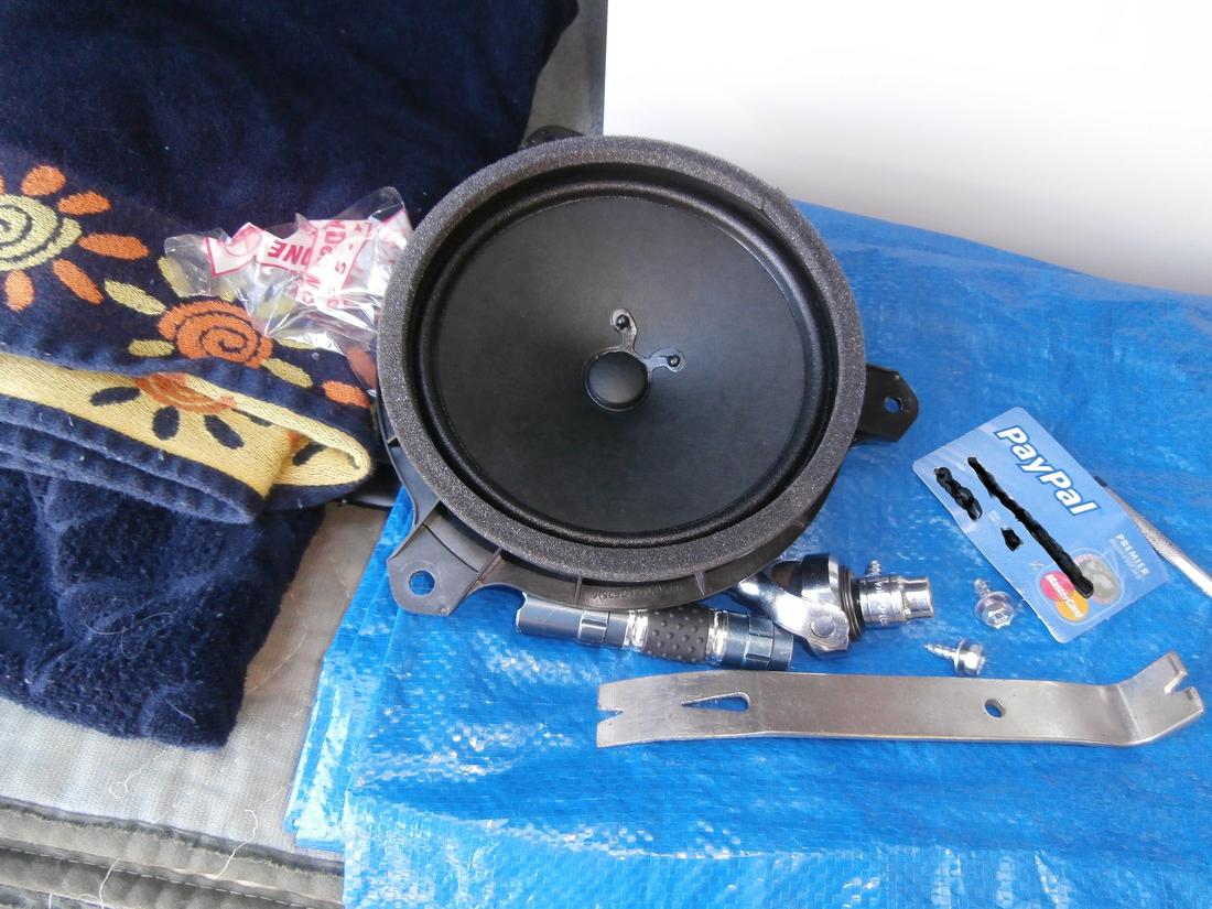

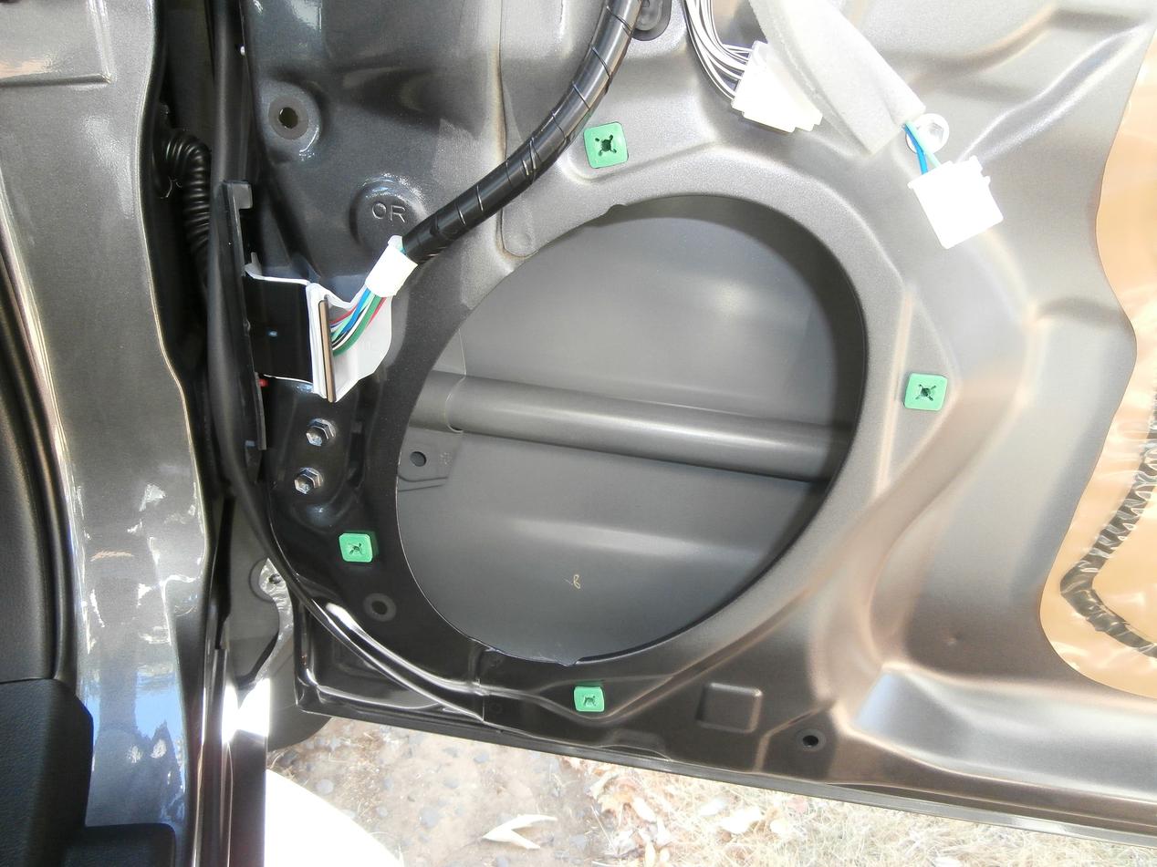

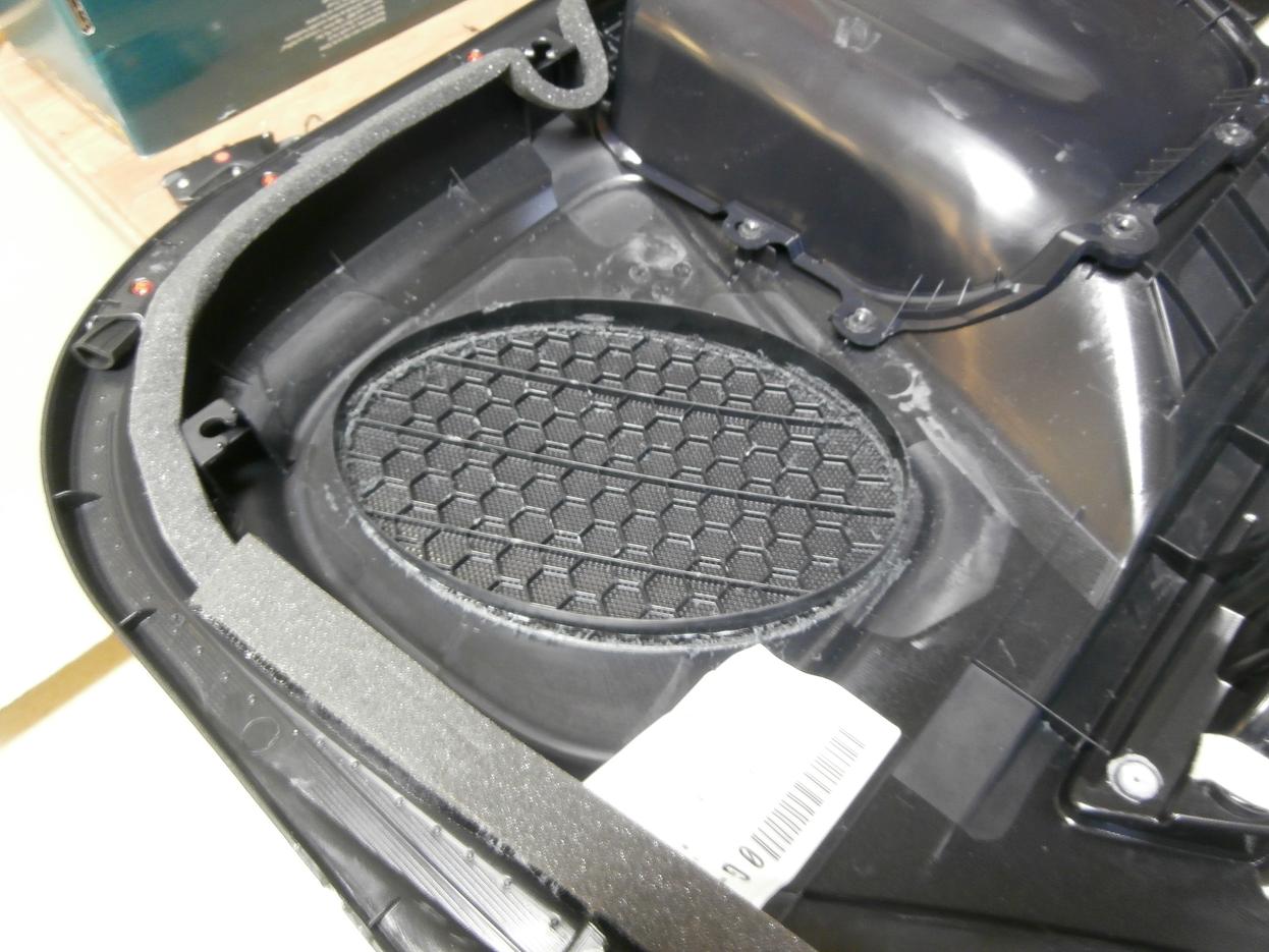

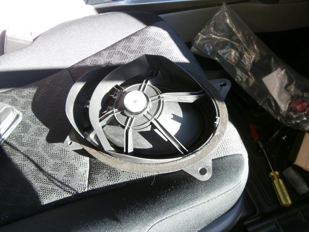

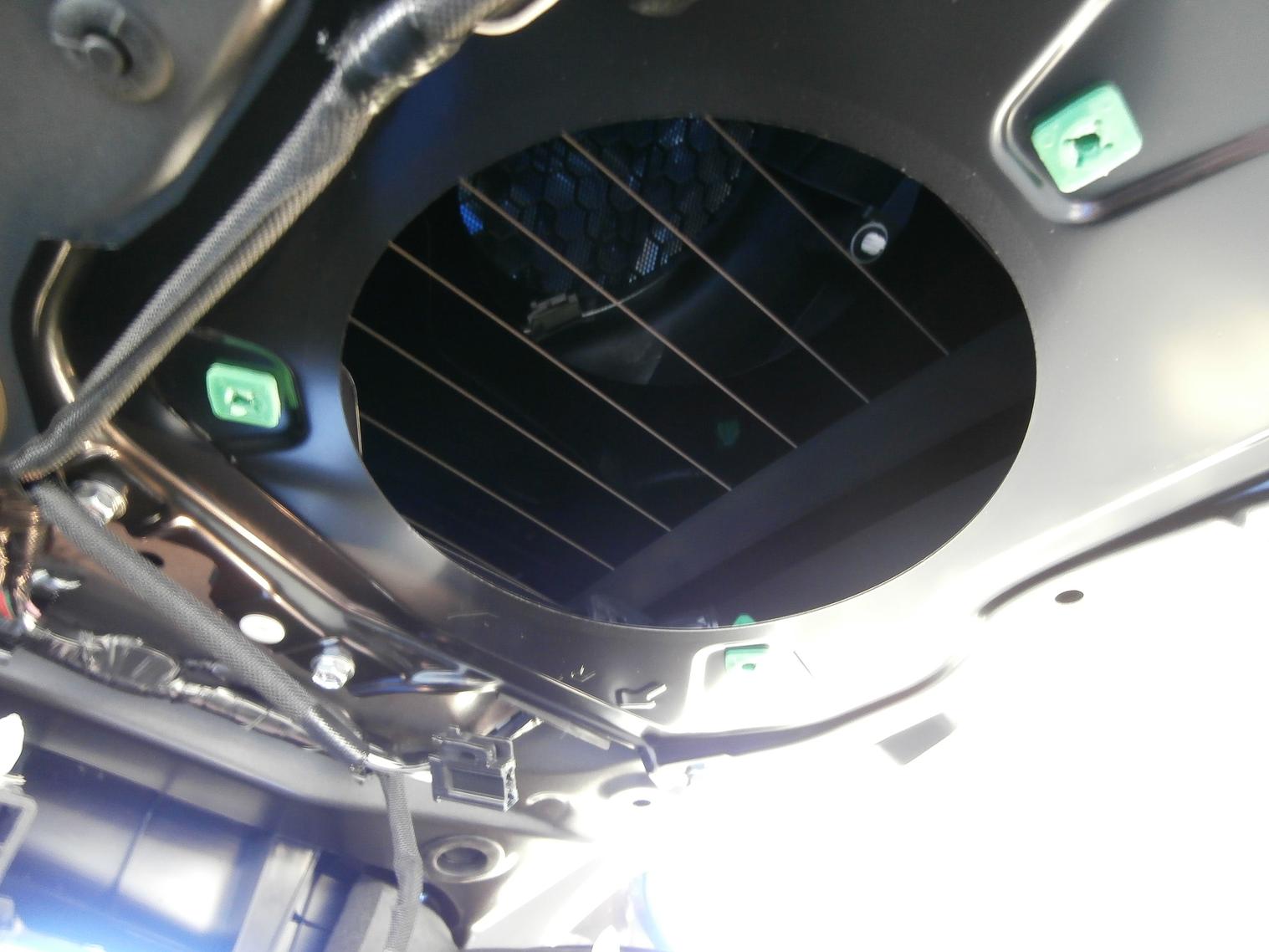

Now time for some pics:

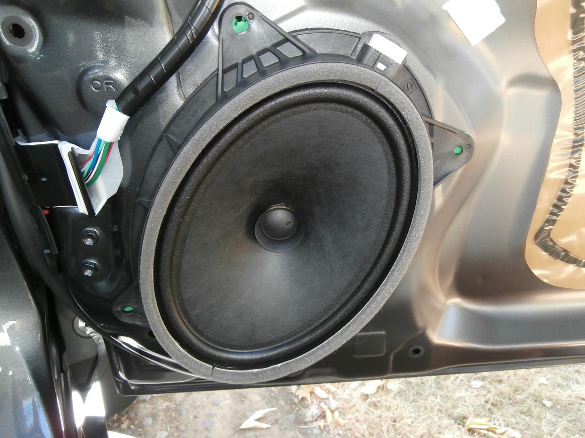

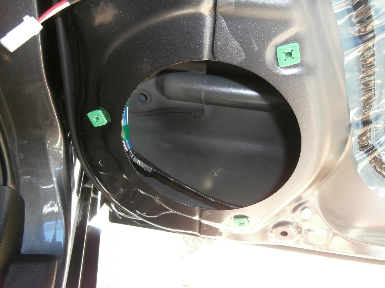

Factory Speaker in Front Door
6 x 9 Hole
Factory Speaker Rear View

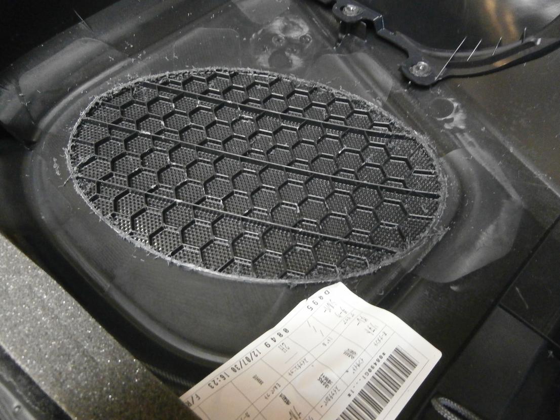

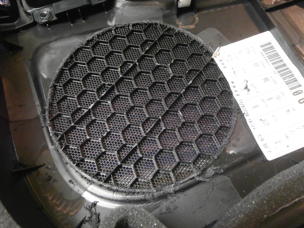

Front Door Panel Speaker Shroud
Speaker Shroud Removed

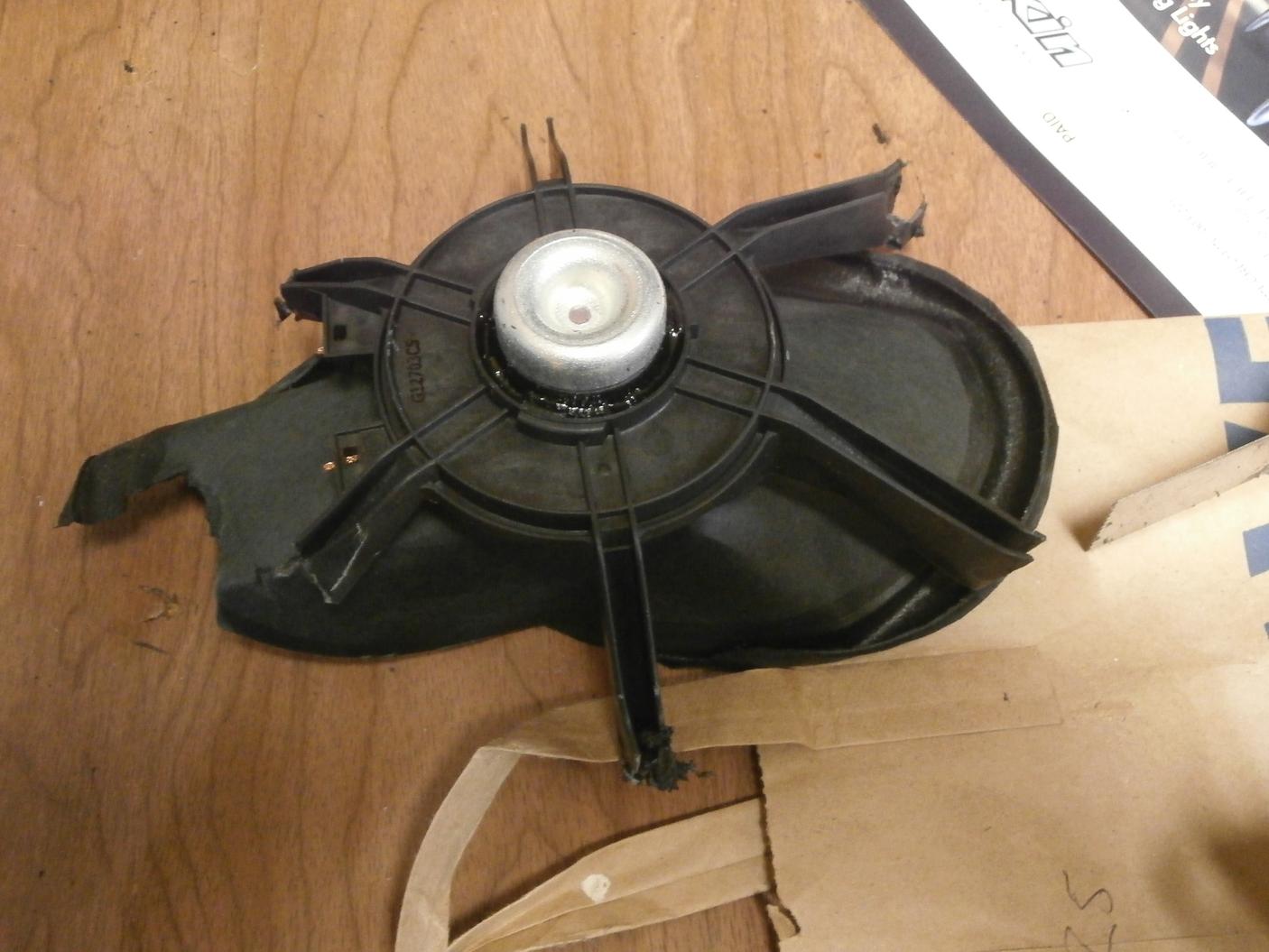

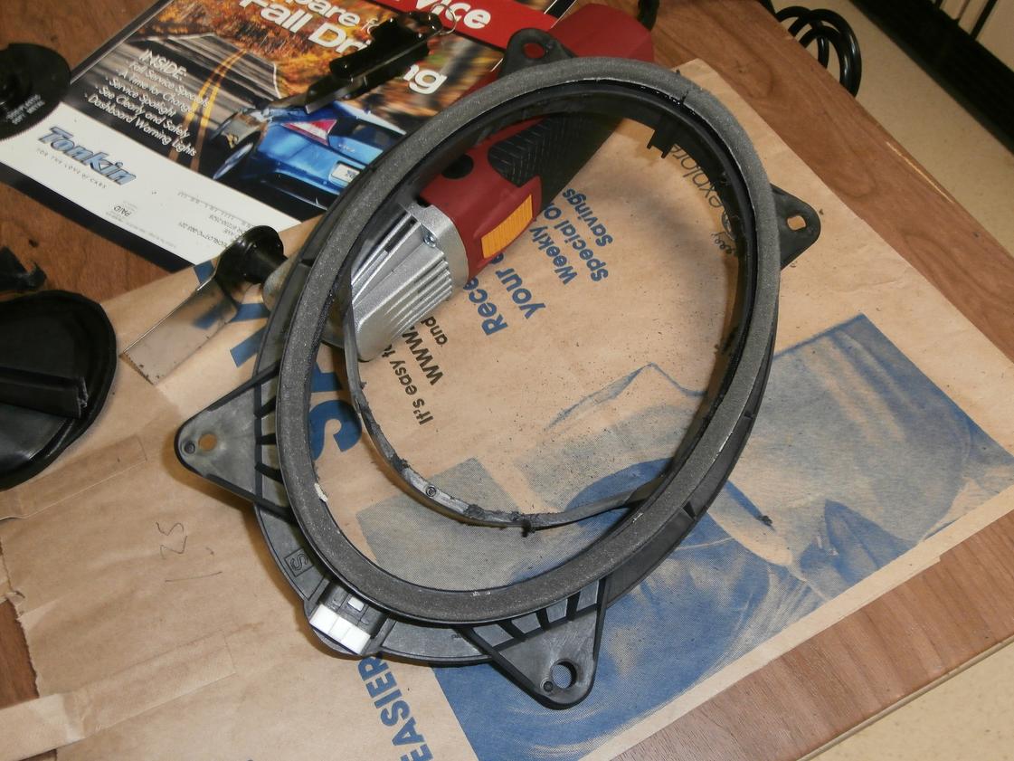

Dis-assembly of 6 x 9 Speaker
Internals of Speaker Removed
Speaker Mount Cleaned UP

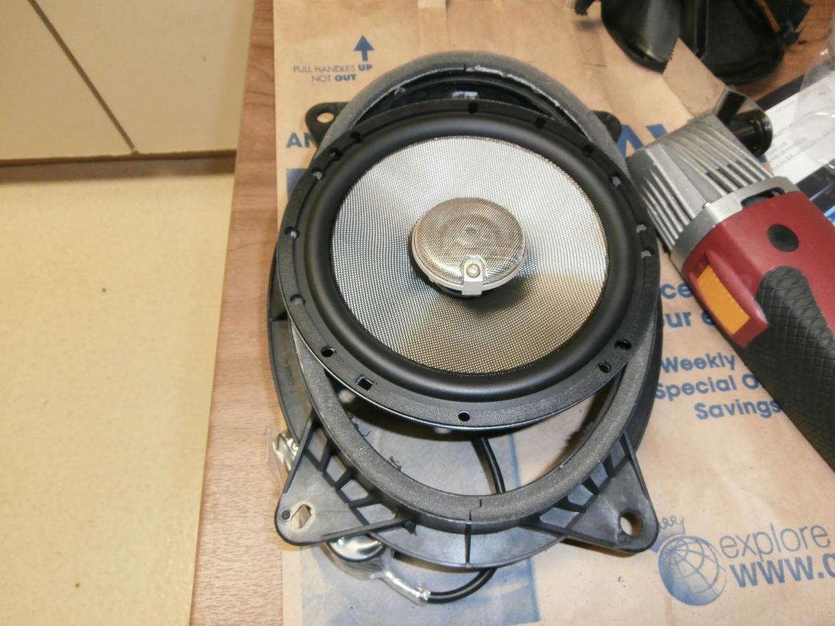

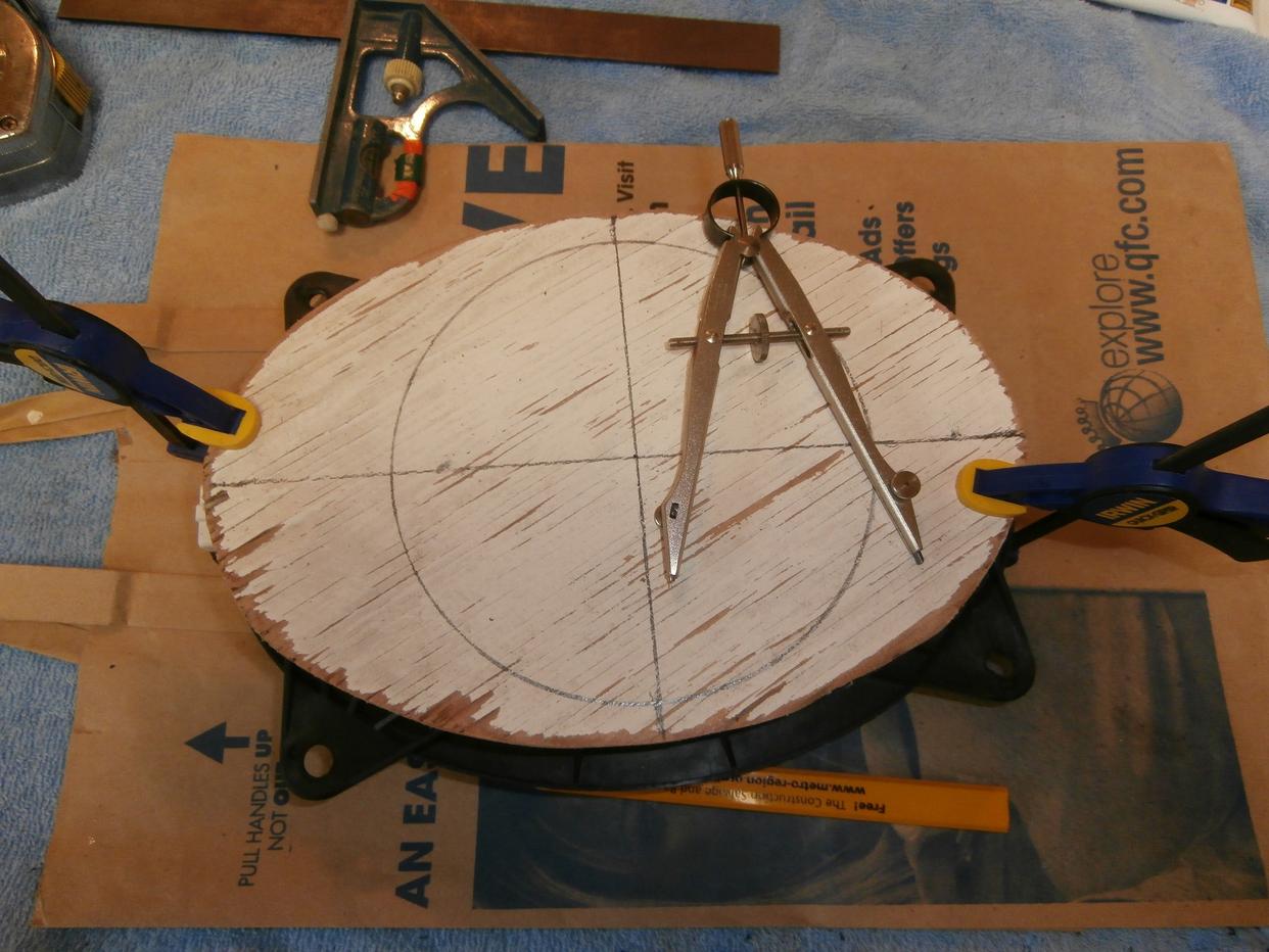

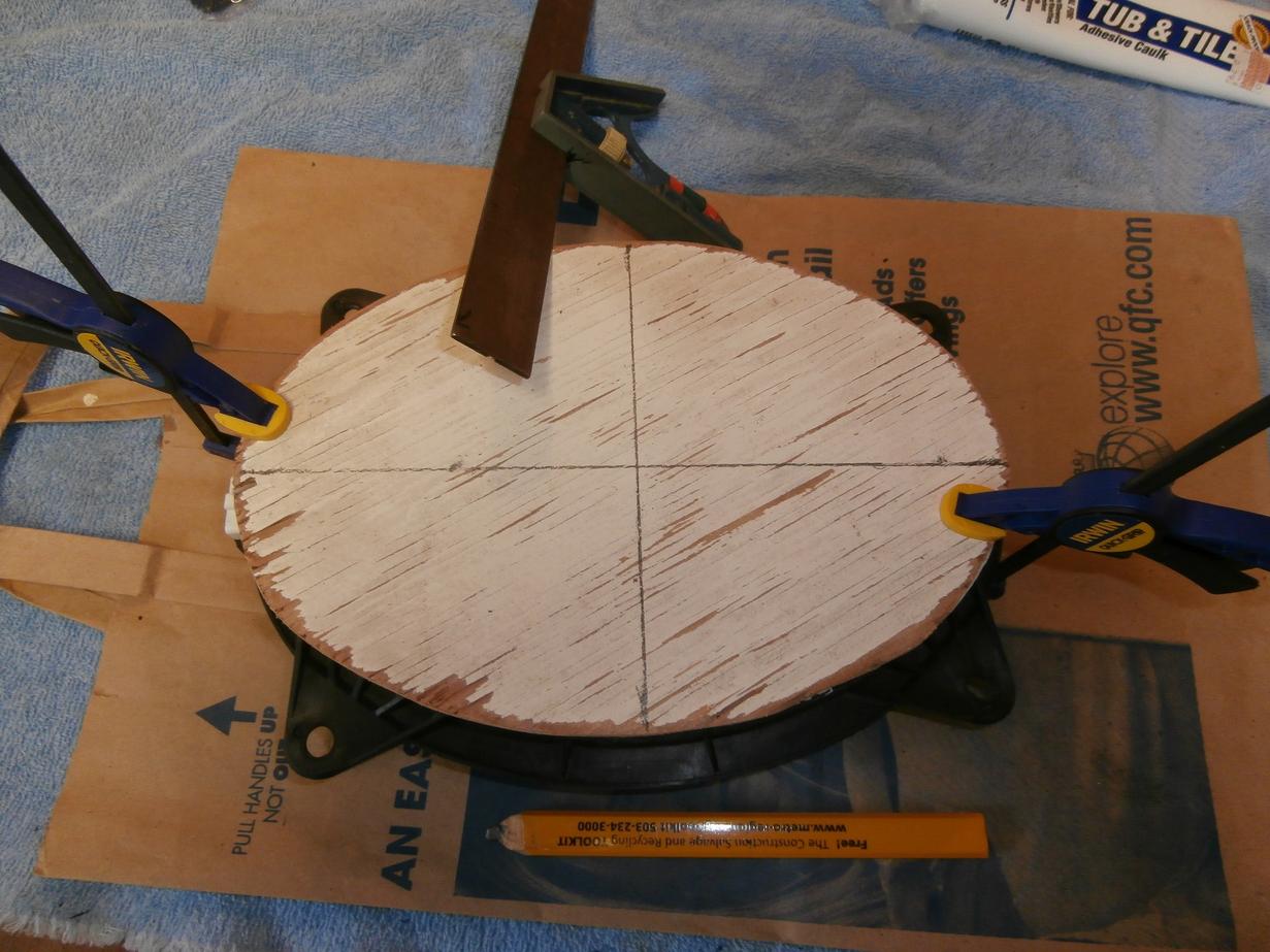

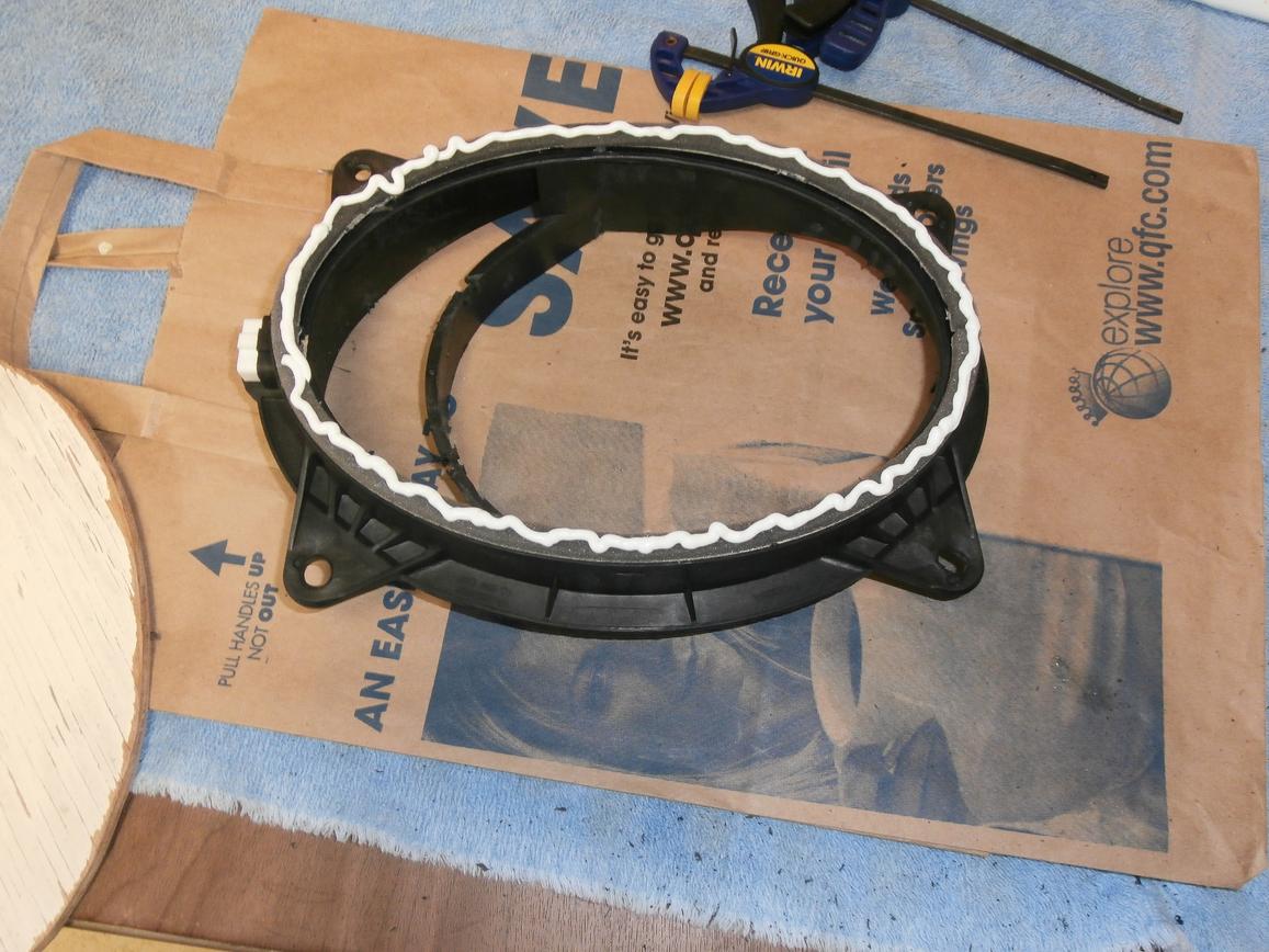

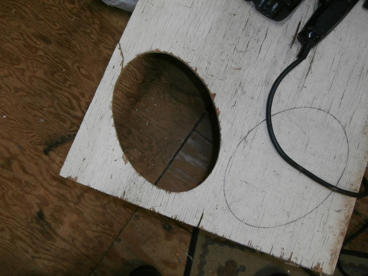

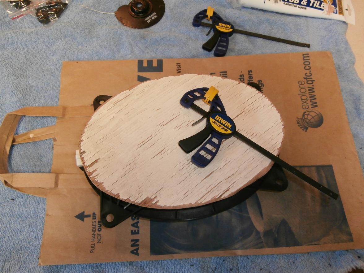

More 6x9 Pics...

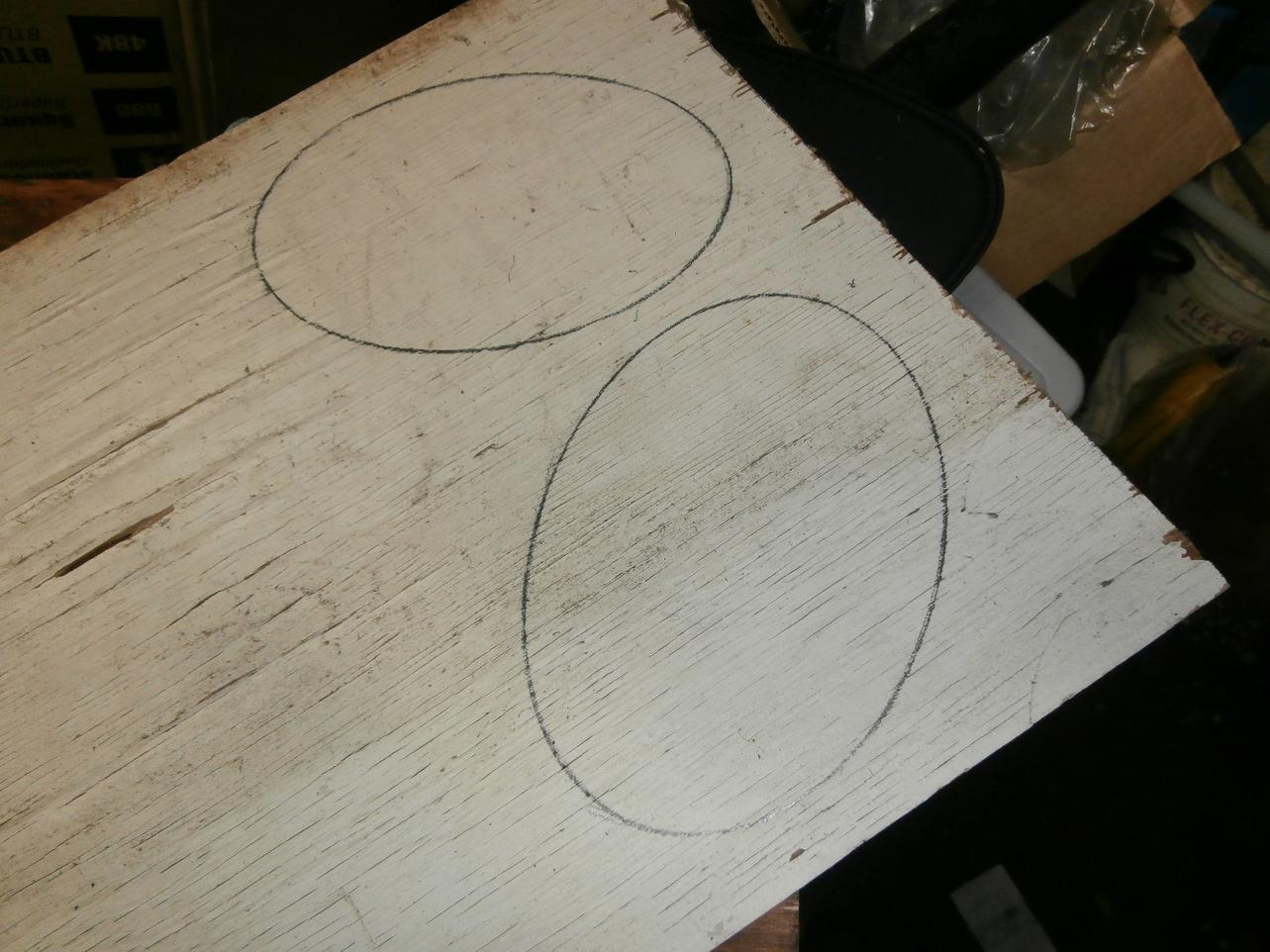

Sizing Up The New Kappa
1/4" Plywood Plates Ready for Cutting
One Done...
Two Done...
Speaker Mount Ready for Plywood

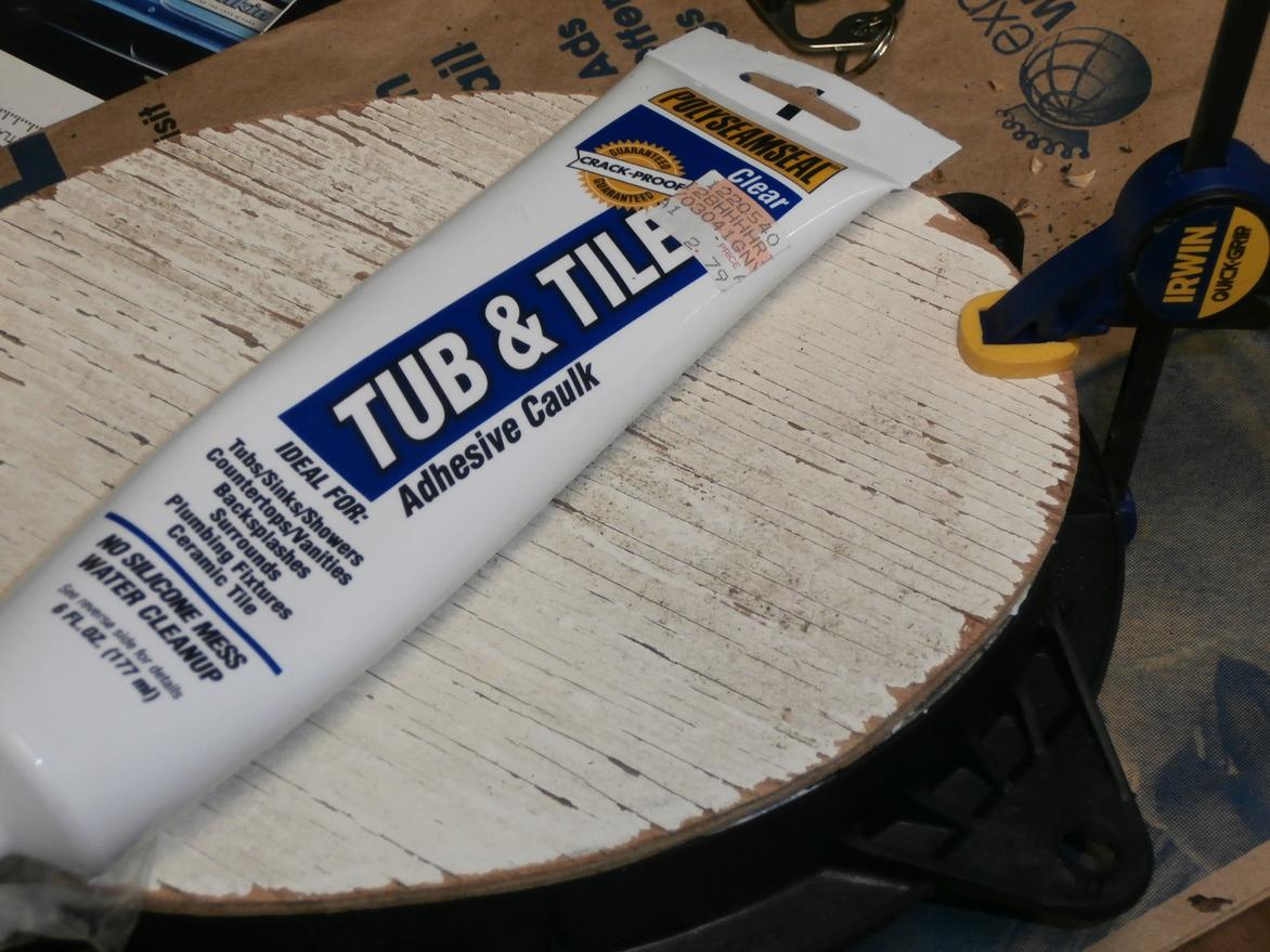

My Favorite Adhesive...
Ready for Clamps...
Waiting for Adhesive to Dry...Marking Center for Round Hole

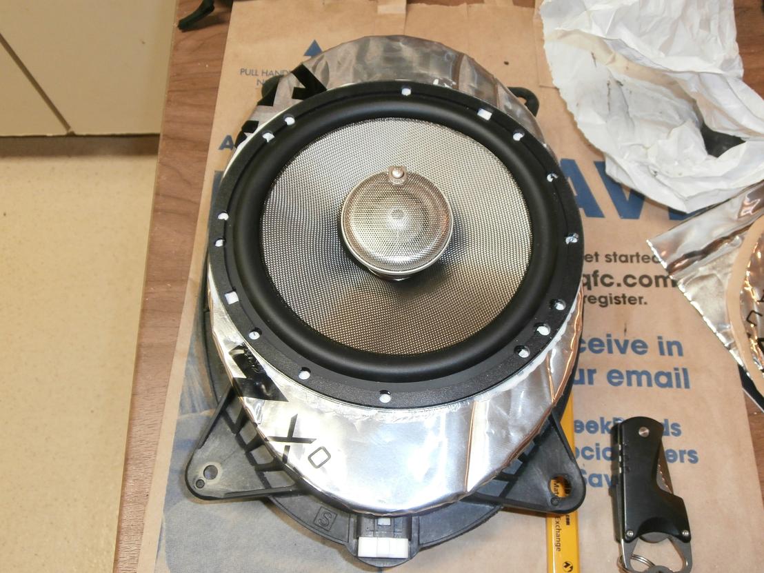

Yet, More 6x9 Pics...
A Very Usful Tool to Have...

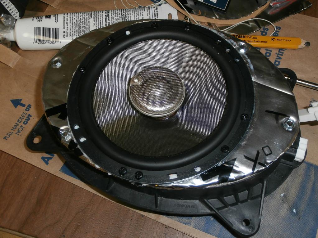

View from Inside...Good Adhesive Spread
Round Hole Cut, Plywood Covered w/ Sound Deadening Material, Speaker Glued Down
Ready for Mounting

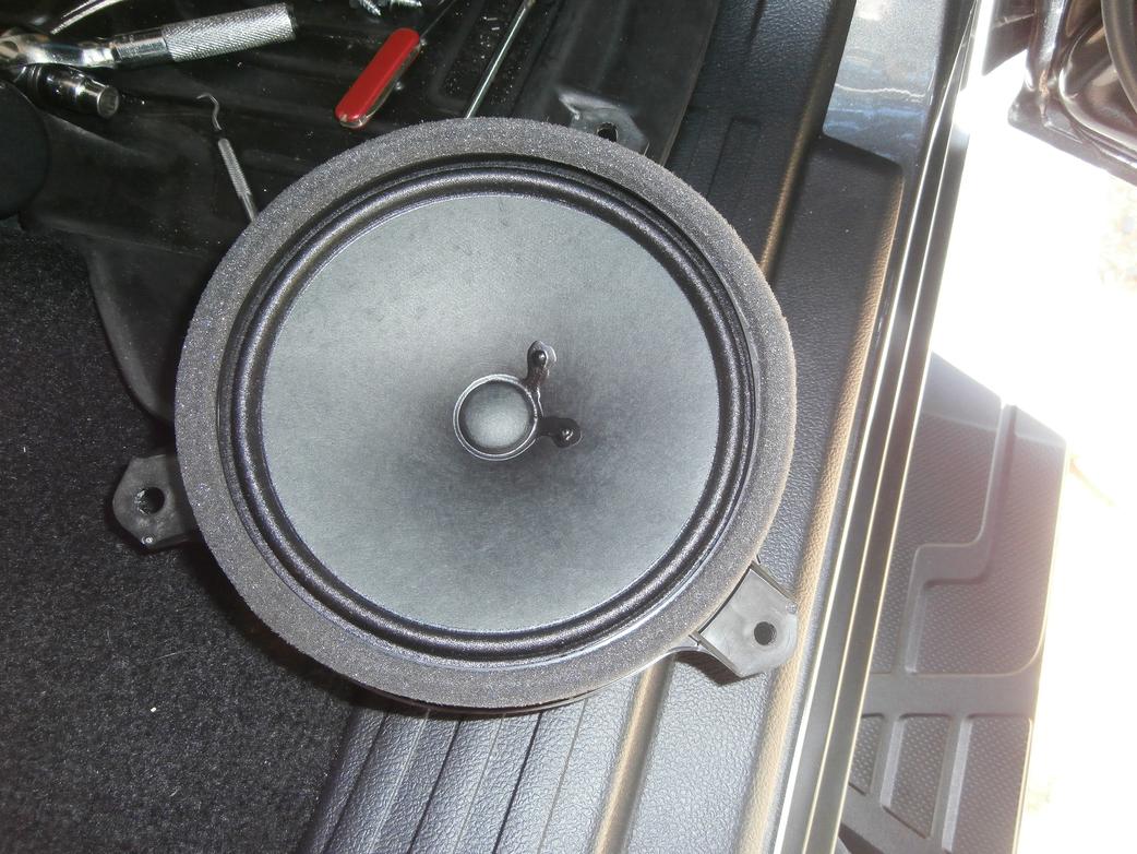

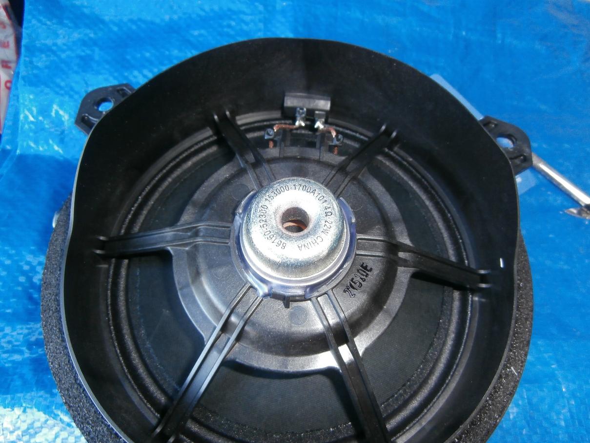

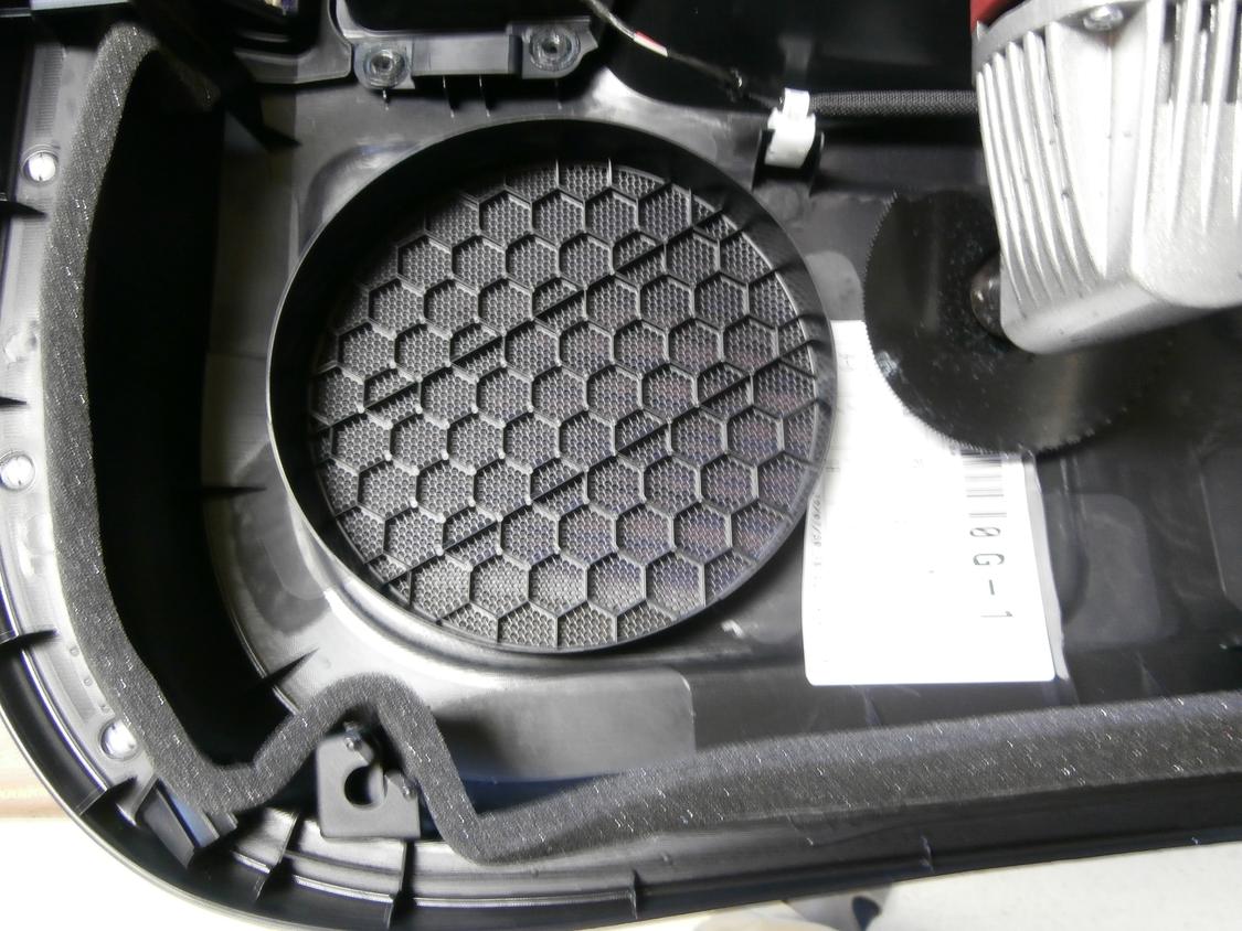

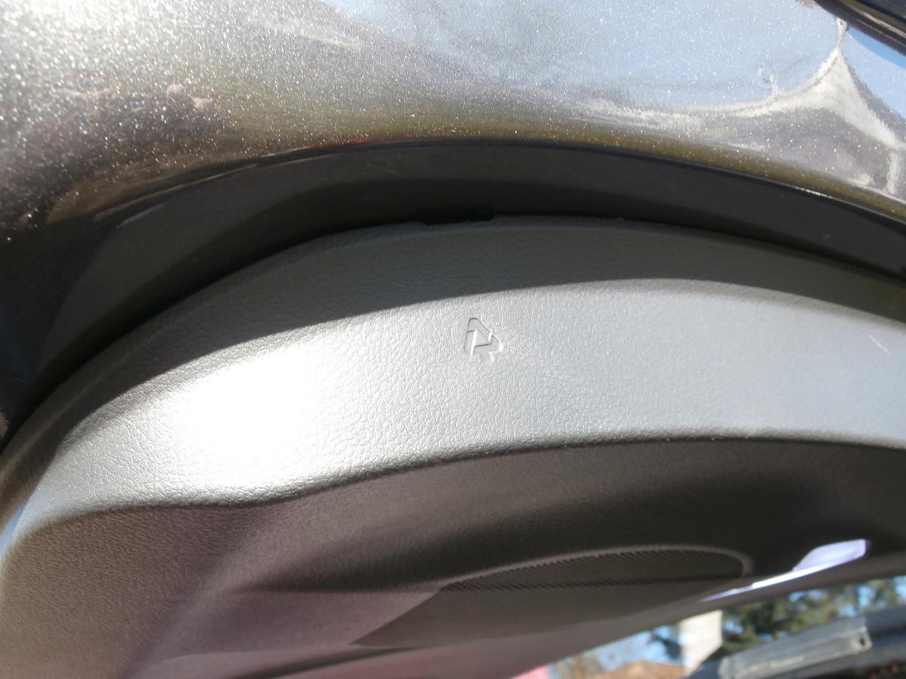

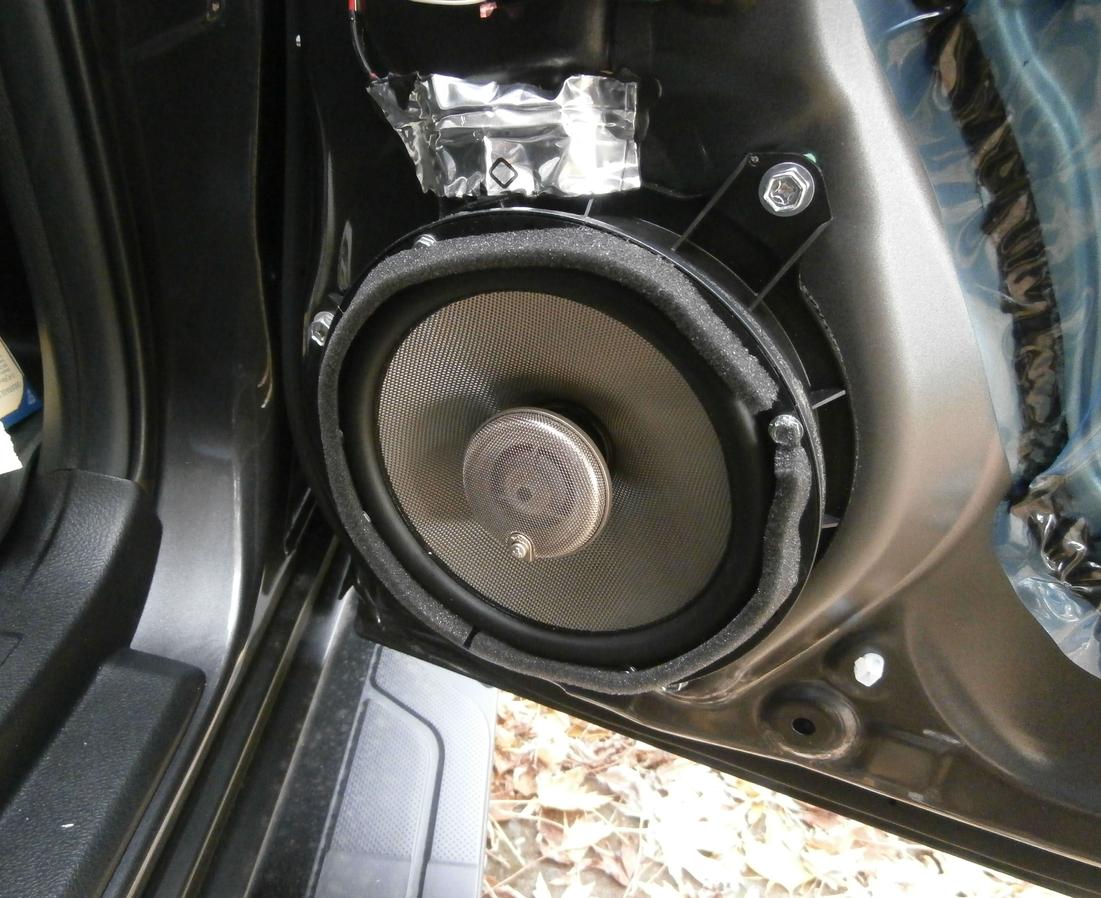

Now, the Rear Doors & Tailgate...
Rear Door Speaker Removed
Wimpy Factory Speaker
Speaker Shroud - Before
Speaker Shroud - After

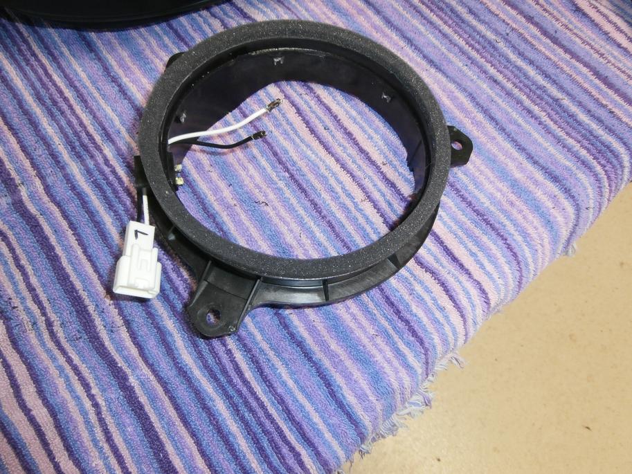

Factory Speaker - Before (Rear Door & Tailgate are Similar)
Factory Speaker - After (Rear Door & Tailgate are Similar)

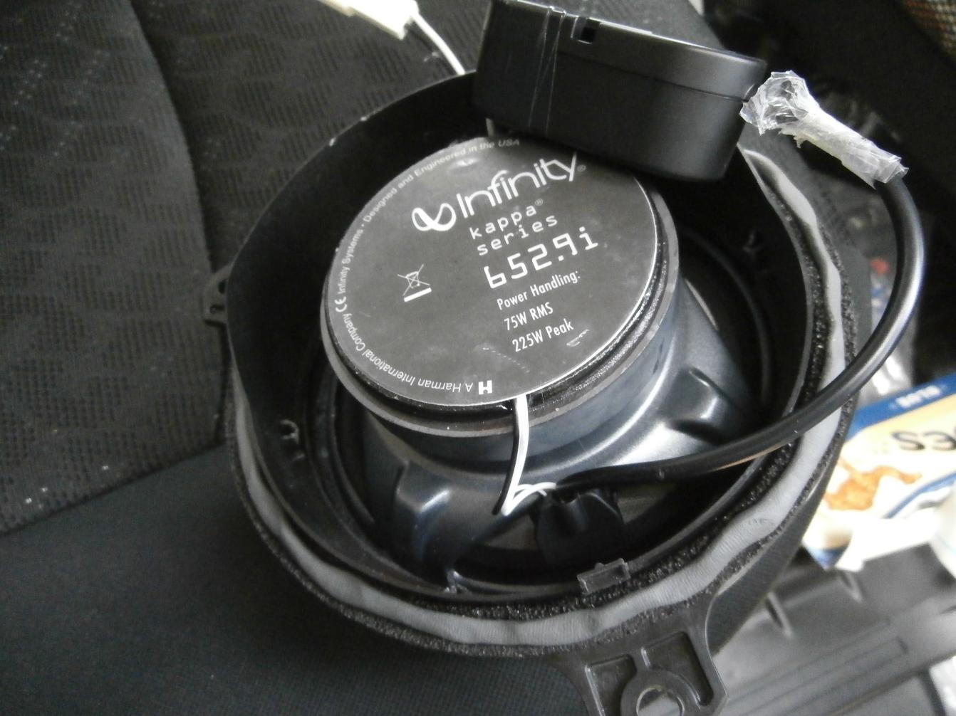

Glueing New Speaker to Factory Mount
Ready to Mount in Door/Tailgate...Note the Grey Duct-Seal Used as a Vibration Dampener
More Rear Doors & Tailgate...
Rear Door Speaker Mounted
This is Where You Start Removing Tailgate Panel (See Arrow)
Tailgate Speaker Removed
Factory Speaker From Tailgate
