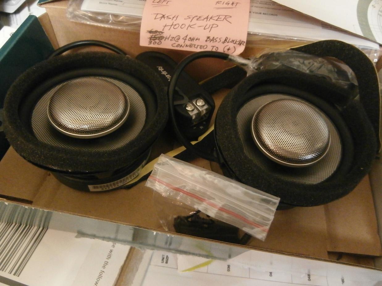

I noticed on the dash speakers some people use the bass blocker and some didn't need too.

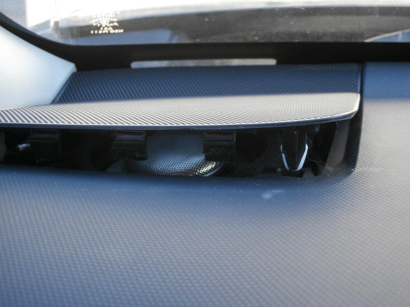

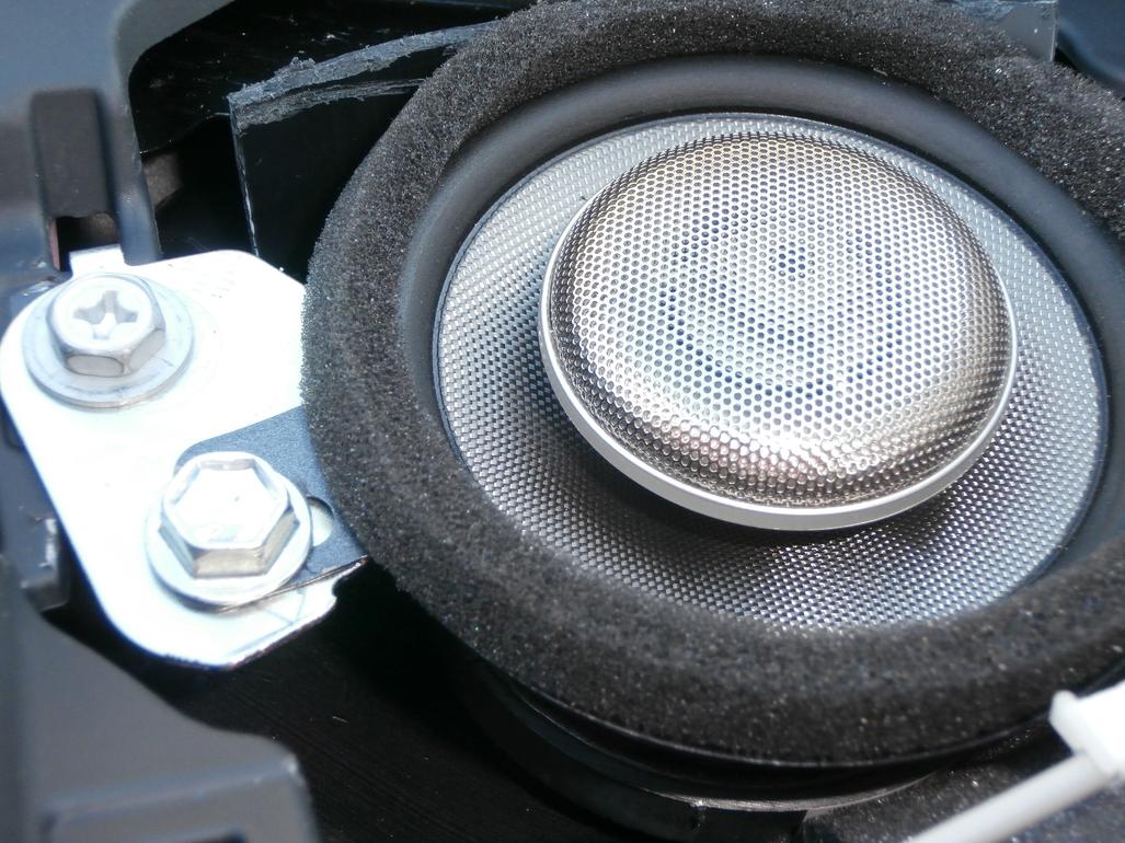

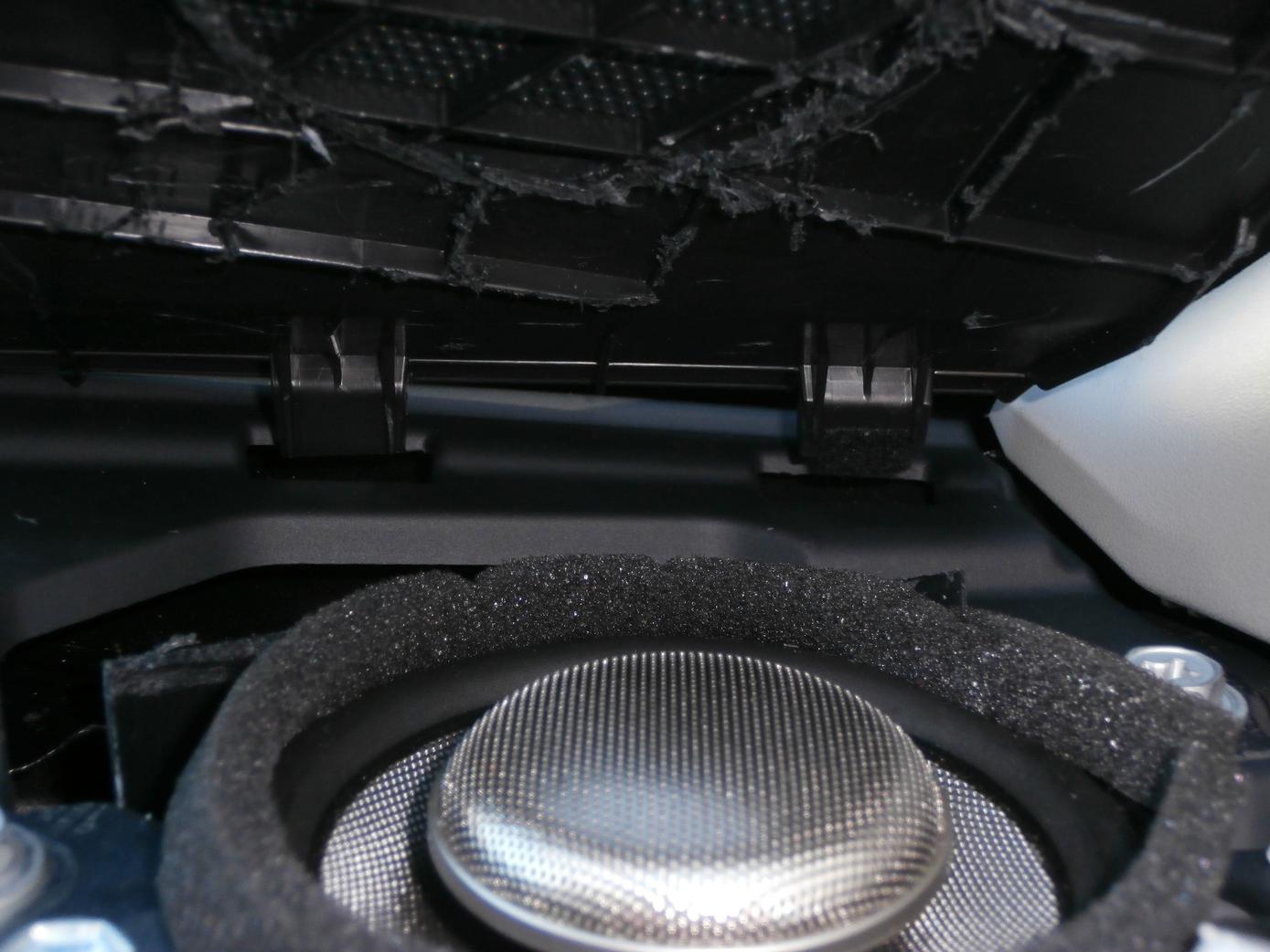

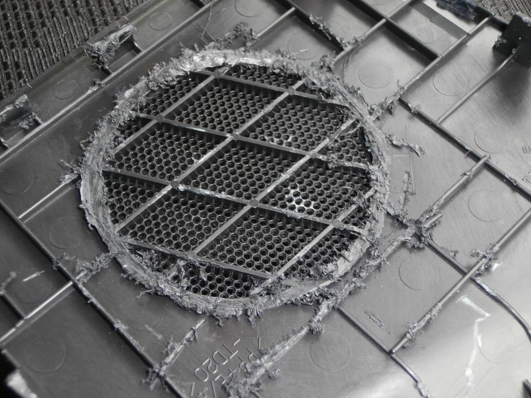

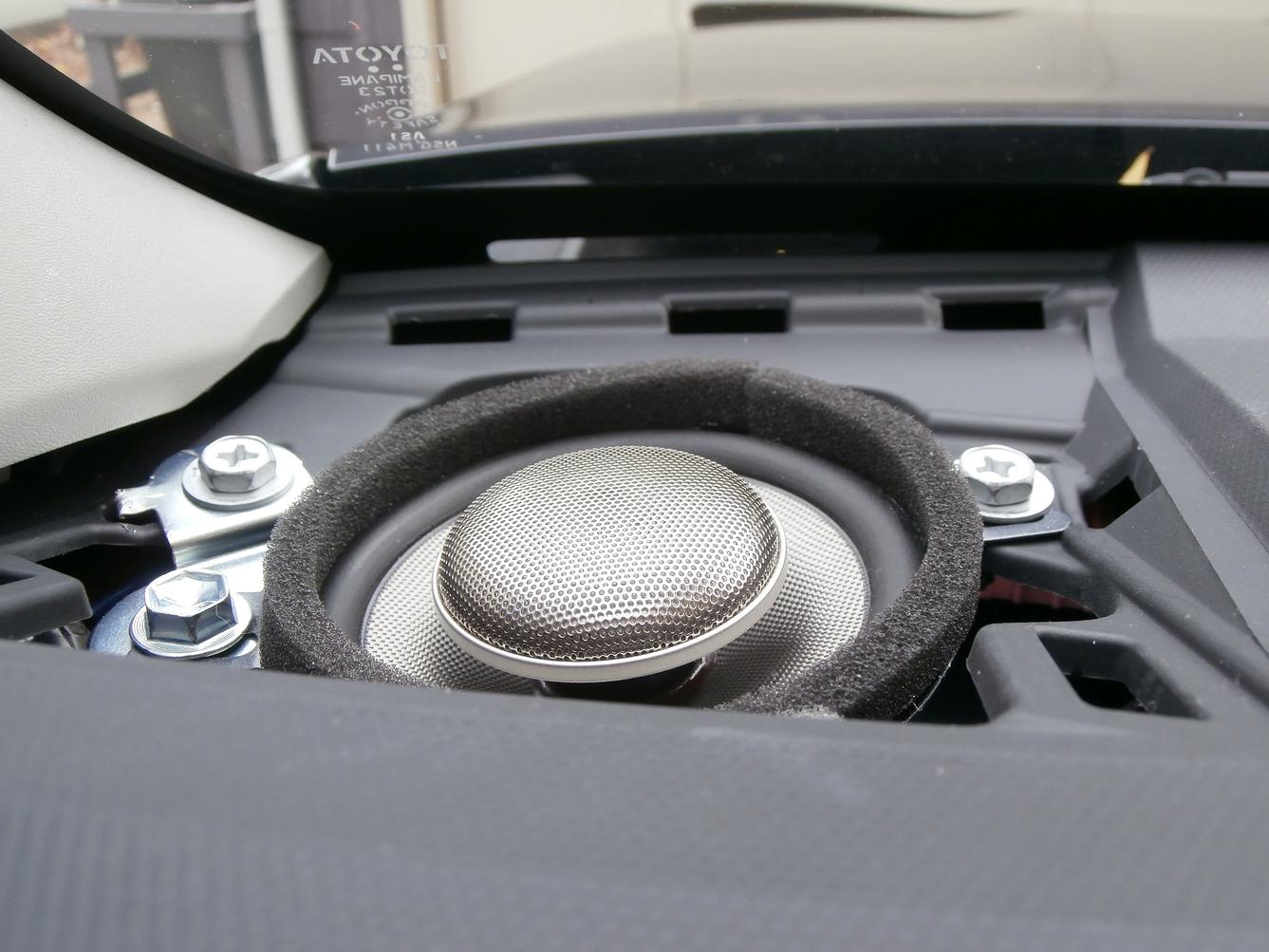

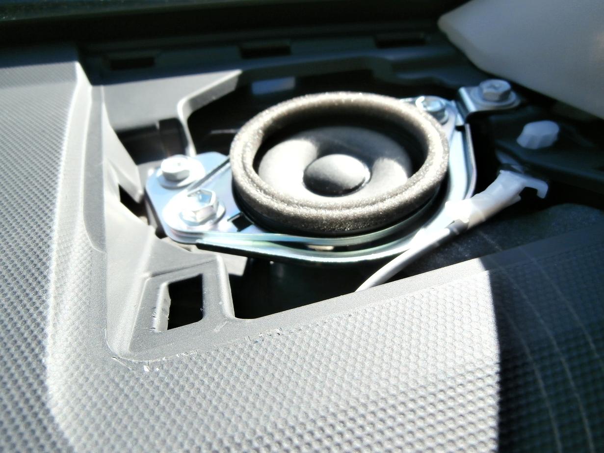

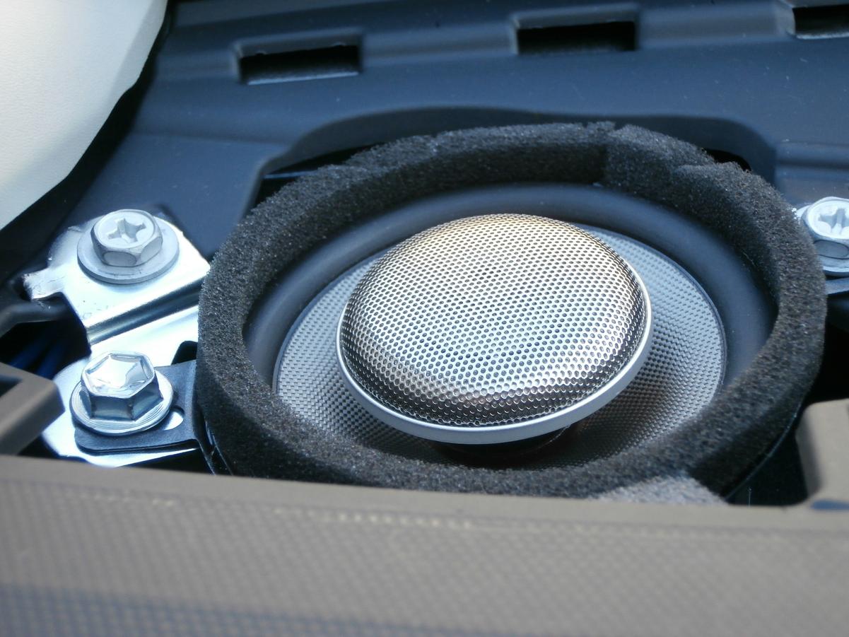

My install...

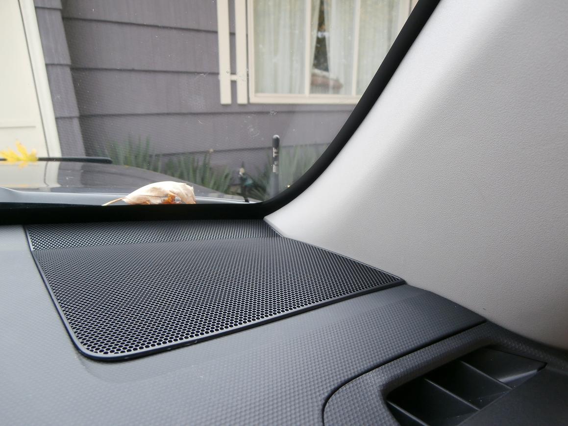

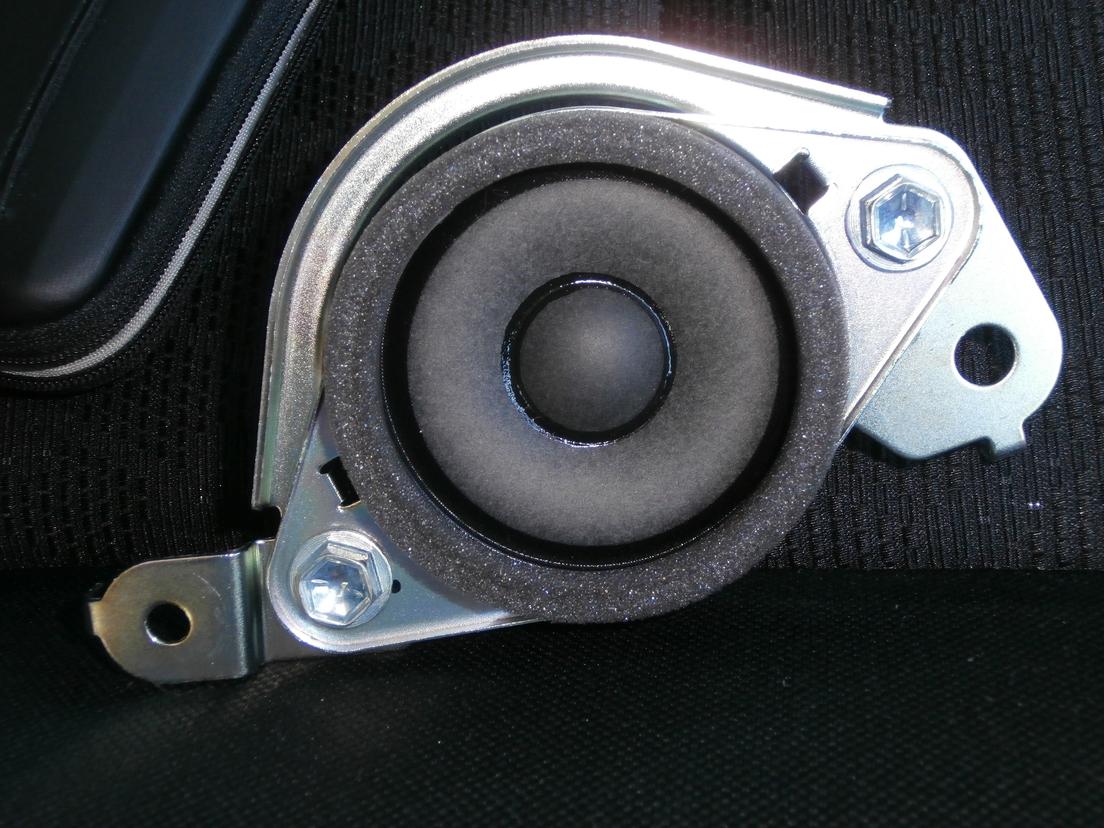

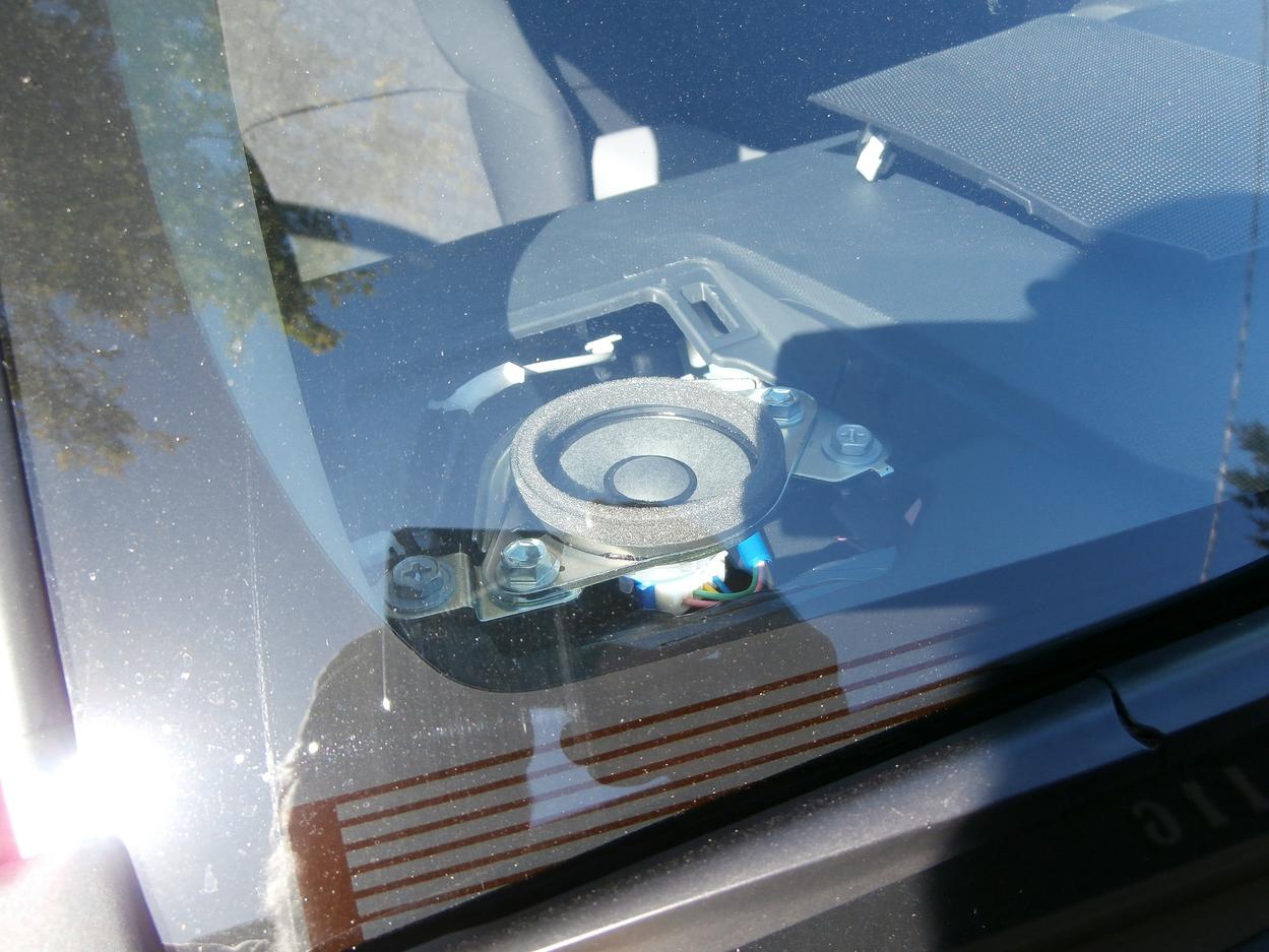

Factory Tweeter? Passenger Side
Another View

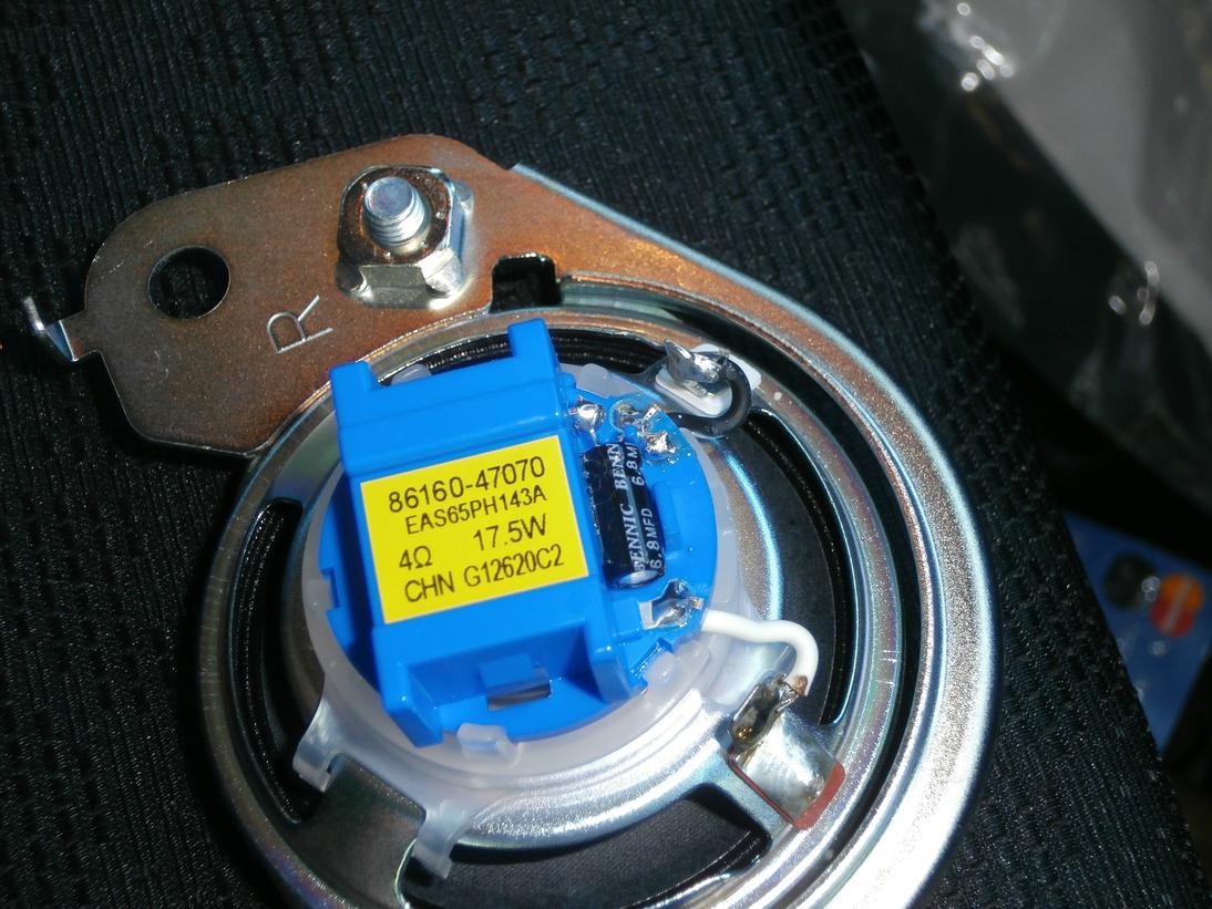

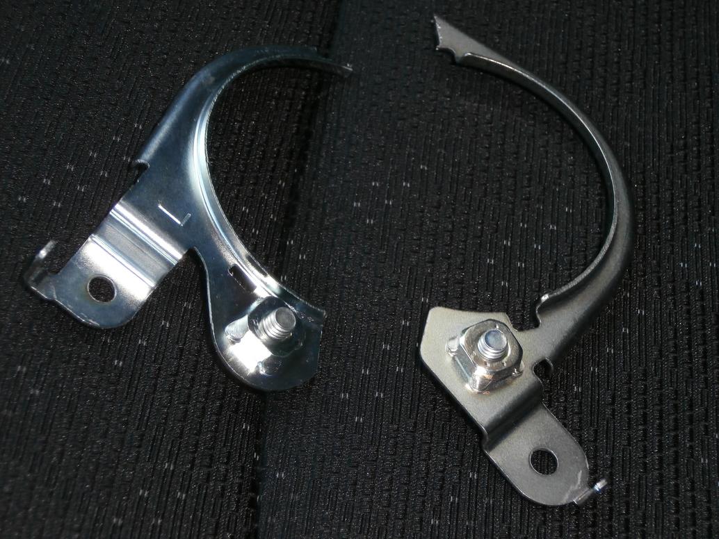

See That Blue Thing?...Don't Throw That Away!

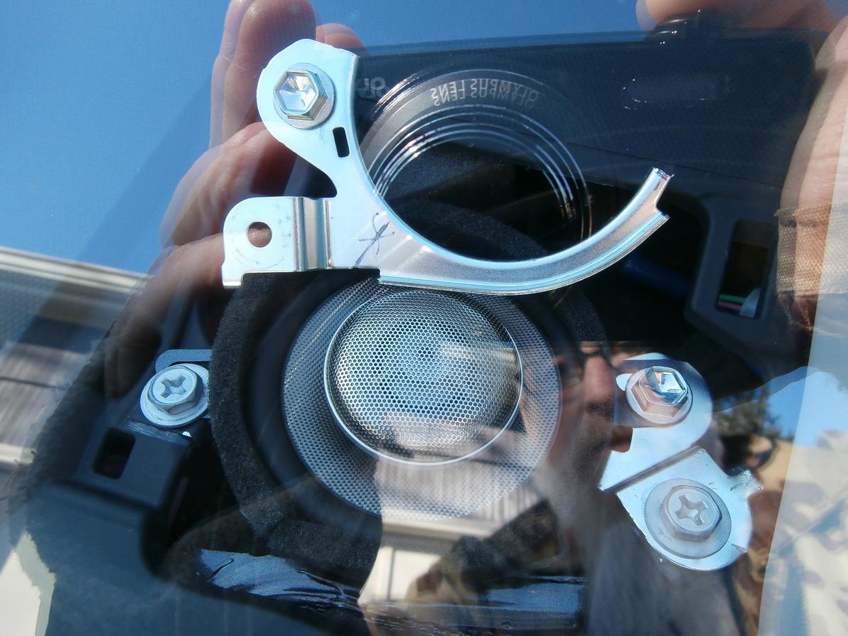

Closeup of Factory Bracket (Don't Throw Away The Bracket....You Will Need it Later)

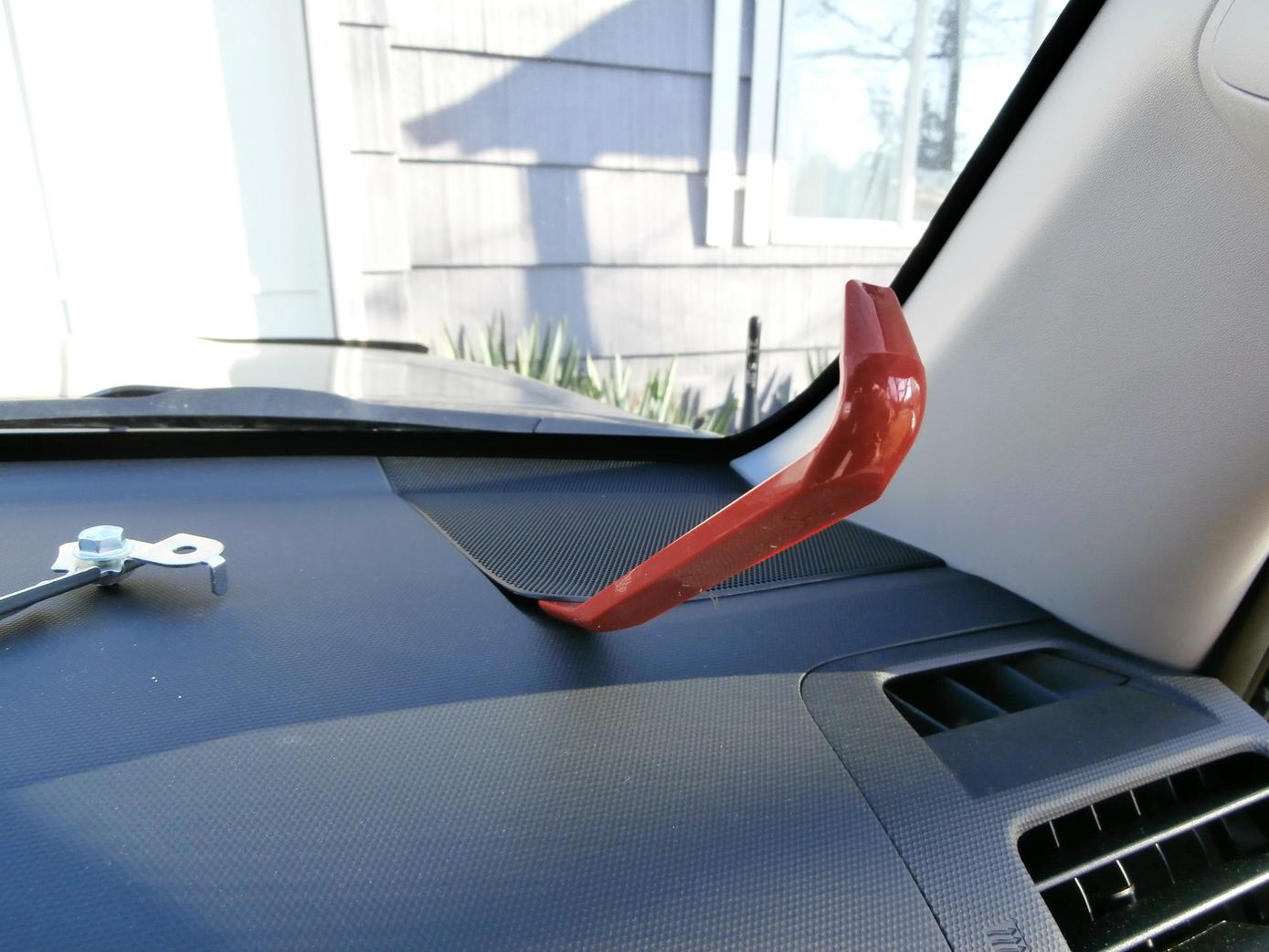

The Kappas...Plastic Ring Removed...Ready to Install

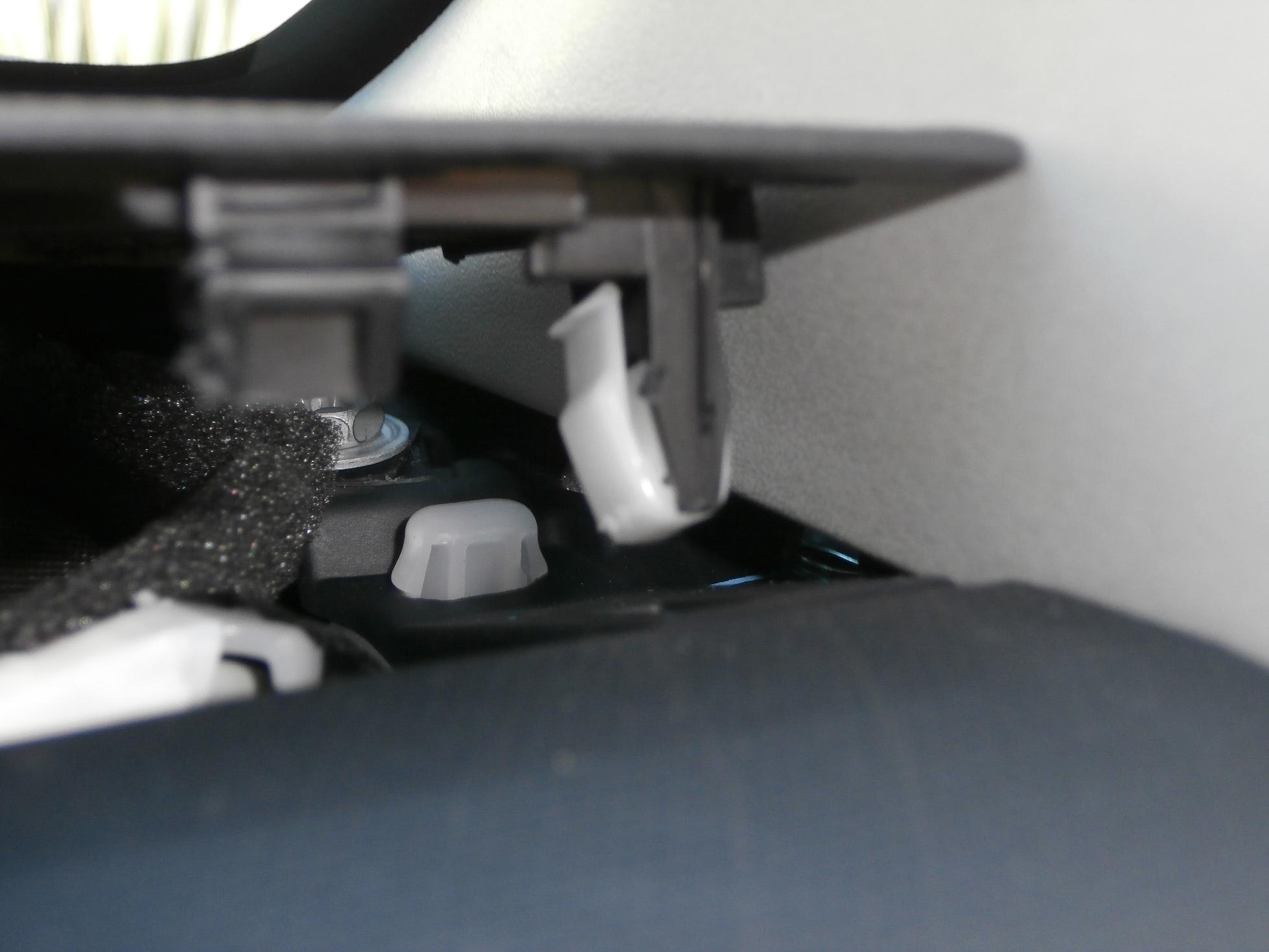

Shroud Removed From Dash Grille

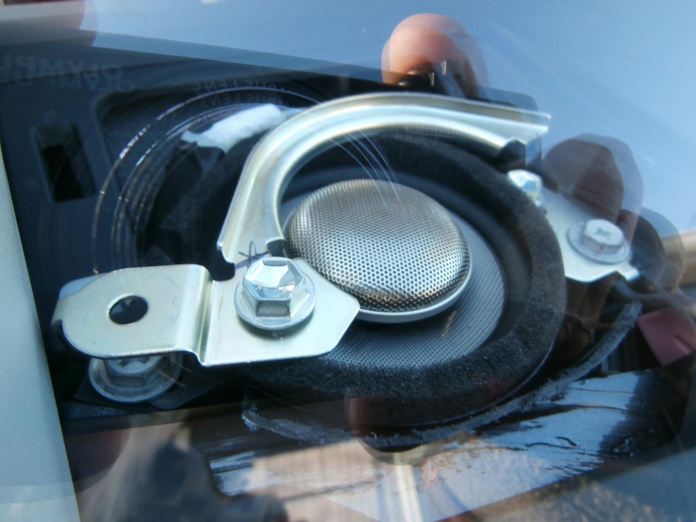

Kappa Installed...Driver' Side
Grille Installed...Passenger Side

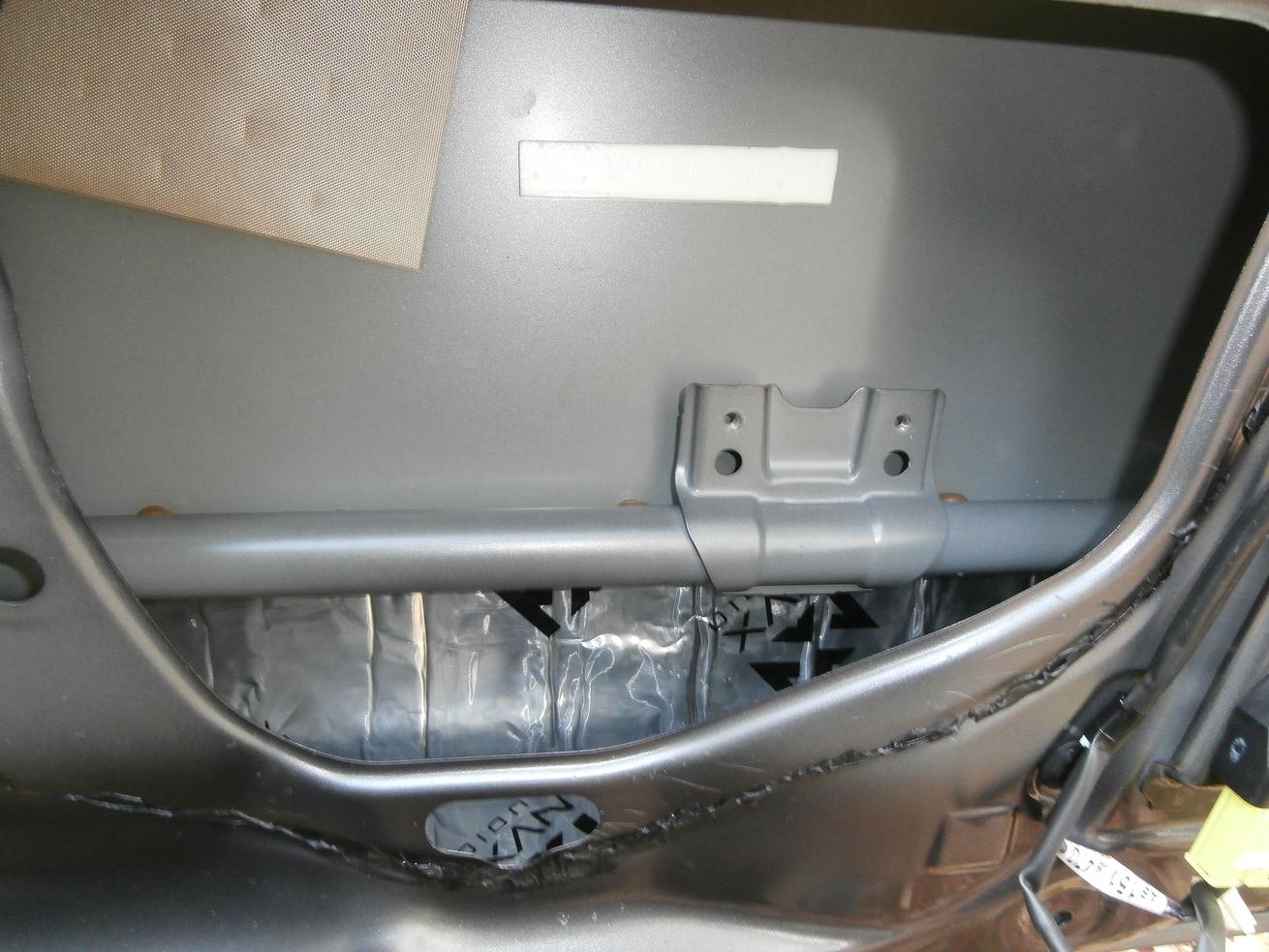

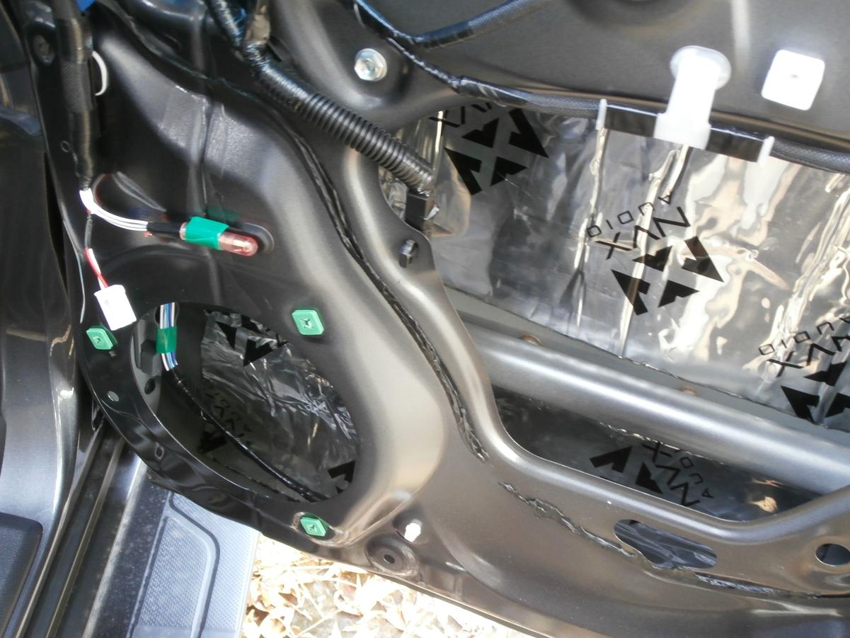

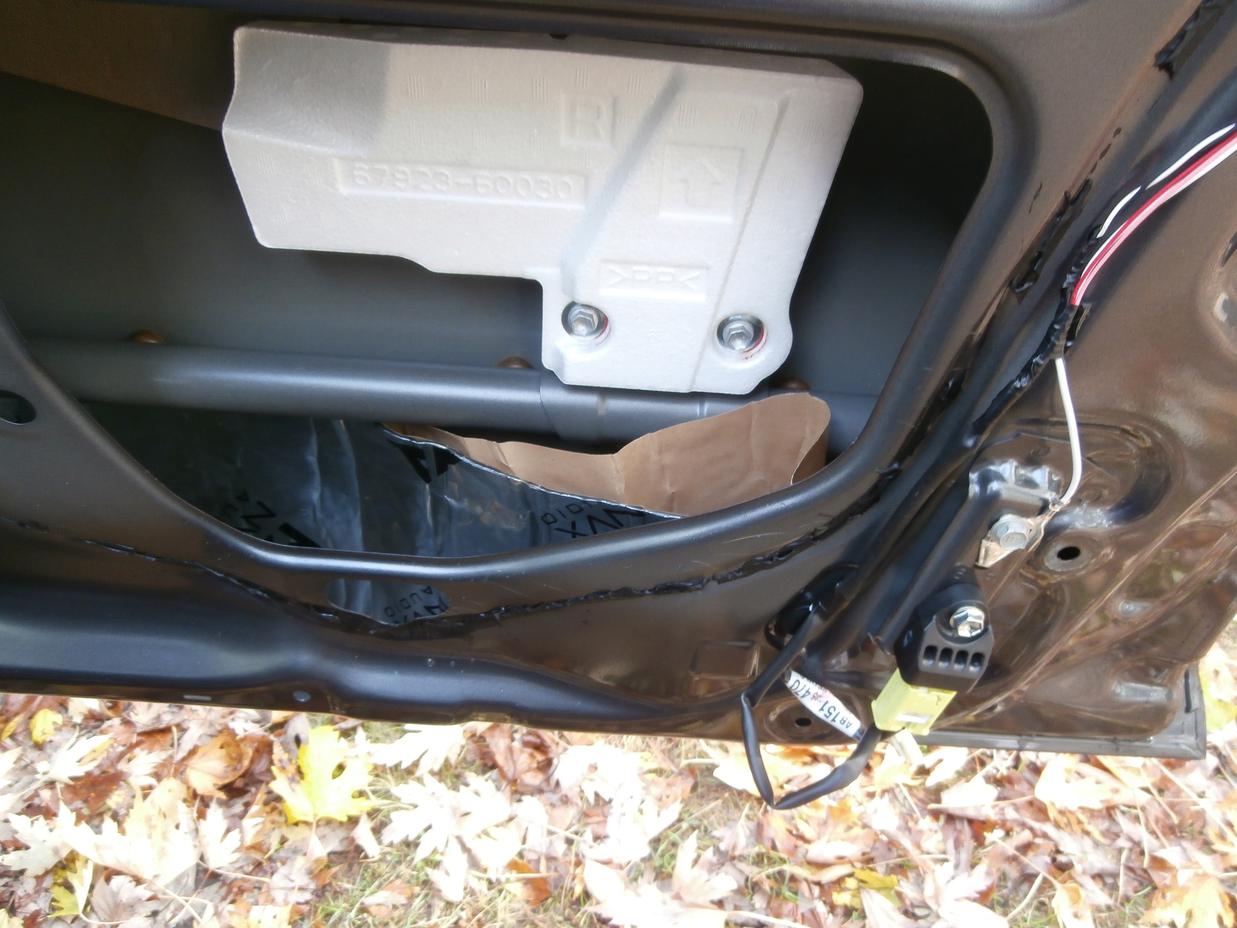

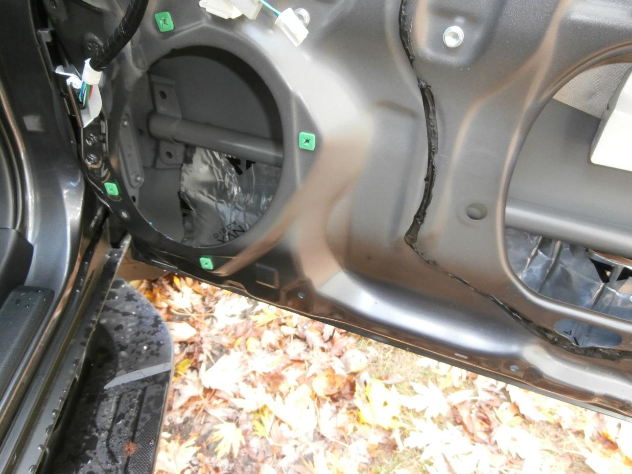

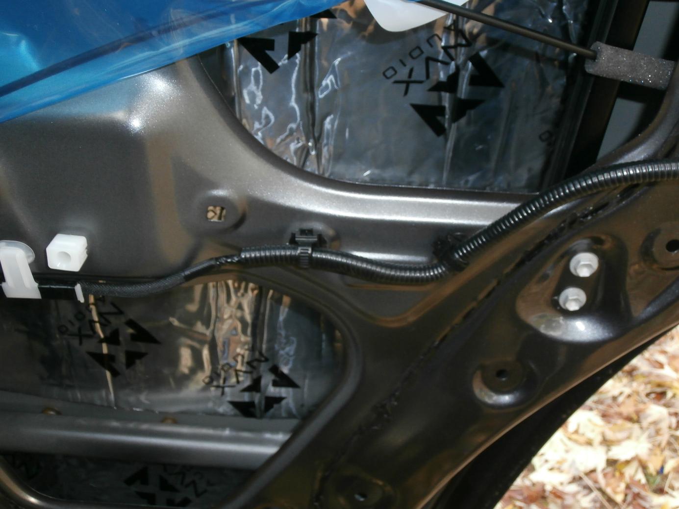

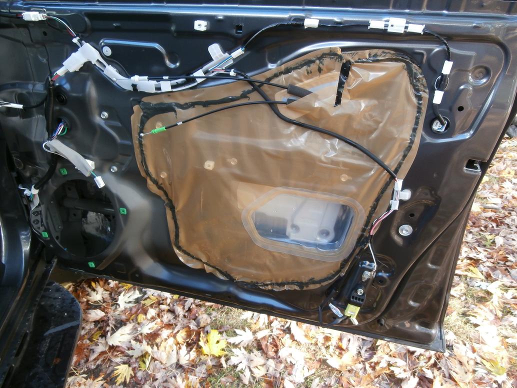

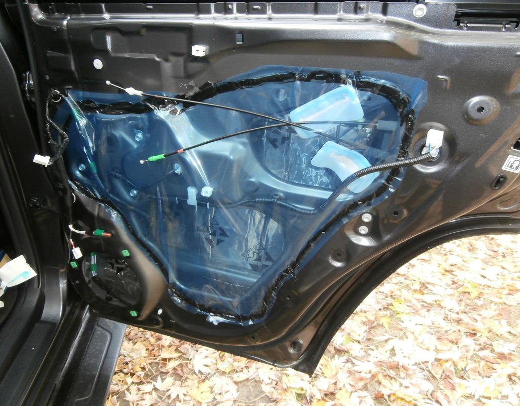

Sound Deadening Install

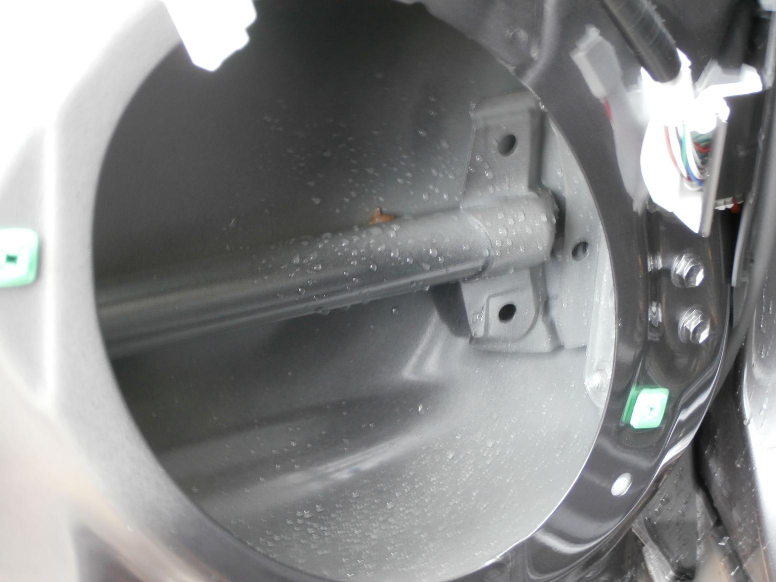

Driver's Side Front Door...Water Does Get in When it Rains
Pass Side Front Door Lower Section...Don't Block the Drain Holes at Bottom
Remove Styrofoam Block...Save for Re-installation
Place the Material Behind the Bracket
Upper Section Done...Don't Cover the Reinforcement Pipe
All Done...Vapor Shield Put Back in Place
Rear Door Finished
Ready for Speaker Install

JayBeeeeeee wow that's a lot of work... Thanks for the list of speakers... Want to make sure I get the right ones... And the correct adapters so that I do not have to cut the factory wires is great.... I wish it wasn't so difficult to swap out speakers... But looks like to do it right even if you cut out the factory speakers center and use the frame as a mounting bracket you still need to have some wood skills to make a mounting plate for each speaker... I guess always another excuse to buy a new tool....
You could get 6x9s for the front and just glue them like I did the Rear/Tailgate. The plywood plates were not that hard to do. Just put the factory frame on the board face down,
and trace around the outside of the speaker. Borrow a Scroll Saw from your neighbor and cut em out. They don't have to be perfect...nobody is going to see them after the interior
panels are put on.
Did you have any issues putting on any of the door covers/hatch cover? Wasn't sure if these speakers might stick out a little farther..
The new speakers did not stick out alot more than the originals. But I cut those shrouds off because the new speakers were slightly bigger in diameter than the factory ones,
was just trying to avoid any interference and did not want the new speakers touching the door panels at all.
The dash speakers were a different story though. They were a much tighter fit and needed as much room as I could give them. There is a plastic ring glued to the Kappas
that is fairly easy to remove if you are gentle and just give an easy twist.
Ya, I mulled over this for quite some time...did a bunch of reading on the subject. Decided to just go for it while I had stuff apart...no regrets so far. They sound great...
no popping as some have experienced.

Door & Tailgate Panels
There is a thread that shows this in detail...will link it when found.
Thanks to "sp8ball" & "Antman"...:hail:
http://www.toyota-4runner.org/774421-post389.html
You'll need to remove 3 screws before you can start yanking on the door panels. Be gentle
prying these covers open....the panels are very soft and scratch very easily.

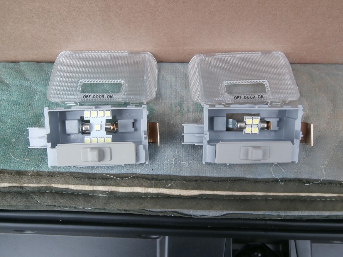

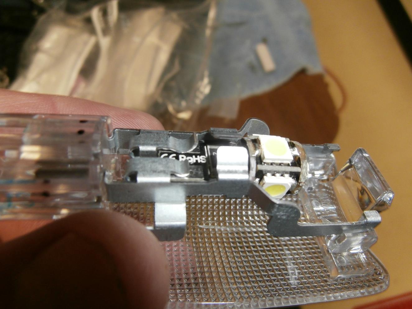

While you are in there, change light to LED.
https://www.superbrightleds.com/mor...bus-led-bulb-5-smd-led-wedge-base-tower/1127/
Door Lights (35 lumen)
The 1st time you remove the Tailgate Panel, it will be tight. There is an arrow molded into
the lower/passenger corner. This is where you start pulling.
While you are in there, disconnect the tailgate cargo lights and install led panels.
Cargo Area Lights
The one on the left...(140 lumen?)
https://store.ijdmtoy.com/ProductDetails.asp?ProductCode=LED_9SMD_D31_SKU24
The one on the right...(70 lumen)
https://www.superbrightleds.com/mor...-bulbs/de3175-led-bulb-4-smd-led-festoon/238/

Re: bass blocker a Ya, I mulled over this for quite some time...did a bunch of reading on the subject. Decided to just go for it while I had stuff apart...no regrets so far. They sound great...
Agree. In line with sending frequencies to proper drivers and blocking those from drivers not meant to reproduce them. For example, bass sent to tiny dash speakers will sound like pops. These are best sent to heavier, wider cones of a woofer/sub-woofer.

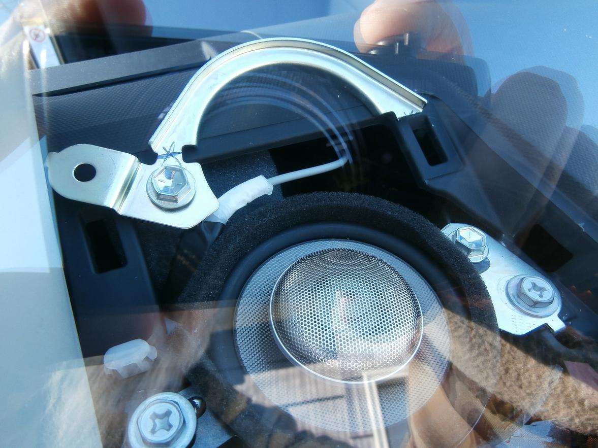

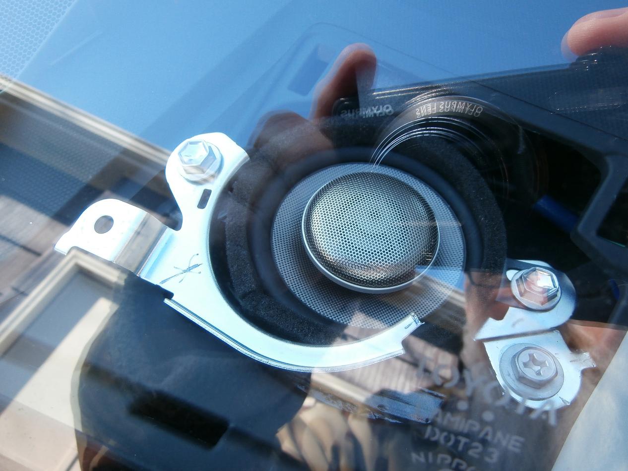

Mounting Dash Speakers
The 3.5" Kappas are a tight fit and trying to use the provided mounting holes won't work unless you can fabricate some sort of strap.
I found that the existing factory brackets could be trimmed with a hacksaw to make the install much easier.
Here are some pics, LH (Drivers Side) & RH (Passenger Side) I took after they were installed. But I set what was left of the factory
bracket next to the Kappas so you could see which end was used. The LH & RH factory brackets are not symetrical, i.e. not mirror images.
The Factory Mounts....The One on The Left Taken FRom The Driver's Side
RH-Removing Grille...
RH-View From Ourside....Bracket on Speaker
RH-View From Outside...Bracket Next to Speaker
RH-View From Inside
RH-Re-Installing Grille
RH-Grille Installation...Careful to Not Let it Rub Against The A-Pillar. It Will Leave a Mark!

LH Side Dash
Driver's Side...
LH-View From Outside...Bracket Positioned on Speaker
LH-View From Outside...Bracket Next to Speaker
LH-View From Inside
LH-Grille Re-Install...Don't Let it Scratch The A-Pillar!
Another View

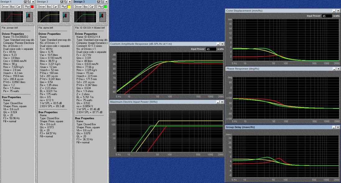

still working out the the best sub to install in the factory enclosure/ may require additional depth gained by using spacer rings under factory cover and/or possible cutting factory cover open and using spacers right up to the factory exterior
Possible options
Image Dynamics ID8 D2 V.3 85.4db sensitivity
alpine SWR-8D2 83.5db sensitivity
Kicker solobaric ( Square) 83.6db
Pioneer TS-SW2002D2 Shallow Mount 86db sensitivity most efficient
Helix Esprit E8W 85db
