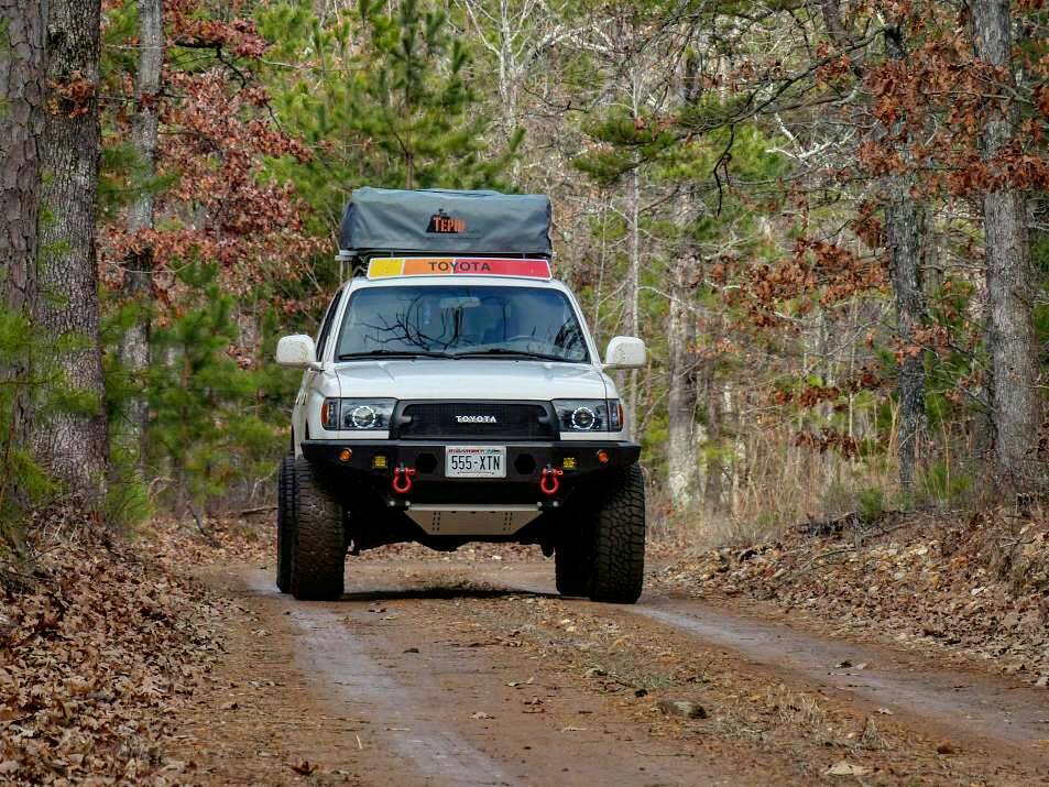

Alright peeps, school me.
After my first solo trip with the Iceberg, I'm starting to weigh the benefits of throwing a winch in my 4xinnovations front bumper. I always thought that i wouldn't be doing any serious crawling with my rig, hence, no immediate need for a winch, but after a sketchy scrap with the mighty Missisippi trying to flood my campsite and keep me from getting out of the river basin, I think it may be good insurance.
With that thought in mind and the fact that I likely won't be using this too much (maybe? :shrug: ), I'm looking at inexpensive winch options with synthetic rope to keep weight down and to eliminate having to use a roller fairlead (since I am in Wisco and we need a front plate).

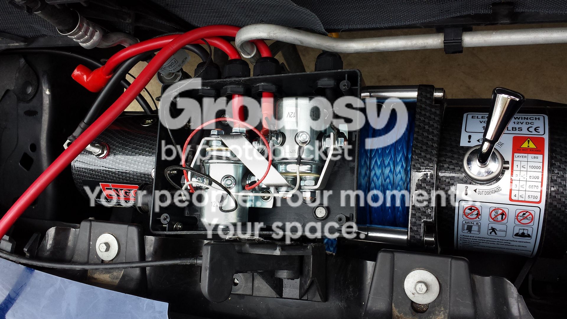

all my budget winches have contactors, not solenoids. you cant tell unless you take the cover off though. they use the large cover just like the older solenoid style.
That's awesome. Should solve the biggest problem with them. My old HF winch box looks more like this inside. Although mine never had an issue I know a lot of them fail over time:
My old 8274 solenoids still work. But they're like 30+ years old. I'm kinda surprised they still function. I really need to upgrade it. Modern electronics are so much better.
I have seen them fail also. its not a good thing. if they fail in the position of just NOT working, that sucks, but ultimately not a big deal. but when they fail in the ON/IN position, that makes for a VERY bad day
