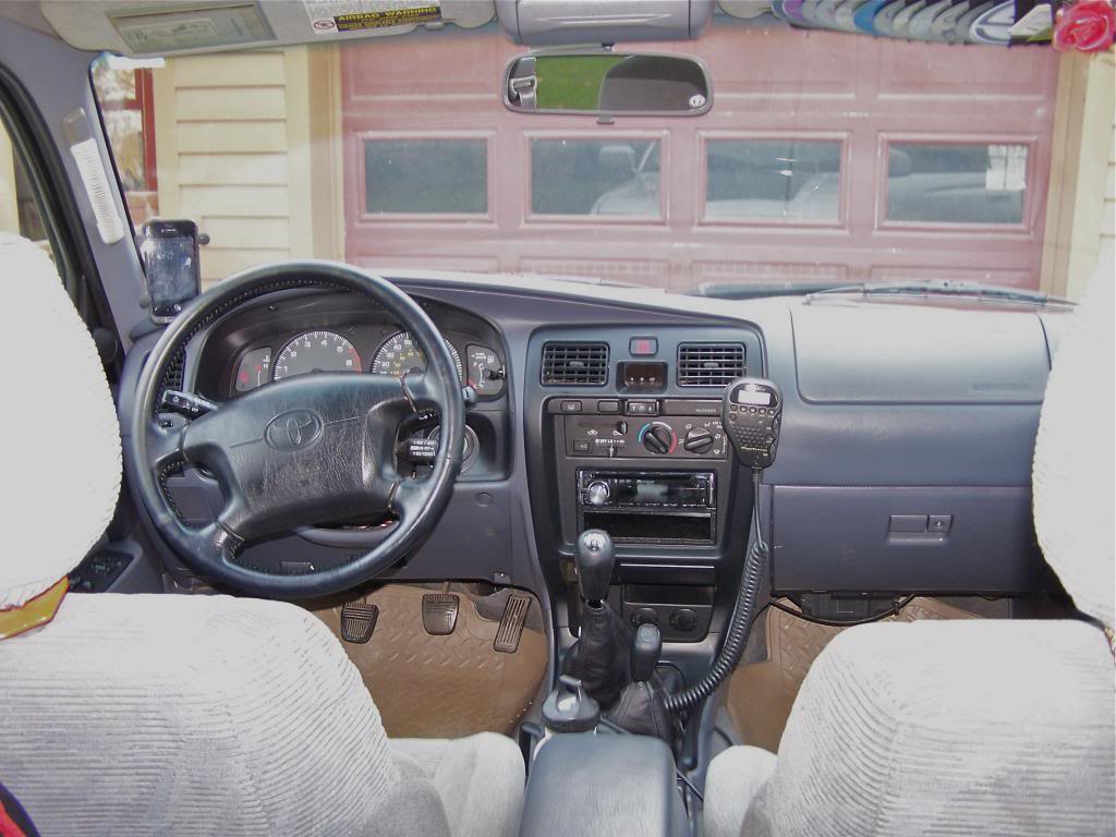

throwing another option in
I know it's not pretty but it is rock solid. There is no give whatsoever. It's been on there for over 3 years now. I could roll over and the phone would still be there.
With other holders I couldn't quite operate the phone while mounted without it moving around. This will not move at all.
I can adjust the arm to video up over the dash if wanted.
Line of sight is perfect for me. I don't have to turn my head or take my eyes too far from the road.

Thanks! I certainly concur with the choice of location :). I'm curious about the one unanswered question in that thread, how did you get behind the bezel to put on the nut? Is it easy access?
And if I take your idea one step further and combine it with [MENTION=177268]02gixxersix[/MENTION]'s idea of using a magnet, what if we took what you have:
And instead of drilling a hole through the bezel, we slipped in and glued a 100 lb disc magnet behind the larger flat portion of the dash, as shown below:
And then stuck the RAM mount to the front side of that location?
I don't know how much magnetism one would lose over the ~ 1/16" (?) of the plastic piece between the magnet and the RAM mount, maybe too much?
I've used these magnets in other applications, and when I once made the mistake of letting the striker touch the magnet directly, I was unable to pry it off to save my life - I was only able to separate them by hammering the striker sideways until it slid off the magnet. So maybe even with the separation it'll still provide enough holding ability?
I guess another (simpler?) option is to use the same RAM mount but drill through the portion of the dash I showed above; it'd be less noticeable.
