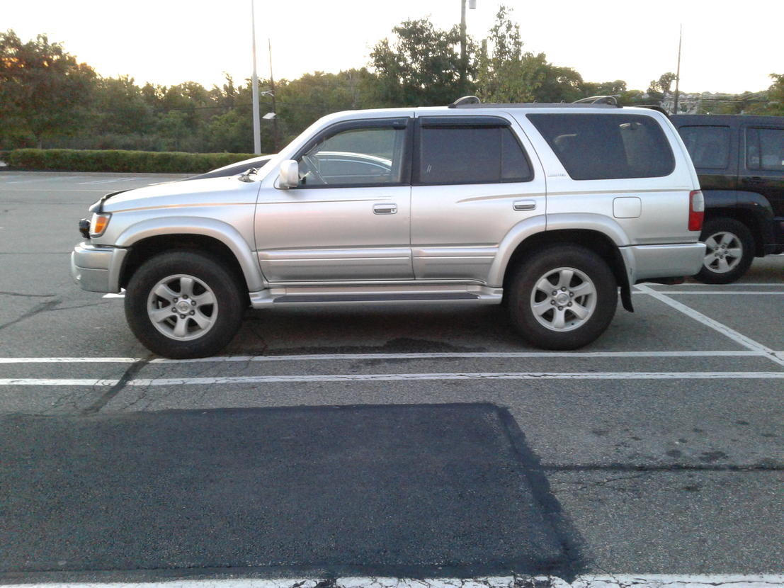

She's rolling on HTR's & 4th gen sport wheels right now. It's been a long time since I've felt the smooth running of HWY tires! LOL :naughty:
