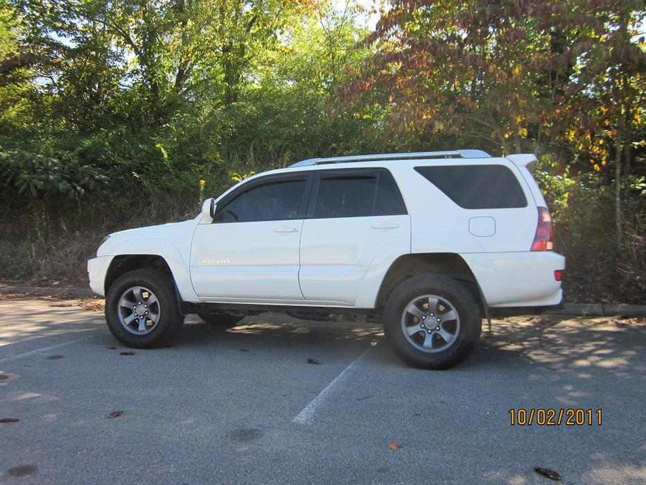

Basically what I have as well. I have FJ springs all around with a net 2" lift budget boost spacer in the front with 1.5 in rear.. I have some uninstalled Billies waiting! trying to decide how I want the setup to run at this point, just billies on 2.5 or billies on .85 with the budget boost spacer. Now after many miles and settling, the back is 2" higher than front, i would like to bring that together a little bit.
