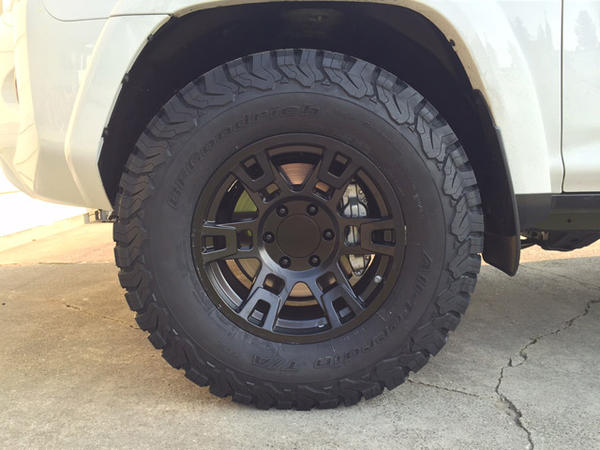

Stumbled across this thread and the FN wheels a few weeks ago, while trying to help a buddy of mine decide on wheels for his 5th gen build. I contacted Dustin immediately and he got us hooked up and I can tell you, I've dealt with a lot of reps in a lot of industries, but Dustin is genuinely one of the best people I have ever had the pleasure of dealing with. I would not hesitate to recommend him, his company, or the product to anybody looking. Hell, if I hadn't just bought wheels last November, I would have ordered myself a set solely off of the single interaction that I had with this man, and you better believe that the next time I'm in the market for wheels, FN will be the first place I go.
Anyway, the install went great and the owner LOVES his set up!

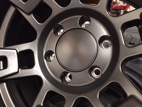

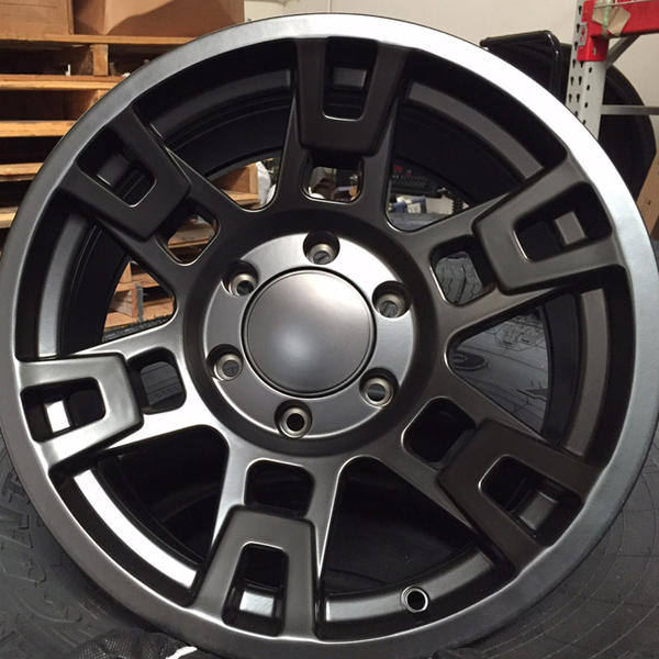

Do you have a close shot of the center cap?
Or....if Dustin is around, can somebody post of a photo of the Matte Black FN ƒ(x) Pro WITH the center cap?
Thanks!
I will get you guys a close up photo of our center cap by this afternoon. We use a very simple, clean, flush mounted center cap. Our ƒ(x) Pro wheels (and some of our other models too) are also compatible with OEM part # PTR18-35092 center caps.

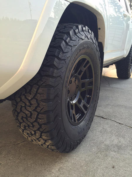

Here are the FN Wheels ƒ(x) Pro in Matte Black with 275/70R/17 tires at about 10-12 PSI. I also have to say thanks to Dustin for the great customer service and FN Wheels for the design.
Assuming those are BFG AT KO2, was the decision to go with FN based upon price or other factors?
i.e. as the BFG KO2 in a 275/70R/17 are "happy" with the 7" wheel diameter of the TRD Wheel....
I ran Nitto TG 275/55R/20 on the limited 20x7" wheels for 20k. I wanted something I could air-down to 10-12 PSI with fully loaded vehicle without any worries. I went back and forth between the TRD and the FN for a while. I went with the FN ƒ(x) Pro because it was an inch wider (for my own piece of mind) and the offset seemed to put the wheel a bit more flush with the body without spacers.
I really liked the look of the TRD centers, after seeing the FN in person with the flat center cap and the spline drive lugs it's a nice clean look. I went with the 275's over the 285 as my partial Bilstein 6112/5160 2" Icon spring order is in limbo because the 5160 are back ordered without an ETA.
As of this past camping and oversand trip I am really happy with the setup so far. It was a beast in the finest deep silt sand and on the large sand hill climbs it was solid.
Ah....OFFSET!!! I forgot about that. Thanks for the reminder. Nice set-up!
