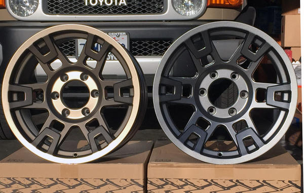

Regarding the new matte gunmetal color:

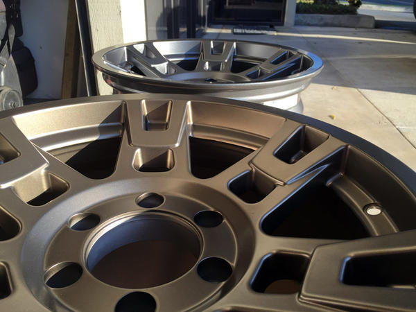

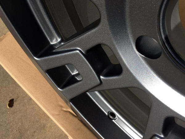

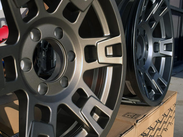

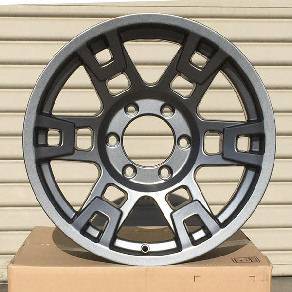

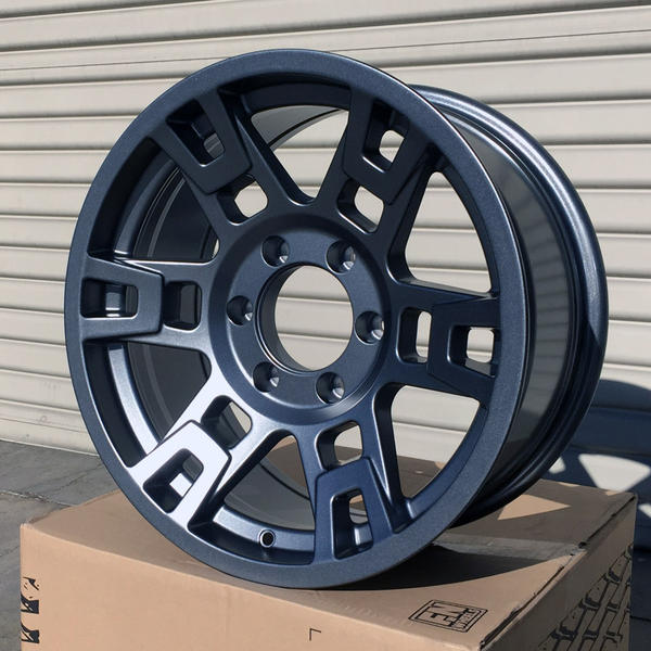

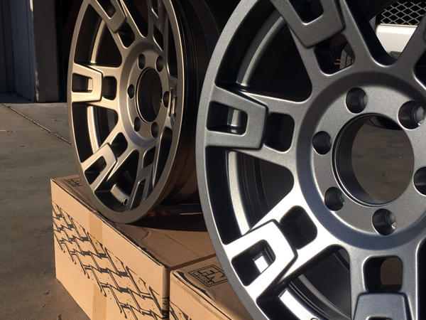

We have the new matte gunmetal finish in stock as of today. Here are a few photos that I took today (better photos will be available soon, and professional photos from our photographer will also be ready in a couple of weeks). As requested by a few members I also took photos in varying lighting situations and comparison photos with matte bronze:
