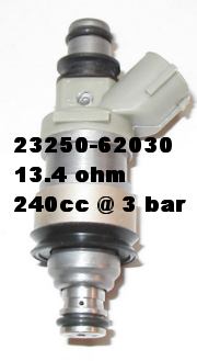

This is the stock injector we have, measured by WitchHunter Performance (an injector servicing company):
