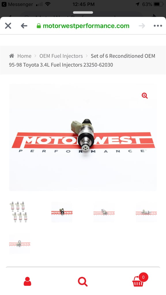

Just curious if anyone has used these on their 5VZFE engine?
I verified this morning my #2 injector is bad at 23.2 ohms.
Going to replace them all, was just curious if anyone has used these?
Sure brand new OEM is always a safe bet. The only problem is you'll spend an enormous amount of money on them. Like a freaking crazy amount on them.
Motorwest Performance refurbishes OEM injectors. You can either buy some from them that they have on hand or you can send them yours and they'll clean, rebuild, test and ship them back to you. If you're still concerned, give them a call and talk to the owner, Martin Diaz. He's a good dude and knows what he's doing. When I was visiting my friend Anwar in Los Angeles, Anwar told me about Motorwest. We went over to their shop and I bought a set of six that were used in the video below. In the video description there's contact information for Motorwest.
I actually called them and ordered a set, they are refurbished OEM Denso injectors. I wasn’t going to replace a single injector on an engine with 235k miles as I want them flow matched.
