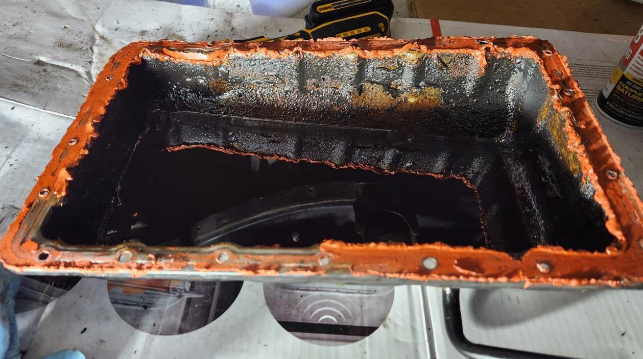

Doing a filter swap and when I dropped the pan I notice the inside was painted, and quite a bit of it was flaking/peeling towards the top.
This is a previously owned rig so I don't know the history but clearly the pan has been dropped before since the FIPG is gone and a cork one is there.
Anyone run into something similar? Any advice on how to proceed? I can't imagine paint chips floating around in the trans are great for its health...
Pic below:
Makes me wonder what the heck the PO put in the trans fluid that would eat away the paint. If it runs fine, and there's no flakes visible you can lightly clean off, I'd leave it alone. Unless you want to get some paint remover and just strip the pan completely. Not sure how much time you have on your hands.
So i cleaned it up a little and you can kind of see it in the picture, the paint is bubbling all the way towards the bottom of the pan as well. who knows what happened...maybe some kind of chemical application to remove the FIPG also weakened the paint...
Anyway based on how much its already breaking down I'm going to go ahead and strip the inside with Jasco or something similar.

Gasket remover spray can remove paint but it doesn't cause it to bubble like that. Probably some other type of chemical stripper was used to remove the fipg.
Transmission fluid is a detergent.
These rigs are 18+ years old.
Any maintenance done, and spraying the pan with brake clean to clean it, is going to degrade the paint.
Add the detergent of a transmission fluid, and bam.
Strip the pan, get some chemically resistant paint, or leave it bare steel.
Or, just get a new pan.
This happened on mine as well. I think its more related to a high heat scenario with overheating occurring. Doesn't take much heat to get paint to bubble. Especially transmission pan paint, Im assuming they didnt put the most heat resistant paint in there lol.
When I pulled the pan on my '02 it definitely looked powder coated to me. IDK. I'd probably source a replacement Toyota pan FWIW.
Bingo. This is it.
The OEM Orange FIPG turns into basically concrete after 15+ years.
Whoever removed the pan last used a chemical stripper to get rid of it.
That chemical stripper caused what you're seeing.
