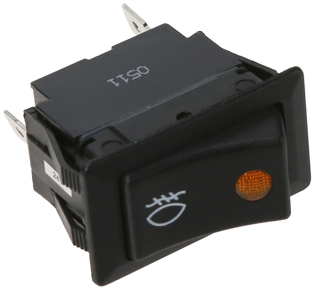

Whats the best looking incab switch for running two piaa 520atp on too of bumper?

https://smile.amazon.com/gp/product/B00KTKFBG4/ref=oh_aui_search_detailpage?ie=UTF8&psc=1

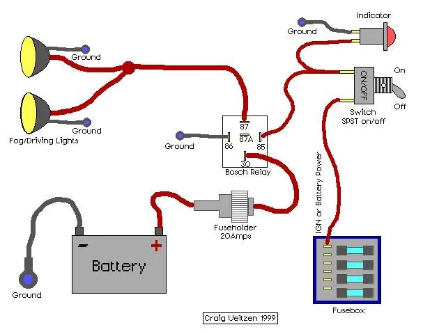

Use a relay, don't put all those amps through the switch, any switch.
You want power for the fogs direct from the battery (with an in-line fuse) or fuse box. You tap the relay coil/switch power depending on what behavior you want from the lights (always available = direct to batt, key on only = key on source, with parking lights, with lows, etc. N.B. Headlight circuits are switched hots with DRLs, switched ground without. I do mine to parking lights.)
