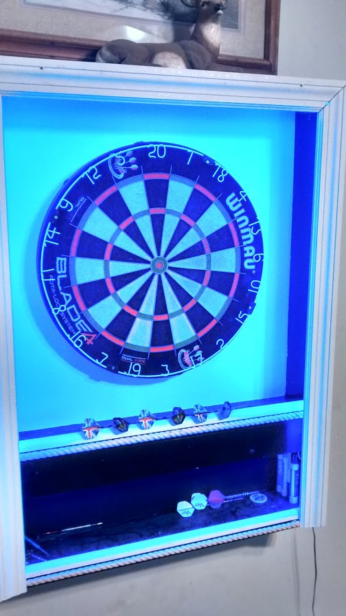

look at Super Bright LED they make some nifty stuff. I did this to a dart board. I got 16 feet of flexible r g b . It came with a remote so I can control color, speed of the flash control ,it has a couple of different strobe and chase patterns ... pretty cool. took the better part of a day to get this all assembled. fun project.

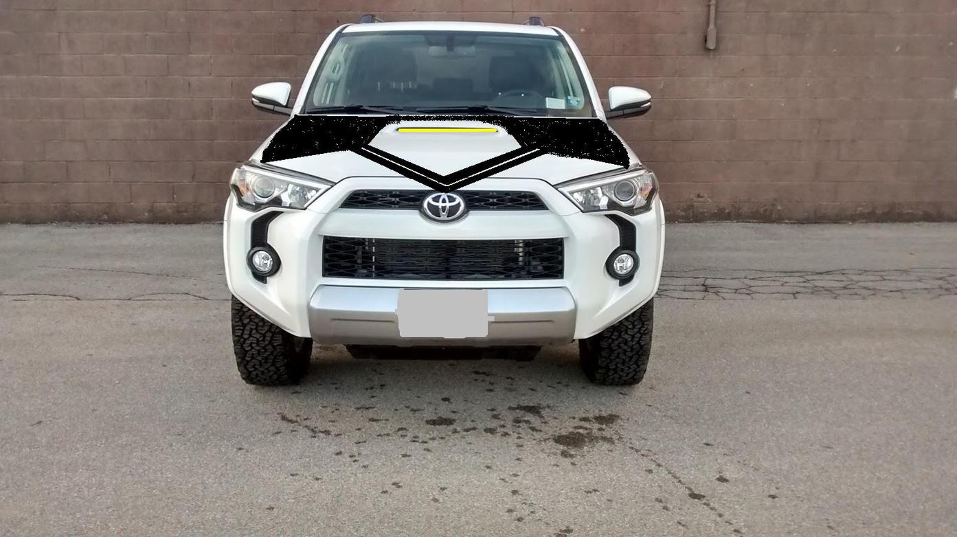

any way this is what i was foolin around with tonight

I tried those as well. Although they are bright the light doesn't project. They would make ideal backup lights or undercarriage lights. Best of luck though.
