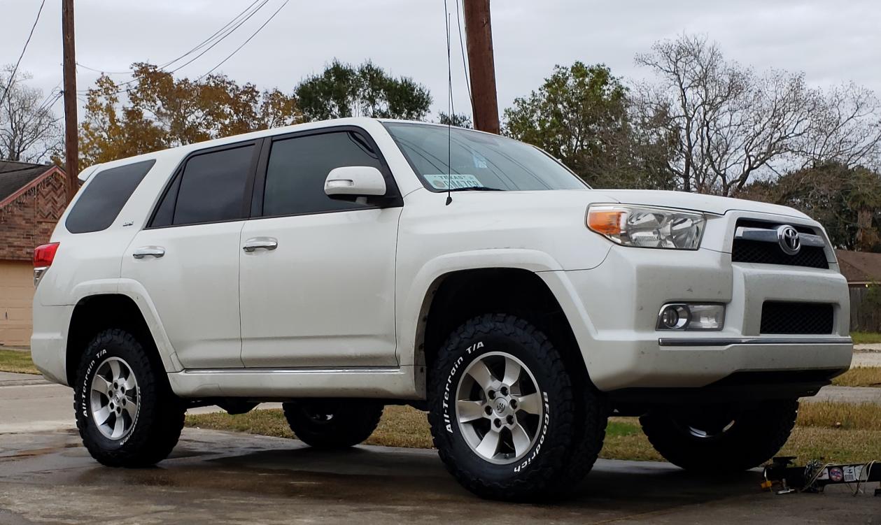

Installed 1" body lift
Can you do a partial body lift in the front like that? Would you use 2 or 4 of the 8 spacers that come with the BL kit?
Sorry, I meant that I may do a 1/2" body lift when I put long travel up front to allow for more fender clearance. It came out wrong. I would not recommend only body lifting one end...

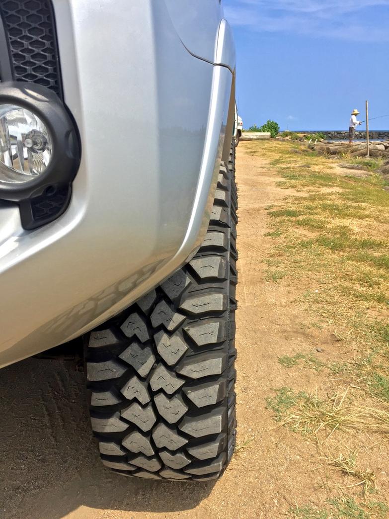

does the new tires stick out from the fenders? That was the size I originally wanted but I got the 285 KM2's like your old set up, because of Recon.
No because the backspace and offset of these wheels keep them inside

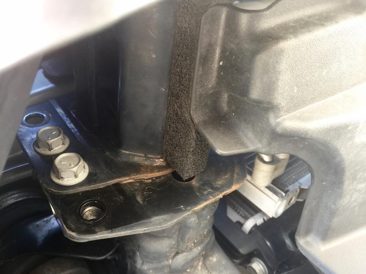

For the front bumper, I did have to move it up in order for the bumper cover and fenders to seam tight because they wouldn't without. It had a slight 1/8" gap so I decided to move the bumper up. There are 8 studs it mounts to, which 6 are in a vertical column. That row of studs allow it to perfectly go up one inch. So now I have 4 of the 8 bolts holding the bumper but it's still plenty solid. Welding it is an option if you feel differently. Ive attached a pic.

4. Aluminum front bumper can be moved up exactly one inch via its 8-bolt mounting holes and you have to in order to seam the plastic bumper cover back up tight. If not , you'll have a slight 1/8" gap between bumper and fender. By moving it up you can only use 4 of the 8 original mounting holes. Still plenty strong enough mount though. Weld it if you think differently.

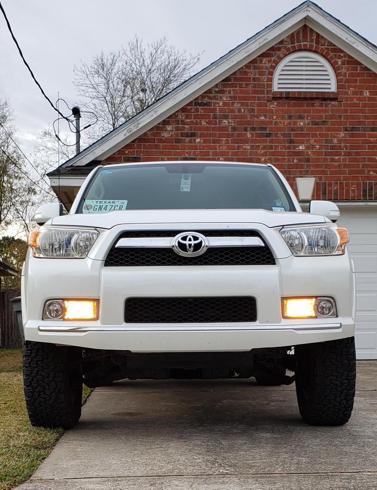

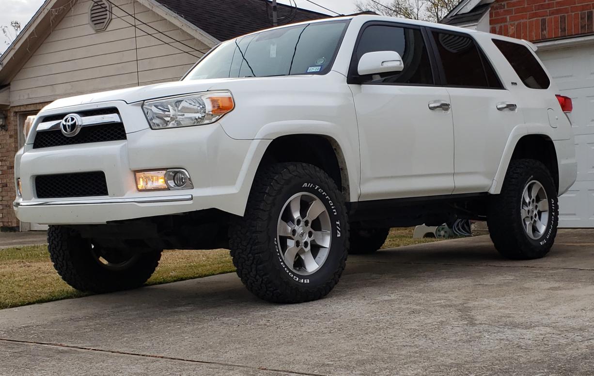

The pictures attached show a before and after of cutting the front bumper (Still need to go back and round the corner a bit in front of the wheel) and adding Shrockworks rocker trim.
