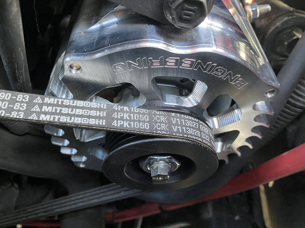

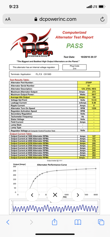

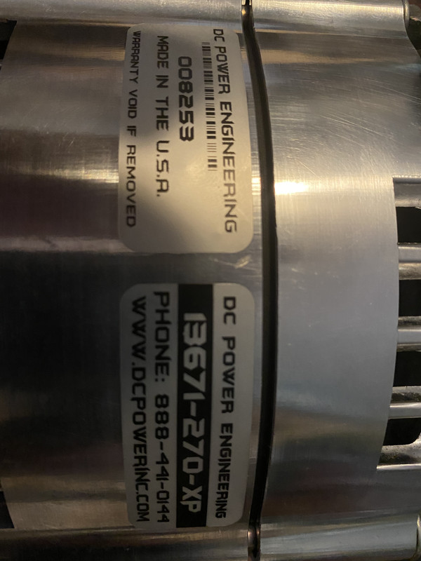

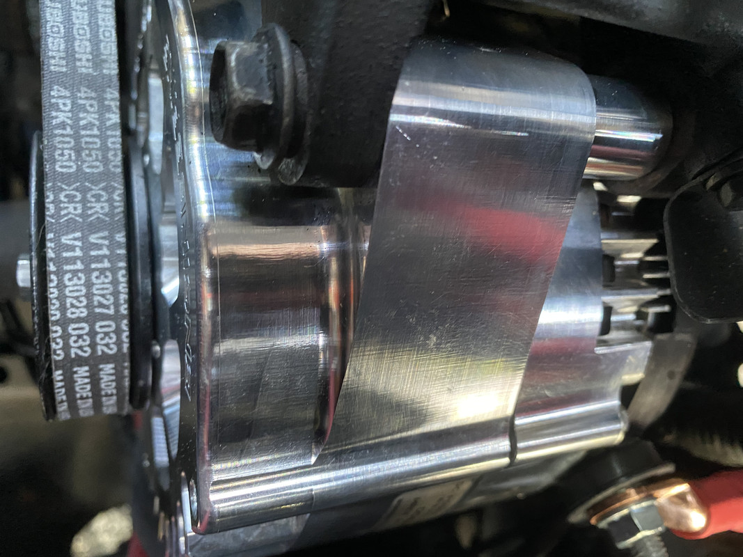

I decided on a DC Power 270-XP alternator. I opted for the rear billet aluminum for $75 extra so that the entire unit would have the same appearance and finish. I know that 270 Amps seems like overkill, but remember that 270 Amps occurs only at 8000 RPMs at optimum operating temperatures. At idle the true amperage is listed at 198. According to their chart amps can go as low as 127 in certain conditions, but that should be the absolute lowest output in any operating condition. I included a screenshot of the 270-XP performance test results (from the DC Power website) as photo #4 so you can review their data for yourself. My new alternator was delivered about 3 and a half weeks after my order was placed, so give yourself some time if you buy one of these. As you can probably see in the photos the 270-XP is almost a work of art when you look at it.

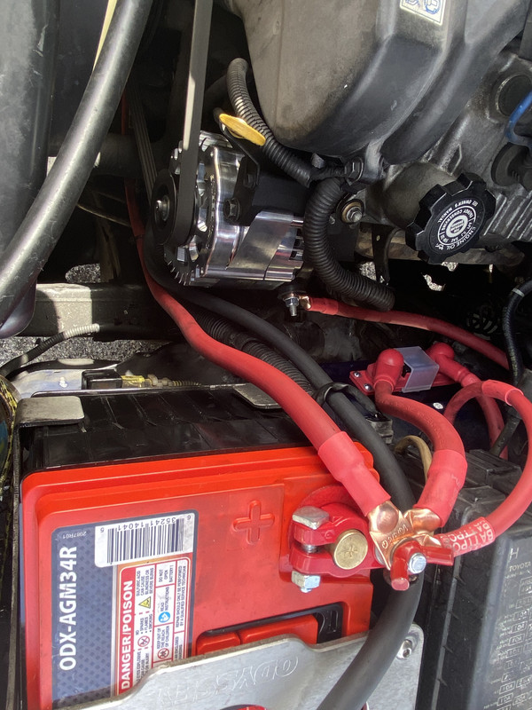

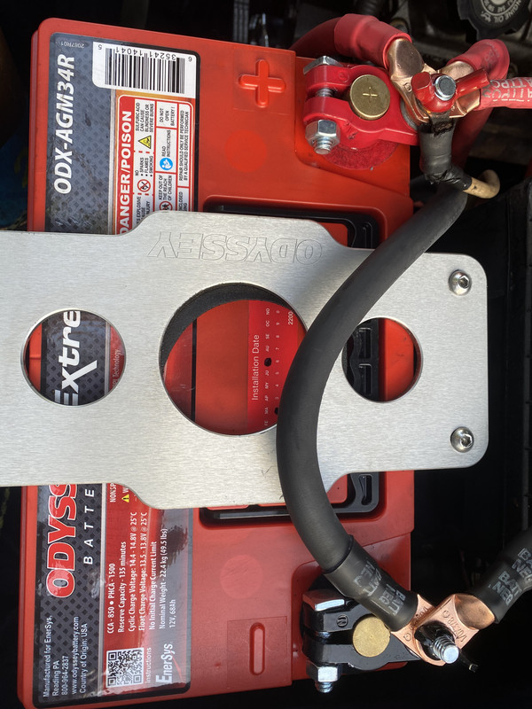

I already have an Odyssey battery holder installed, so I went with an Odyssey 34R AGM battery. This battery weighs 49.5 pounds and has 850 cold cranking amps.

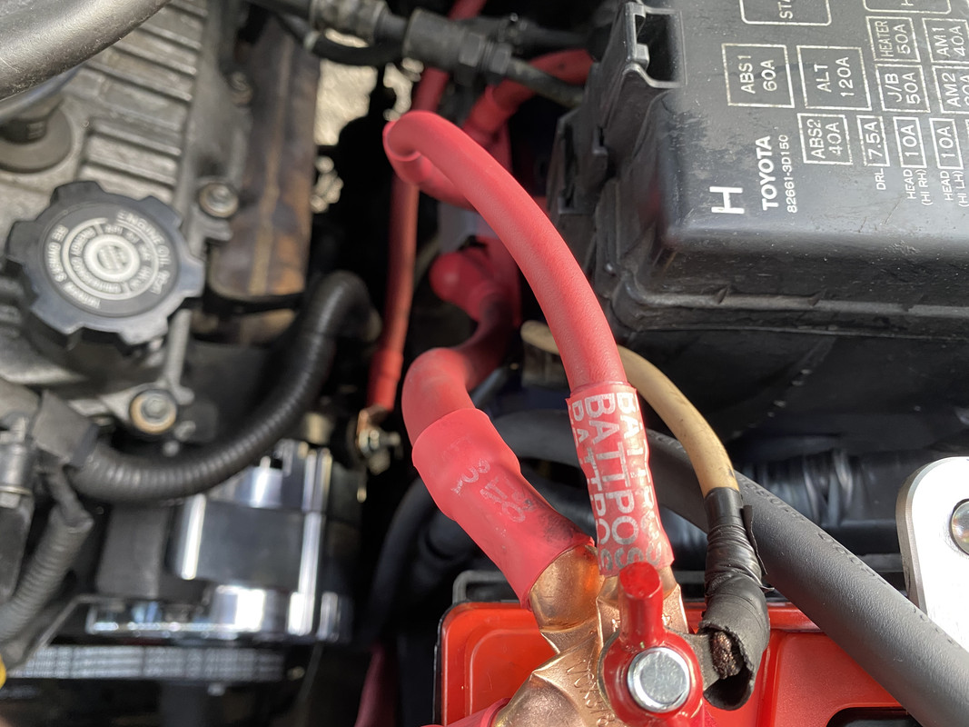

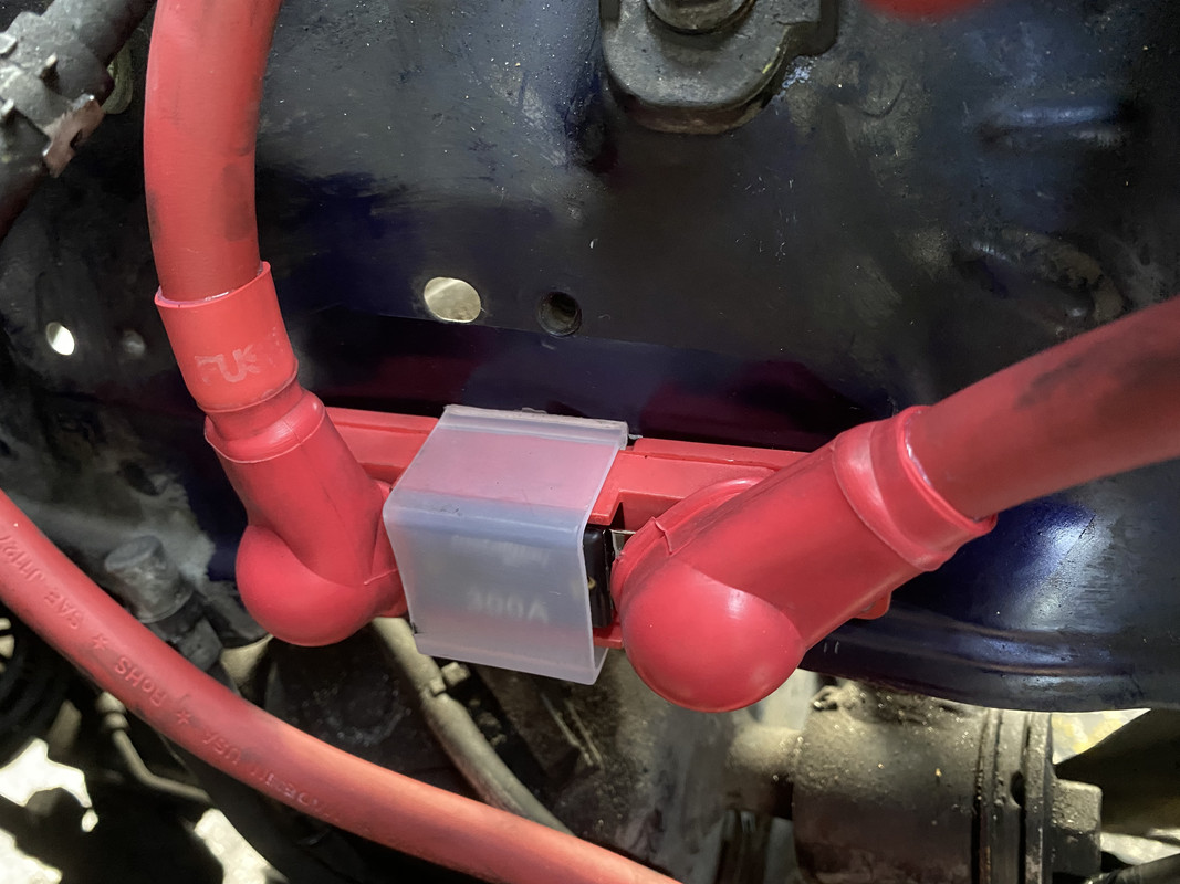

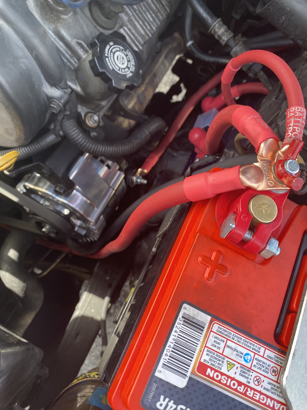

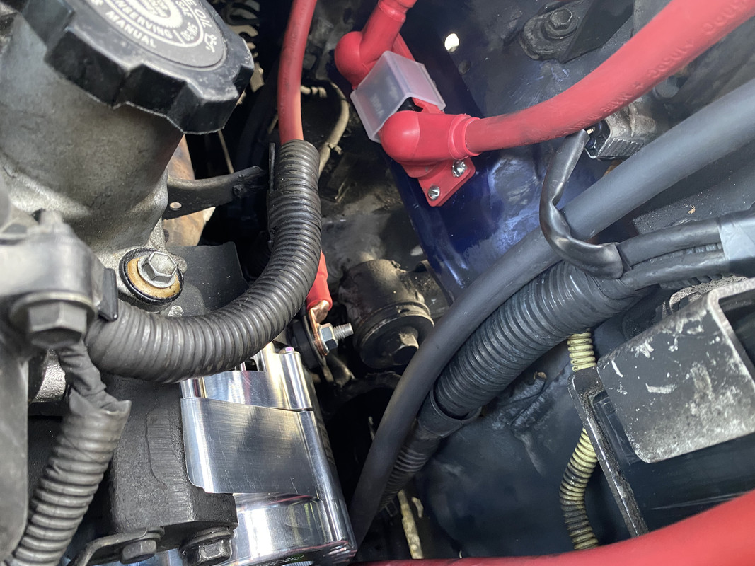

To tie everything together I bought the thickest gauge wire set that JeepCables offered. The kit I purchased is specifically designed for 3rd Gen 4Runners. The Big 7 kit for 3rd Gens actually has 6 cables, not 7. I spoke to an experienced rep at the company to confirm that I had everything in the package. The cables are labeled on each and every end to make things easier for you or your mechanic. An exterior fuse attachment is included with four fuses with different amperage ratings. I mounted mine on the inside fender below the fuse box just a few inches back. You can see where I mounted this in photos #5 and #6. I installed the fuse holder by drilling 4 small holes and used the 300 amp fuse that was supplied.

Just a side note that the alternator pulley is much smaller than the crank pulley, which means that the alternator will be running at a speed much higher than the engine RPM. If it's say, 3 alternator rotations per crank rotation then you'd reach maximum output at 2666 engine RPM and minimum output at 410 engine RPM.
There is a 2-year warranty on the alternator and 3-year warranty on the battery.
I understand what you are saying about the smaller pulley size and RPMs. The DC Power 270-XP alternator uses the same size pulley for the 3rd Gen as the 80 amp alternator from the factory. I think that the DC Power performance data sheet that I posted refers to engine RPMs, not actual RPMs realized because of a smaller pulley.

I already had an Odyssey battery holder installed which was designed specifically for an Odyssey 34R AGM battery. I have had this battery before and was impressed. I’m not that familiar with Group 27 or Group 31 batteries. The Odyssey Group 34 battery holder is already a very tight fit. When I originally installed the battery holder I had to replace the plastic OEM coolant overflow tank with something narrower and longer.
