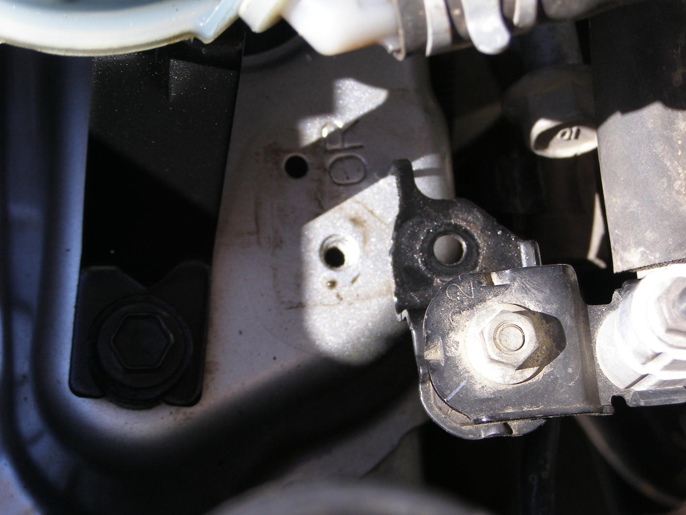

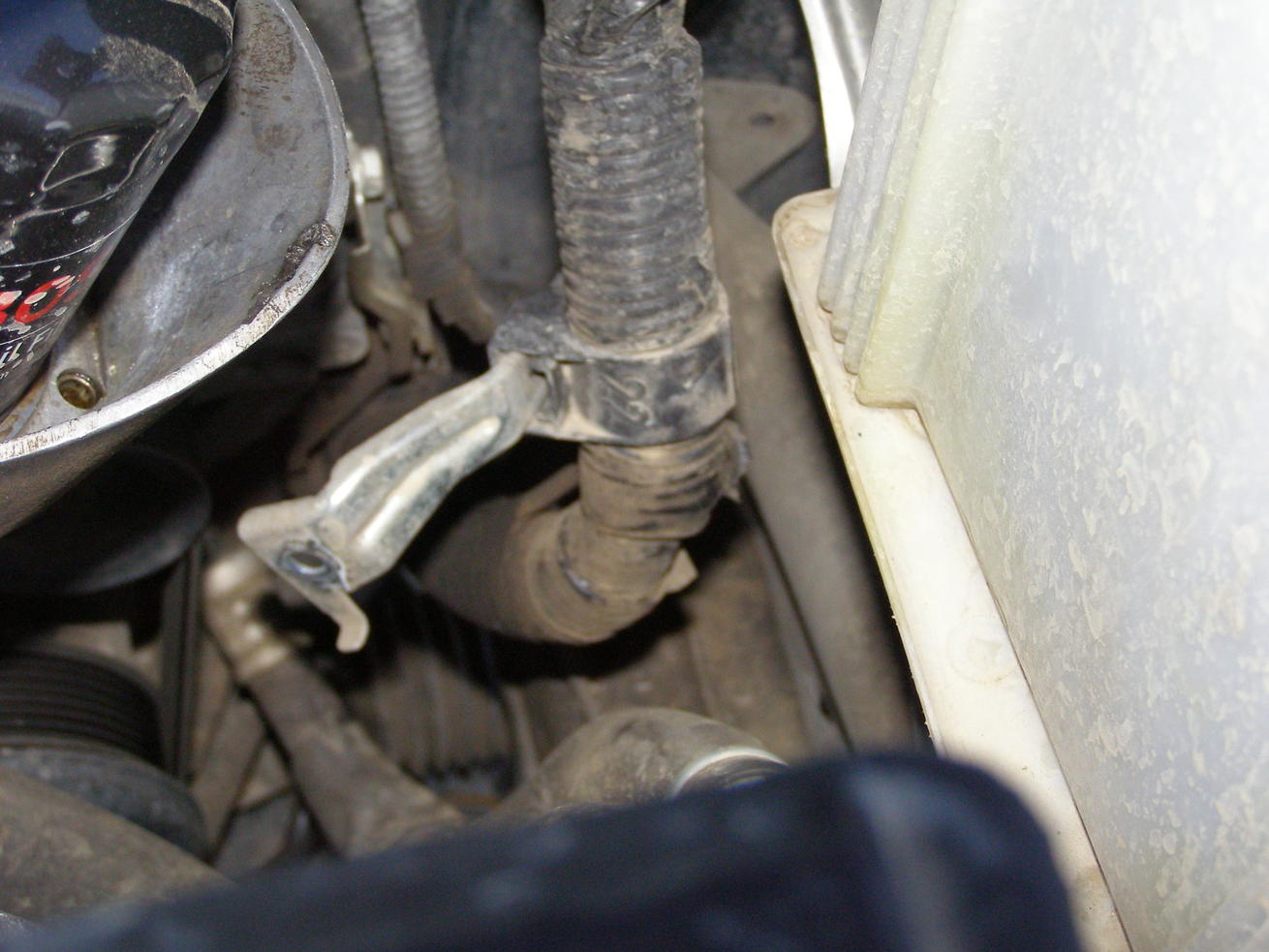

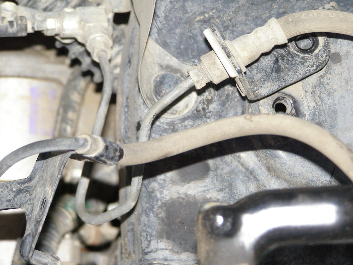

Pictures below will show additional brackets to remove and shift to make thing easier not shown or told in there video.
In case it matters on make and model- 08, 4x4, sr5, v-6.
Remove both brake bracket line brackets, left and right side and make sure to spray bolt on UCA brake bracket with wd-40 as mine broke off.
The bracket under the battery box and the battery hold down bracket as you will need to lift the battery up to remove the bolt.
Remove the A/C line bracket and hose under it on the right side for bolt removal.
I didn't find any of this info on searches or instructions.
