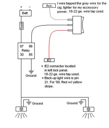

happen to have a wiring diagram for us that would wish to do this?
I'll definitely get a diagram up for anyone that wants it. I have started it and will probably finish this weekend. I just have some other stuff to wrap up before school starts up again. The diagram should be helpful for a few different projects too because of it's simplicity

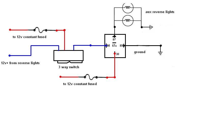

theres a reverese wire on the wire bundle at the drivers kick panel you can use that to trigger the lights

I got some free time at work to finish the diagram. I tried to explain everything within the diagram. For 2000 the back-up light wire is red w/ a yellow stripe. Don't know for '96-'98. For '01-'02 the ie2 connector and pin # is the same with the wire being white w/ a blue stripe (online source). I chose an accessory source so that the lights cannot turn on without the key turned, but you could always connect that end to a 12V constant so they turn on whenever (like the diagram Elton posted).
