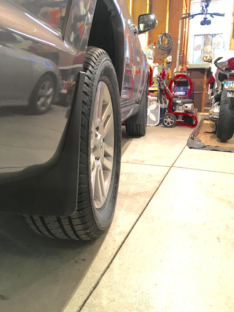

Just installed Toyota Factory mudguard on my LE.
2010 2015 Toyota 4Runner Mudguard Kit Black Factory Toyota Accessory Brand New | eBay
Item description says:
NOTE: THESE MUDGUARDS WILL NOT WORK ON 4RUNNER WITH AUTOMATIC RUNNING BOARDS OR ACCESSORY RUNNING BOARDS (PART # PT925-89100) THESE ARE THE TRAIL TEAM EDITION!!
I have automatic running boards and didn't think the front ones were going to fit, but after looking at how the boards attach to the hinge, I was able to just slide the boards back an inch or two to clear the back of the front mudguards.
The directions are sort of confusing, but I was able to get them installed with the help of this thread.
http://www.toyota-4runner.org/5th-gen-t4rs/98532-5th-gen-2011-4runner-sr5-mudflap-splash-guard-install-instructions.html
These mudguards clear the front wheel at full lock vs the smaller ones that originally came on my LE. I really like the look of them and they are well secured and don't move around. I thought about getting them painted to match, but I figured these will get nicked up so why bother. Hopefully it will help keep some of the debris of the skirts.

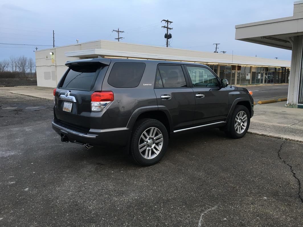

Just got a 2018 LE and was about to install oem rear mud flaps, followed directions and it says put the mud flap in between the panel and body. Well I did a pre fit and found a 1/8" gap towards the upper part of panel and flap. Now if i put it in front of panel no gaps. Has any one seen this issue, just wondering, cause I'm opting in front of panel. But the instructions say between panel and body. Looks crappy in between panel and body. Any thoughts.
Mudguards
All the mudguards go over the plastic fender flares.
