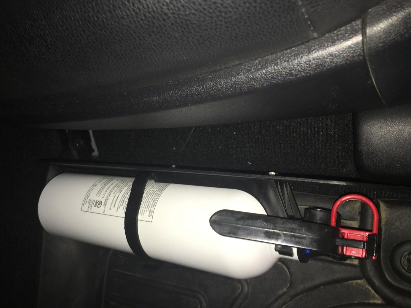

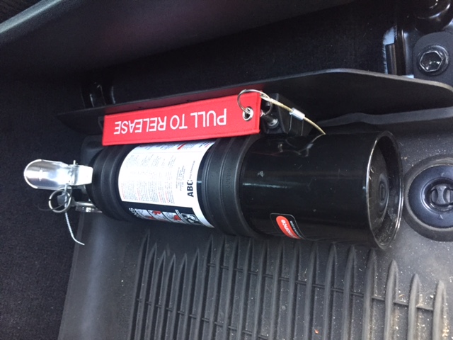

I received my Wits End fire extinguisher mount yesterday. I must say I was impressed from the beginning. I placed my order on the 14th and got it yesterday. The mount was wrapped is heavy paper and then wrapped again with large bubble wrap and placed in a box. Nicely packaged. I picked up the automotive fire extinguisher from HomeDepot. It was about $20 and is good size. Find it HEREKidde 10 B:C Rated Auto/Marine Fire Extinguisher-21027411 - The Home Depot
Installation was straight forward. I mounted the extinguisher on the driver's side. There were no instructions, but it is easy. Remove the 2 plastic end caps covering the seat track mounting bolts. Remove the bolts. This is where you want to test-fit the mounting bracket and fire extinguisher with mount. You will want to install the fire extinguisher mount before you secure the mounting bracket to the seat. Once you have positioning of the fire extinguisher mount where you want it, you can secure the bracket to the seat track. The mounting tabs sit on top of the seat track. Tighten the bolts and you are good to do.
That being said.... a couple installation notes:
1) If you want the drivers side seat track trim pieces to be re-installed, you will need to notch the front of the trim piece slightly to go around the angled support brace of the mounting bracket. I tried, but failed to get the passenger side trim piece reinstalled. No biggie as you don't see it.
2) I have the Husky Liner WeatherBeater floormats. The floormats don't fit with the bracket installed. The rear lip doesn't slide under the bracket. I had to trim off the back lip off the floormat for it to fit. Again, not a huge issue, but something to keep in mind of.
Overall, I'm very happy with the mount. The extinguisher is within easy reach and is out of the way. I am about 6ft tall and it doesn't get in the way at all. I'm very happy with the overall final product. The cost of the mount is steep $94 including shipping + $20 for the extinguisher, however, I find the cost to be well worth it.

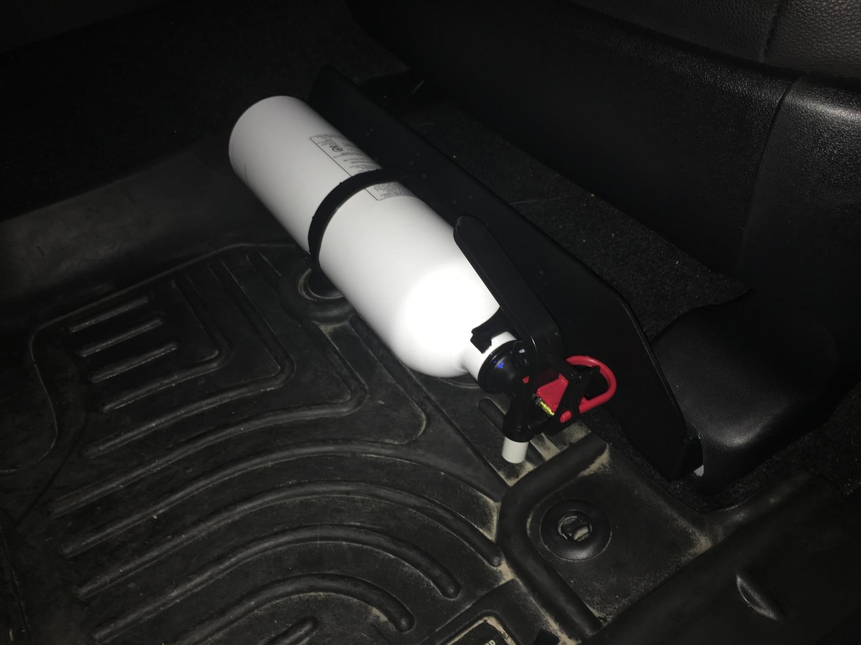

I purchased one and probably will get another. It's niiice

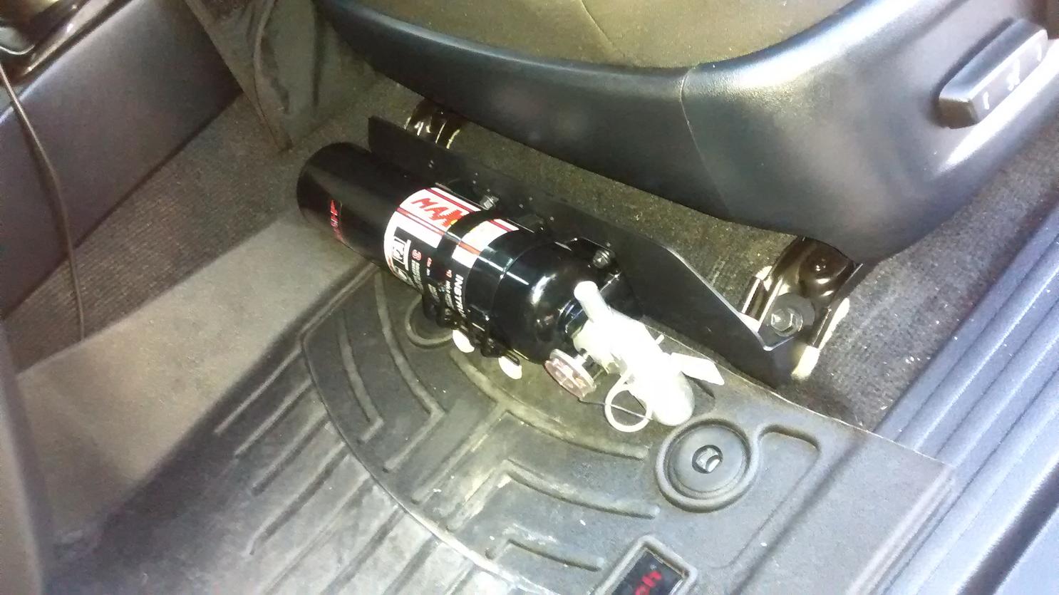

I just picked up this Wits End mount. Got the H3R HG250B extinguisher and the Drake FIREX-MNT-DOR quick release mount. The extinguisher is required at some off road venues and not a bad idea when camping.
