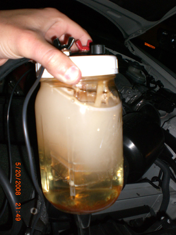

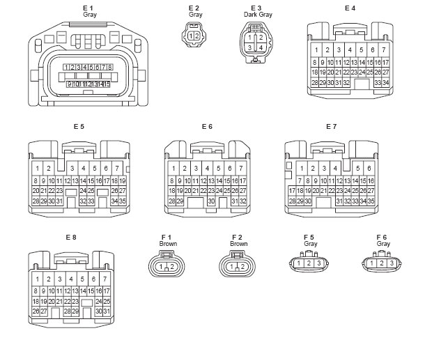

Engine Control Module Connectors
The bank 1 sensor is pin 18 on connector E4 and the bank 2 sensor is on pin 33 on connector E5. I didn't realize earlier that they were on different connectors. I'll try to send you a picture of the connectors. E4 through E8 are all Engine Control Module connectors. I don't know which is bank 1 vs bank 2. My guess would be the left exhaust would be bank 1 but it shouldn't be too hard to determine with an ohm meter. Does it really matter which is which?

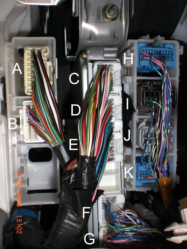

ecu image
thanks mike, i got the image but im not seeing the wire patterns. is there any way you (or anyone) can tell me a lable for this image? A=E_ and so forth? i would greatly appreciate it.

Connector Locations
I didn't mention but my electrical wiring diagrams are for a 2006 but I don't think they have changed much. I also have 2007 and it is exactly the same connectors. Depending on your vehicle configuration there could be a lot of stuff in this area including 4WD control ECU, Tire Pressure Monitor ECU,Theft Deterrent ECU, and Transponder Key Computer as well as the Engine Control Module. My diagram shows the Engine Control Module separate from the others which is clearly not the case. All the connectors are keyed so that they can't be plugged in the wrong place. From the pictures you can see that each connector is different either in number of pins or keying (blocked areas). I would remove each connector and look at the face and compare it with the pictures until you find the correct two. My guess would be that the row of 5 connectors is the Engine Control Module since that is the correct number. Sorry I can't offer any more definitive solution.

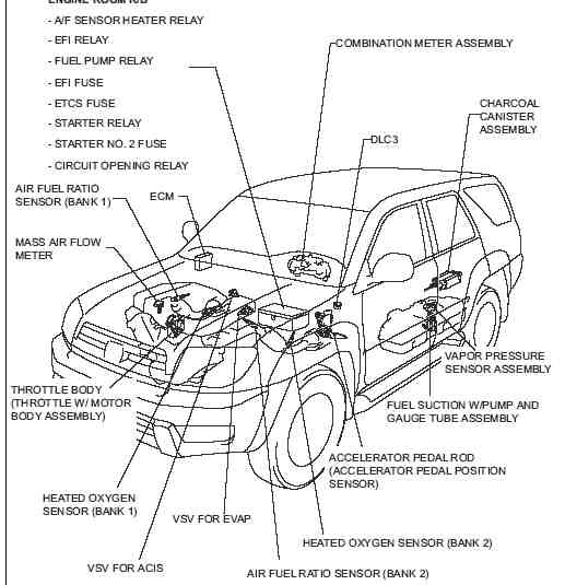

well guys, after probing every single wire at the ecu, and not finding the signal varying between 0 and 1 volt (i did find two wires registering .3 to .6 volts) i got on the forum of the guy who makes the efies and he said that toyotas, and im asuming some other mnfrs. as well, use what are called air/fuel ratio sensors, not oxygen sensors. apparently these read a much narrower band and cannot be altered with the efie without tripping the check engine light. so to make a very long 4runner story short, this system will not work on a 4th gen 4runner. you cant just run the hho without the efie, ive tried with bad results. mike, the efie guy, did tell me that some people are having luck with the sensor spacers (ebay) but that seems a little hokey to me. ive seen other posts from this site from others trying this but i dont know when toyota made the switch between o2 sensors and a/f ratio sensors. i suppose if yours is an older model its worth a call to the dealership to see which it has. like i said at the top, my s2000 is way more simple than this 4runner. thanks for all of the help guys.
Sensors
I hate to argue with your expert but according to the 2007 repair manual the oxygen sensor and air fuel ratio sensors are both included. Also I have a wiring manual for the 2006 model that shows both sensors. The air fuel ratio sensor is on connector E5 pins 22 and 30 for bank 1 and connector E5 pins 23 and 31 for bank 2. Attached is a pictorial of the location of the sensors. It looks like the O2 sensor is after the converter and the air fuel ratio sensor is before the converter.
