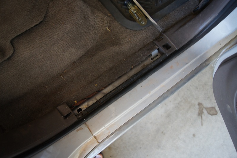

I started by taking out the back lower seats and removing all the side panels and floor-boards.

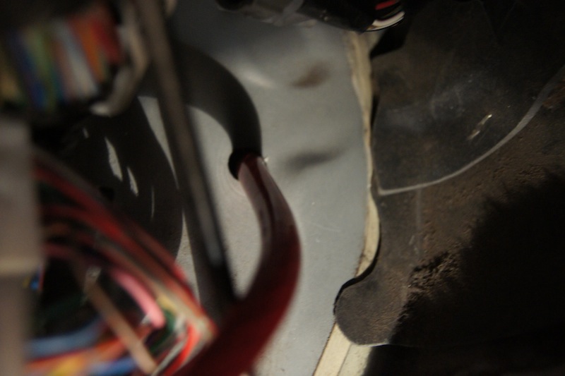

Then I drilled a hole in the firewall to send the power wire through.

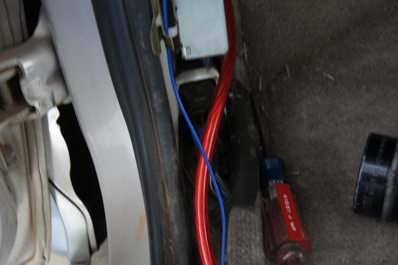

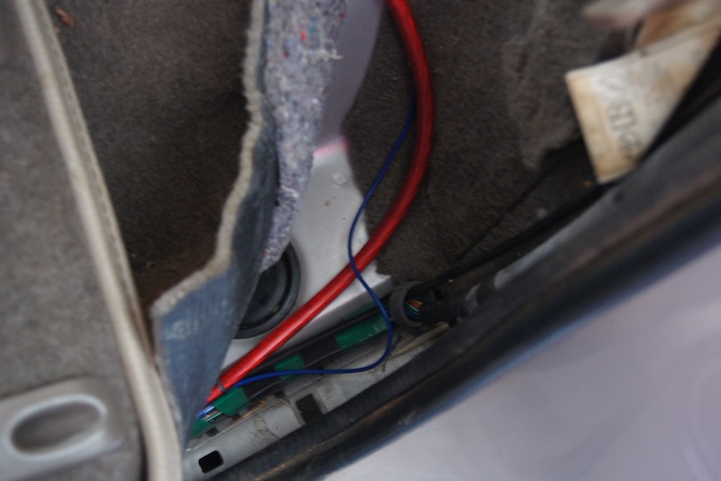

Then I ran the wire along the floor panels. I ran all the power cords along the left side and all the audio wires along the right side.
Then I ran it under the carpet under the back seat.

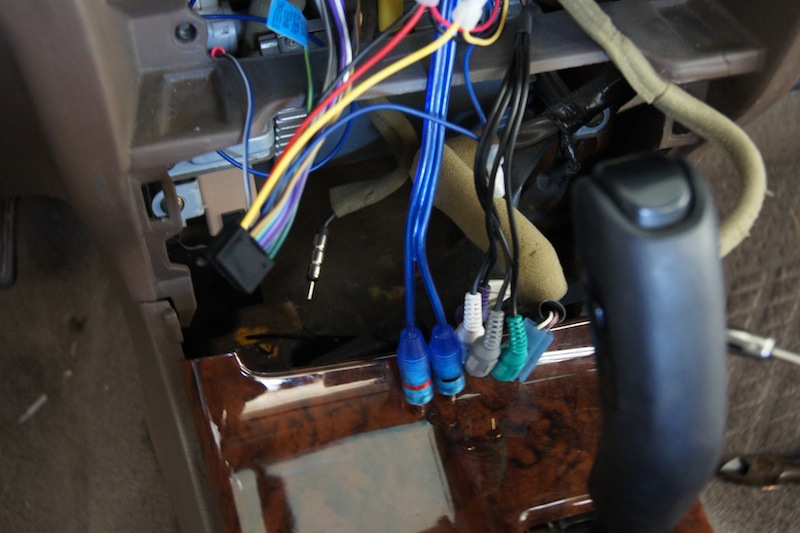

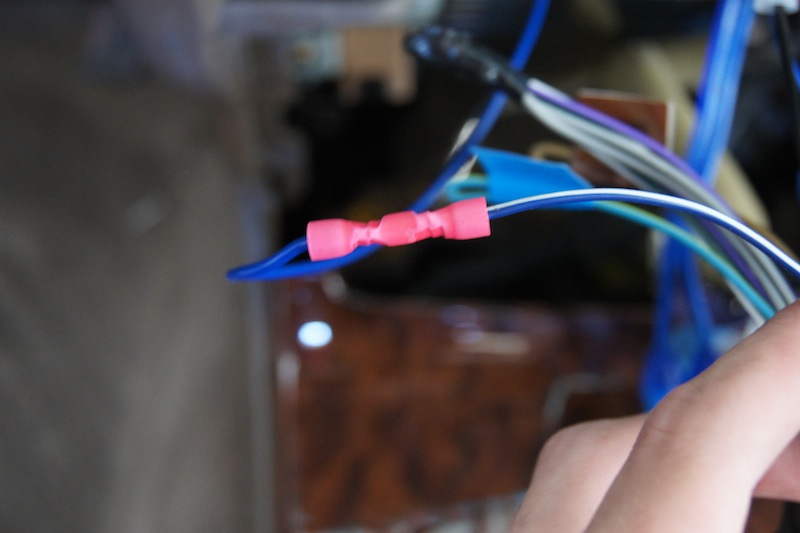

Then I wired the remote power wire to my head-unit.
Next I attached the RCA cables to the head-unit.

I would suggest putting a rubber gromet in the hole you drilled through the fire wall to prevent the power wire from chaffing. Last thing you want is to have your power wire short out on the firewall.
why do u guys always drill holes in the firewall, its easy to cut a small slit in the factory gromet and feed the wire through. get some silicone spray to help feed the wire, its less messier than wd40.
