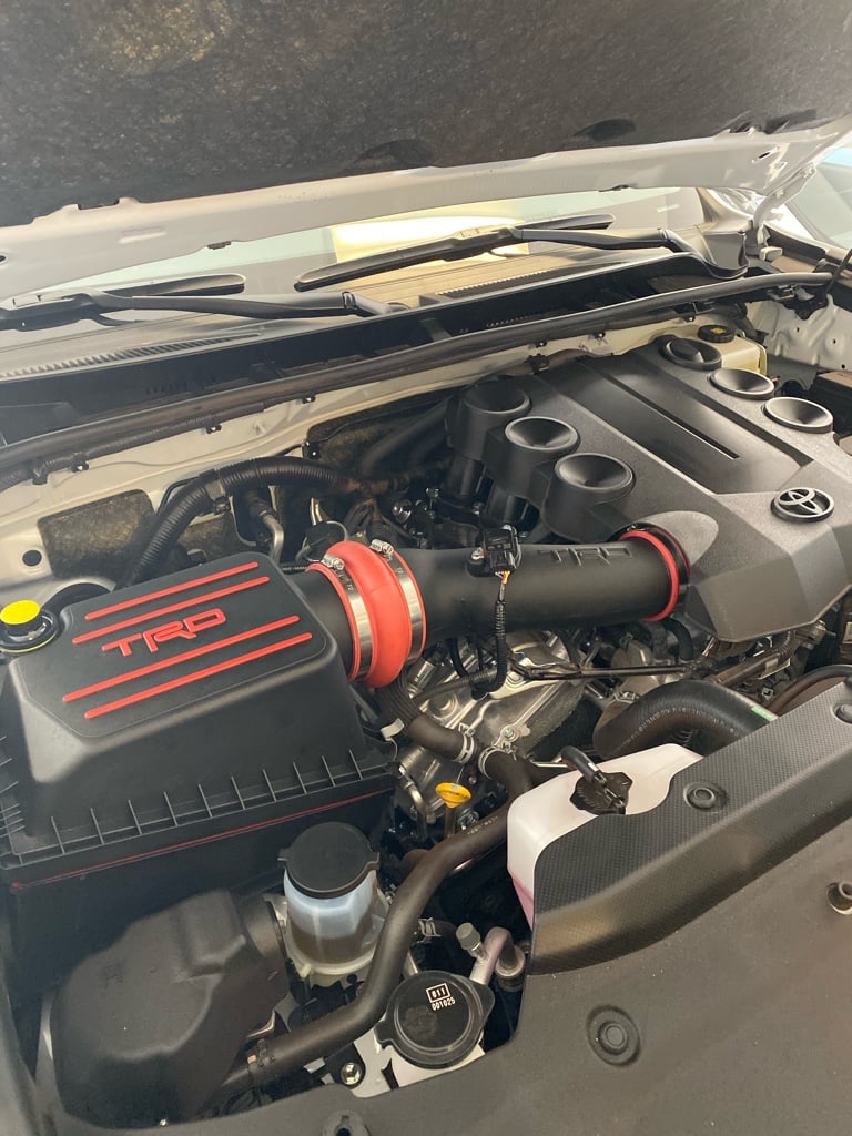

Process of installing a CAI is relatively simple and it took me no more than 30 minutes. Your first step should be removing your entire stock intake system, all the way up to your throttle body. Usually kits come with instruction so thats give, although if you still cant figure it out, the way that I would do it is connect your CAI piping to your throttle body first. Clamping it down and maybe using a rubber adapter of some sorts to get a good seal. Install any CAI covers or a box next, and then add your filter head on. At the end of this process, all your left with is connect your MAF and your vacuum hose.
On a side note, I replaced my hose with a breather filter. Doesn't do much, but it is good for the engines health. I hope this is the same process, although I'm confident this is the same engine. I have a 2015 4Runner and my process was way too easy. When in doubt, Follow the kits instructions!!!!

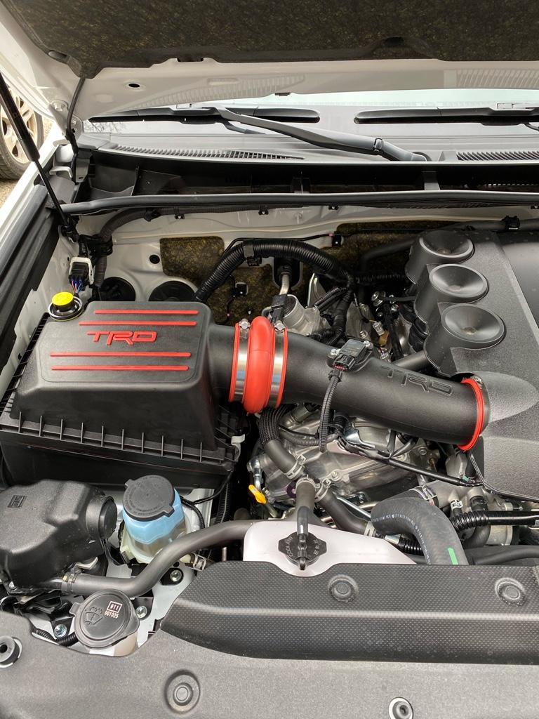

Got it installed! Love the sound so far. Wonder what it would sound like with the Borla Touring exhaust?

No issues on the install in my 2020.
bought one slightly used here on the 4runner forums, installed it on my 2020TRDP.
so the trd intake and exhaust combo sounds amazing ..

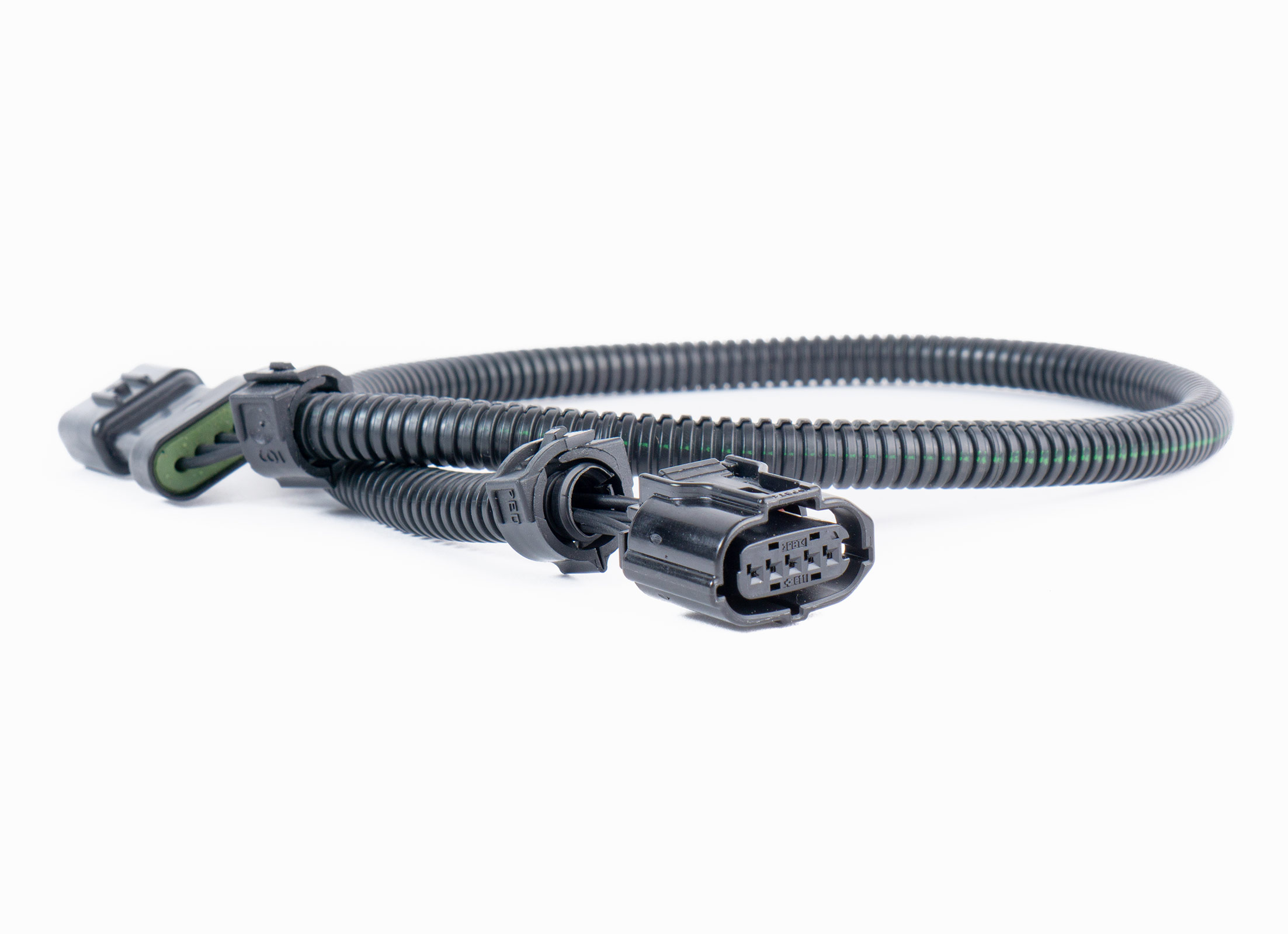

Do not know if you bought and installed the TRD CAI. But you might want to forego cutting up your wire harness and you and extender instead, It is a little longer than needed but I tucked it out of the way. Underdog Racing sells them.
URD MAF Sensor Extension Harness for NEW STYLE MAF - Underdog Racing Development
Did this part fit and work correctly on your 2020 4runner? I have a 2020 trd pro and the website is saying it does not fit the vehicle. Im new to this and just trying to make sure i buy the correct parts. Thanks
When I bought mine for my 19 Pro, it said the same thing. Nothing has really changed inside the engine bay. With that said, save yourself some money and buy the individual components instead of the kit. I think I paid around $220 shipped when I did it this way. I used Conicelli Toyota from PA and ordered online.
Was looking at the TRD cai and came across this ext cable. Got the setup and installed 2 weeks ago on my ‘20 ORP. Sound great when it hit 2k+ rpm.
No issues with the fit, except for a couple of minor nylon strap mounting points that doesn’t match the MY 2012 illustrated instructions, but no big deal.
Didn’t have to mess with undoing existing wire loom when using the UDR cable.
