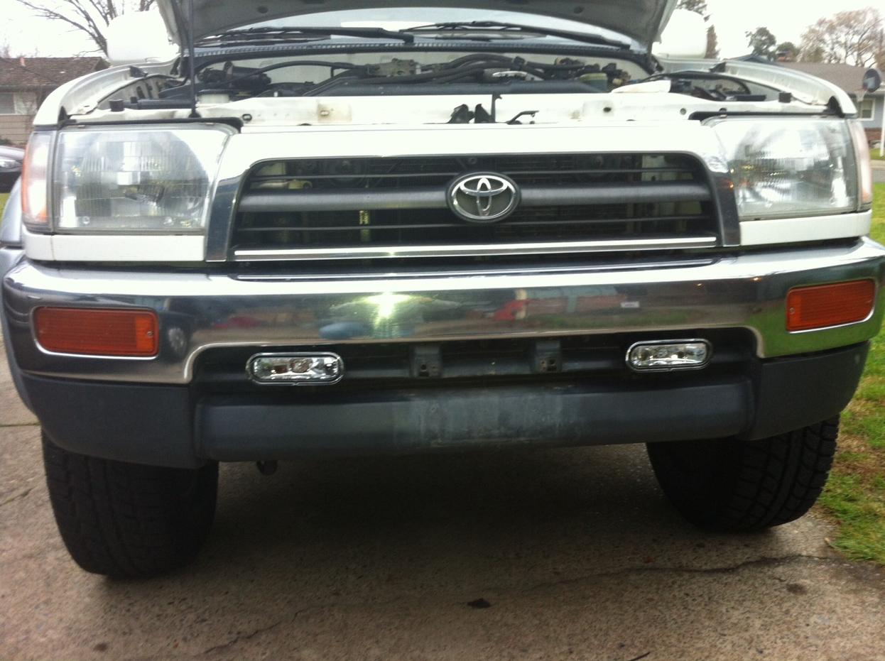

i just got mine from auto zone and cut out places for them in the bumper pretty simple and they work great

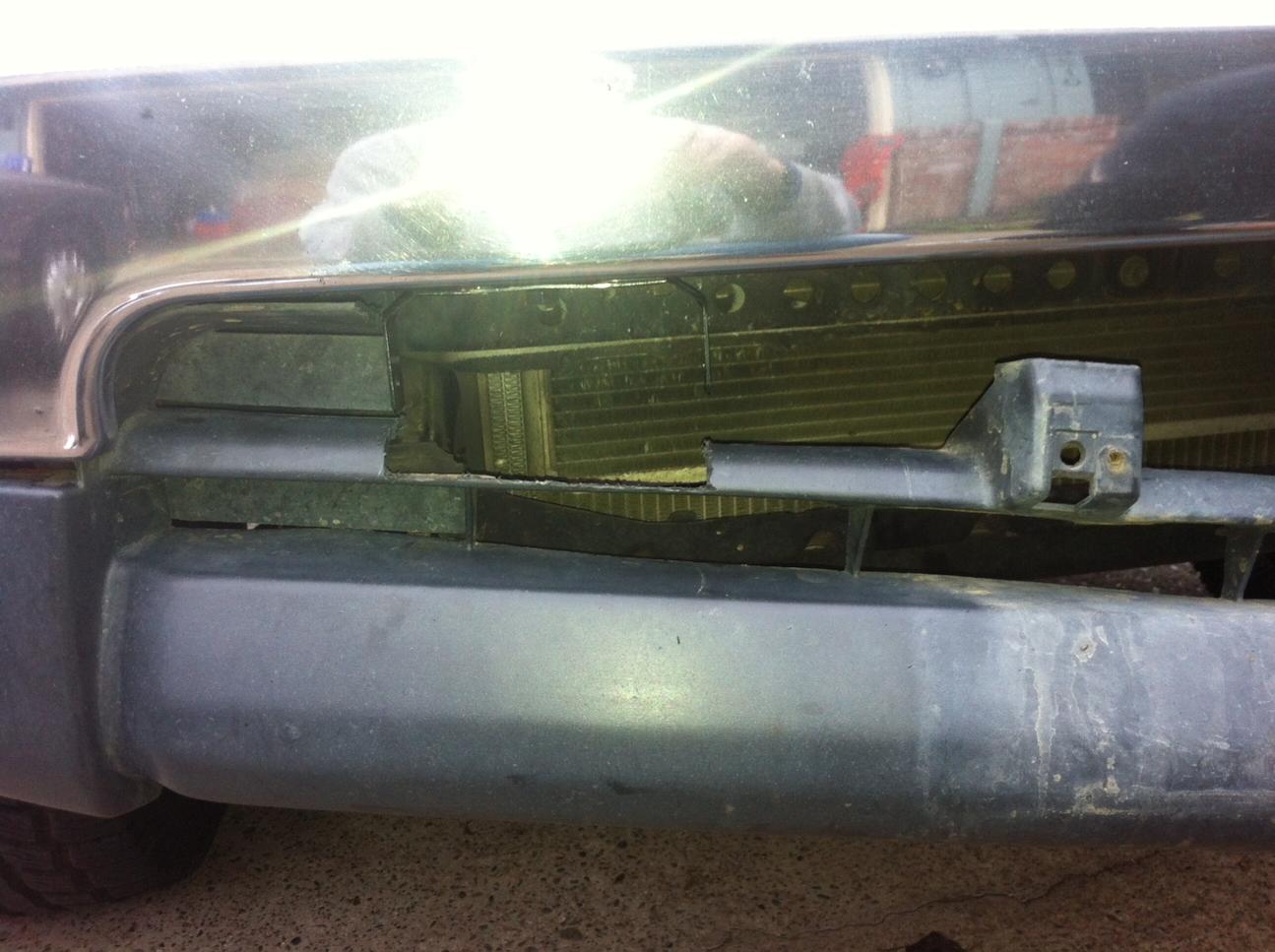

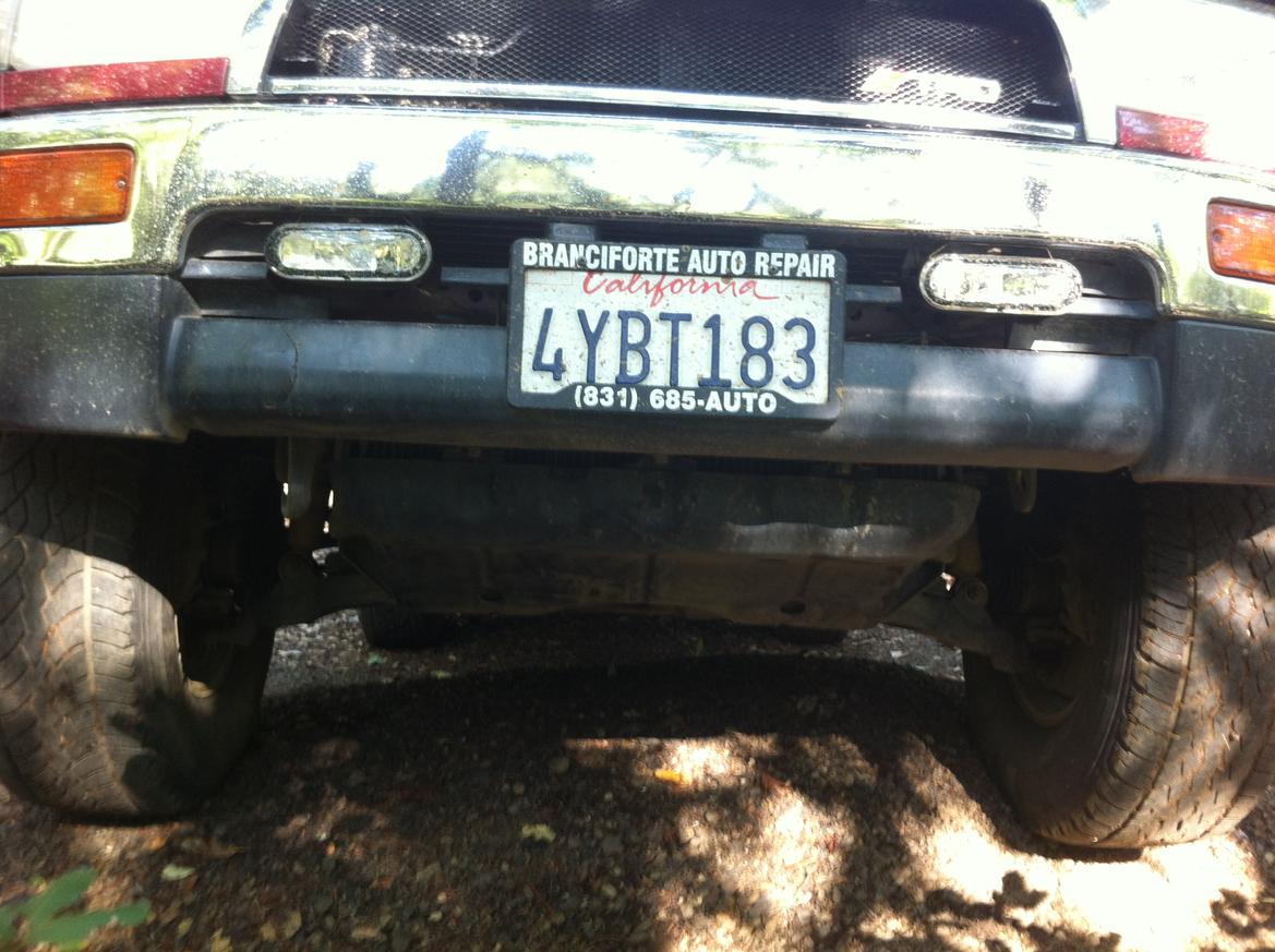

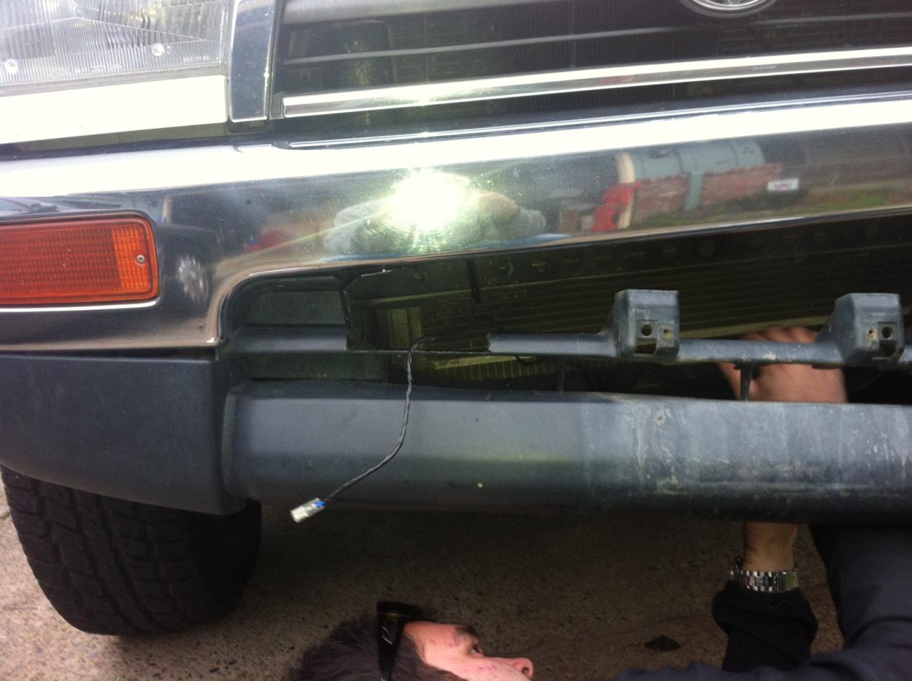

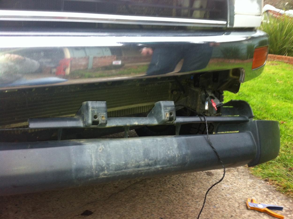

Santa Cruz Runner, you inspired me! I went to AutoZone and found the same lights for $25. Installed them on my '96 Runner. Had a friend do a pro level job on the wiring, and I did the cutting/drilling. Great choice. Hope they last, and don't get washed out in a heavy rain. Thanks for the idea and the great photos. Also had my friend install a Bazooka 6" subwoofer to go w/ my new Pioneer HU and speakers. Now I'll be rockin out and seeing where I'm going on those long night drives.
The only info that looks like Auto Zone inventory info is from the receipt, which says it's #021421. The Pilot model # is PL-820C on the box. Hope that helps.
