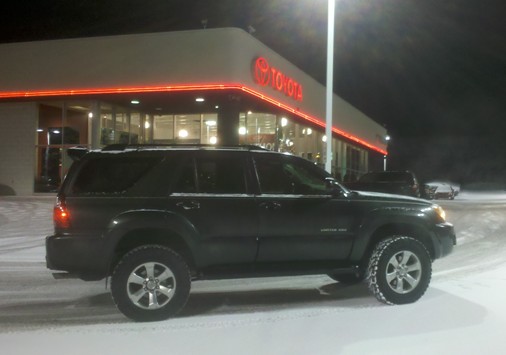

Since Jack Frost decided to paint my landscape with snow and freezing temperatures, I was forced into just adding to the profits of my local Toyota dealership and have them install everything for me. I took advantage of their tire sale and got my 4th GY Duratrac for a buck and had them order the tires for me. I went bigger than factory, so I knew I would have to have the lift installed before I got the tires. I ran out of time and good weather to install the coils myself. So, I dropped her off this morning and already have the call that she is ready to be picked up. I am really nervous and excited at the same time.
I had ordered the coils, as well as the transmission drop kit and the sway bar offset, and threw them in the back of the 4R this morning on my way to work. When I dropped of the 4R I was going to ask how much it would be to install the drop kit and offset, but the young guy was making me nervous so I let it go and didn't mention it. Apparently he didn't know what XREAS was and that the rear wheels have coils. :wow: At this point I probably should have left, but I realize the guy you drop your car off with is not the actual mechanic. I had more faith in shop I guess. Anyway, I had the box with the drop kit and offset in the trunk next to the boxes holding the coils. So when I got the call, he told me the coils, transmission drop kit, sway bar offset, and tires were installed and ready to be picked up. When he told me the price, I was actually thankful they saw the box and installed it all. I didn't mind paying extra to get that out of the way.
Now I am just nervous and hope it all ends up well. I'll keep my fingers crossed and find out in a couple more hours.
Okay, picked my 4R up last night and I am very happy.
Thank you again everyone for taking the time to answer my questions, or offer up opinions. I do appreciate it.
It looks great I like it. I am also a believer that there is no point in ditching the xreas system if there is nothing wrong with it. Do you have any before/after measurements or overall lift amounts using that kit?
