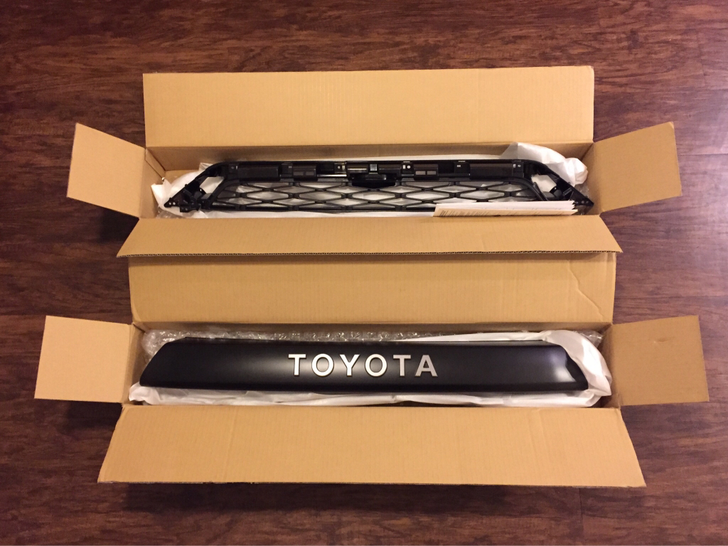

What's the price on the 2 peices? And what's the best place to buy it?
I find the best pricing is typically from https://toyotaparts.mcgeorgetoyota.com/ (fka toyotaonlineparts.com) for any Toyota parts.
You might be able to have your local dealership price match, but I know my local dealership won't price match online retailers :mad:
PZ32335056 - TRD Bumper Garnish
List: $567.64
toyotaonlineparts.com: $375.04
PZ32735053 - TRD Grill
List: $239.00
toyotaonlineparts.com: $157.92
Is this bracket necessary for the grill swap trdparts4u is saying it is.
BRACKET RADIATOR GRI - TOYOTA (PZ327-35701)
This is to put on a Trail Premium
Thanks
No one answered this question, and I was wondering the same thing. Like he says, trdparts4u says it's necessary, but it doesn't seem like it from the posts here.
We definitely only need PZ323-35056 and PZ327-35053?
Thanks!
Thanks!
the radiator bracket is not necessary. You will be removing that piece from your existing assembly and re-using it.
You do only need the 2 parts you mentioned above.
regards,
-Rob
regards,
-Rob
Awesome. Thanks a bunch

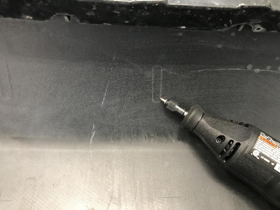

I Installed the front lower valance finally this weekend. Took me 1 hour 15 min to install and put everything back together. Very easy mod to do and looks great IMO. I didnt have time to start the rear valance so my goal is to get that done next weekend.
One of the pics below shows the indentations or marker locations on where you need to cut the slots.
Another shows the edge of the bumper and how it just clips/snaps into place. Very easy to remove.
my valance should be arriving this weekend. how did i mark the holes that need to be cut in the sr5 bumper? looks like u got them marked up perfectly. i am worrying about that currently.
Looks good!
I will be adding the Trail valance to my SR5 in the near future. How did you go about locating the holes in the correct places on your bumper? And what sort of bit is that on the Dremel?
Oh wait! Are the slot locations already marked on the inside of the bumper?
did you figure out if the slots are on the inside of the bumper?!? if so this should be an easyyyy mod.
I don’t remember where do but recall seeing a photo that showed the rectangular markings. I’ve had front and rear trail valances for months but never the time or extra set of hands to take on this fun little project. Sh*t, I have 6112/5160s and rear springs to install, too! Life’s obligations just getting’ in the way. :rolleyes:
Oh - the photo referenced is this.
http://www.toyota-4runner.org/attac...g-trd-pro-bumper-trim-pieces-sr5-img_2524.jpg
well i'll be installing mine this weekend. ill take pics and let you know how it goes haha.
