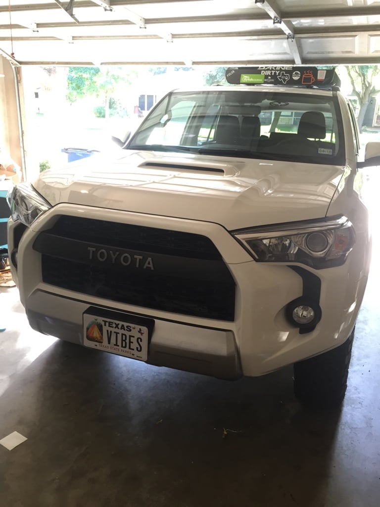

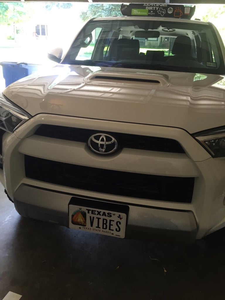

Replaced both the front and rear silver valance pieces with the black TRD ones. Probably took me an hour and a half. I tried the PlastiDip option and did really well on the front one but just wasn't doing well with the rear one for some reason so I just spent the money for new ones. I also used PlastiDip on the logos which turned out nice.

As Far as the front and rear trim pieces go, you'd have to drill out holes and have the retaining clips and fasteners to make it work. The TRD Pro like the Trail have front and rear trim pieces that are clip in. IMO I'd send those pieces back get your $$ back and you could do what I did which is either get those areas vinyl wrapped, Plastidip them or even Line - X to give them the look of the trail or TRD Pro. Or if you could find someone with a Trail front bumper and rear you could do a swap with, but that's a lot more work than it needs to be IMO. I say send back and plastidip or vinyl wrap

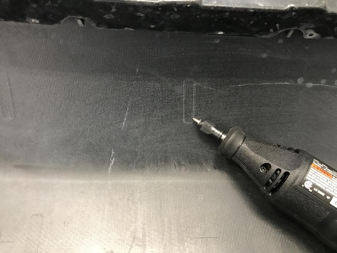

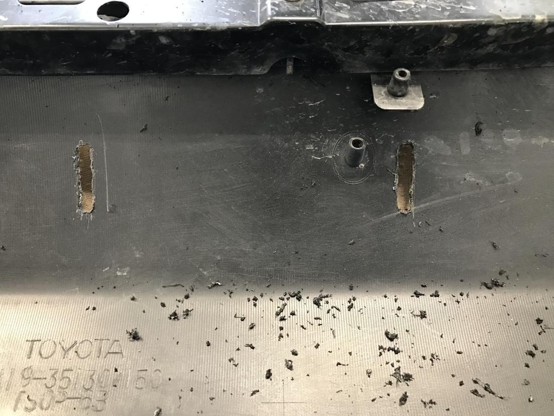

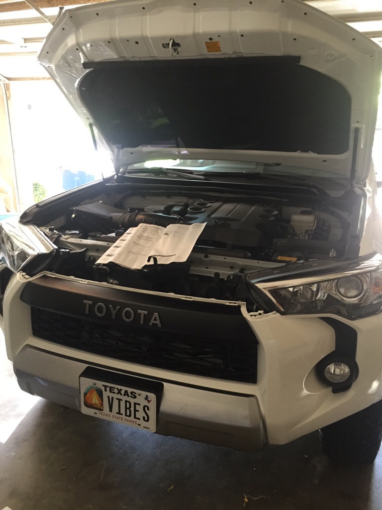

I just added the front black trd pro valance. I took the bumper off did the holes my self with a dremel. Not hard at all and clip on right way.

I will be adding the Trail valance to my SR5 in the near future. How did you go about locating the holes in the correct places on your bumper? And what sort of bit is that on the Dremel?
Oh wait! Are the slot locations already marked on the inside of the bumper?
