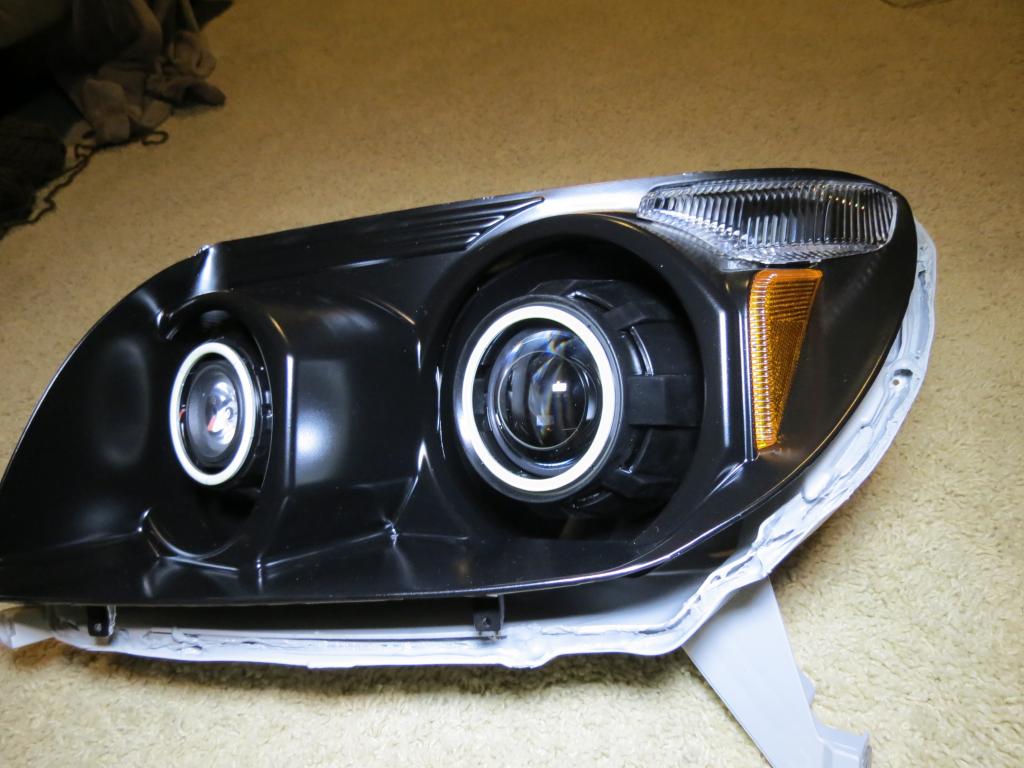

instead of a projector retro ..i was thinking of doing this.....

Once I get some spare monies, I'm going to have to build myself some headlights like these. The Squadron Pro's in there look awesome.
I used the Cree G8 led bulbs from The retro fit source for the low beams. There awesome! Retrofitted Baja Design Squadron Pros spots for high beams. And morimoto switch back halos.

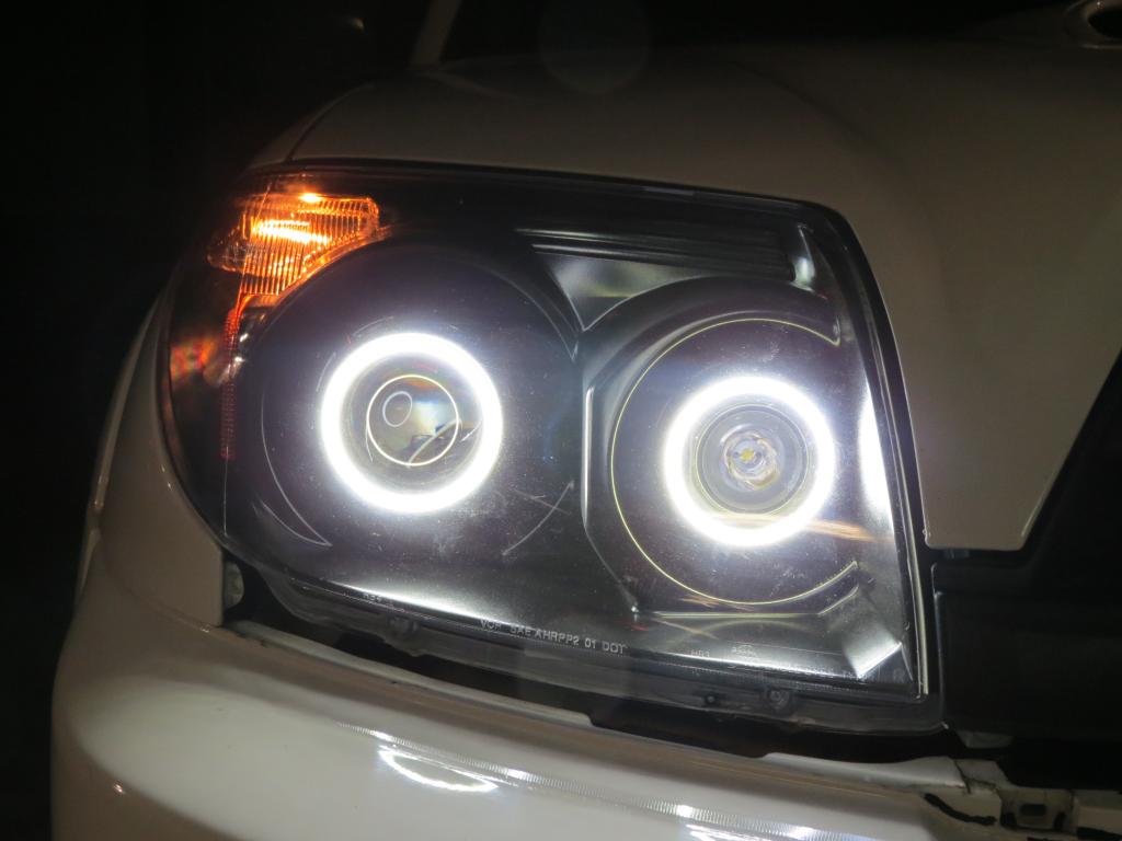

D2S 4.0's with XB 5500k bulbs , 100MM Morimoto XB switchback halos and Baja Designs Squadron Racer edition spots throwing flames. :flamethrwoer2:
I'm waiting for the release of the VLED Triton v6 to replace my DRL/turn signal bulb to use in conjunction with the halo's.

2) the passenger mounting bracket that I made is slightly crooked and I know [MENTION=5149]riceandpho[/MENTION] will tear me a new one for posting imperfect retrofits :jump::sorry:
I also realize the halos are not perfectly centered and I don't care if the gash (from the grinder) to the right of the projector is visible under the halo, but this was not the easiest of mods and I'm stoked to finally have it completed.
My previous lights were the D2S 2.0 with 4500k bulbs. The 2.0's were a huge upgrade from stock, but these blow them out of the water. Definitely worth the hours it took to build.

you can still fix it by file-ling the screw holes and make it rotatable. its good you use the new stuff, man if you did the oem d2s bulbs, itll blow those out the water too.

I was poking fun at ya. I've always respected the knowledge you have on retro's and appreciate the feedback.
The OEM bulbs are better than the morimoto's? Can you post a link or give me more info? I haven't heard/read anything about this before.
